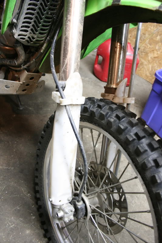

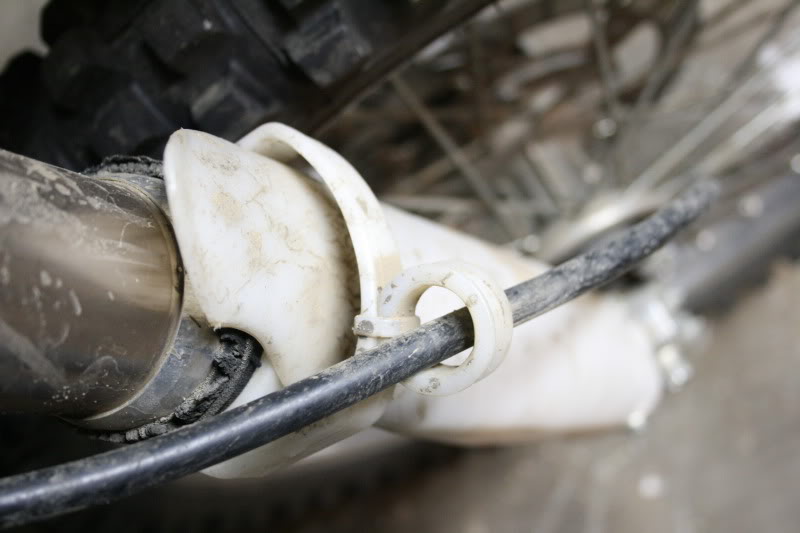

I sanded a flat on the stock spedo cable guide and then zip tied it to the top of the fork slider. Worked very well, in fact I haven't looked at it until I just went out and took these extra shots. It has turned a bit to match the angle of the cable but still solid.
