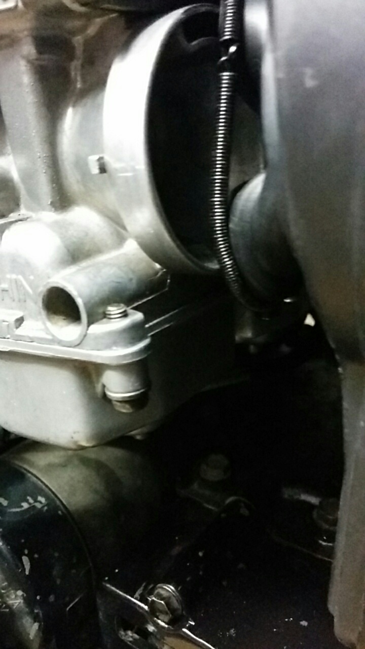

I have the same problem. I cleaned carbs and jets and added a large filter because of dirt / dust /mud in float bowls. But I did find a partial solution. I just peel back the #1 carb rubber into the airbox and it revs to 11k. 13k? is over redline is it not?
Yes I am using a lot of gas too. Also if I hold my hand over the carb mouth it will spit back gas so suspect that the carb is blocked. Manual suggest buying a new carb. The internal very small passages that can not be cleaned without major work like drilling an access hole might be a solution but I am not that desperate yet.
Also check your diaphrams for holes in the rubbers
Attached Thumbnails Engine bogs down when rolling on the throttle-ninja-carb-rubber-mod.jpg
