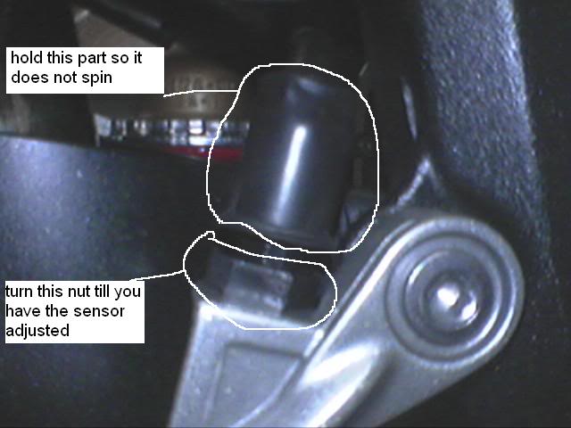

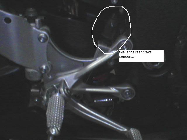

well i took some pics to help you with adjusting the rear brake sensor

also i think that you turn the nut counter-clockwise to make the brake light turn on with less pedel travel and clockwise to turn on with more pedel travel.....if that makes sense
