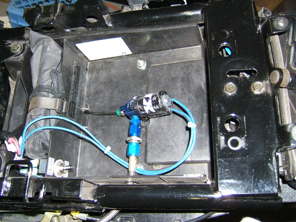

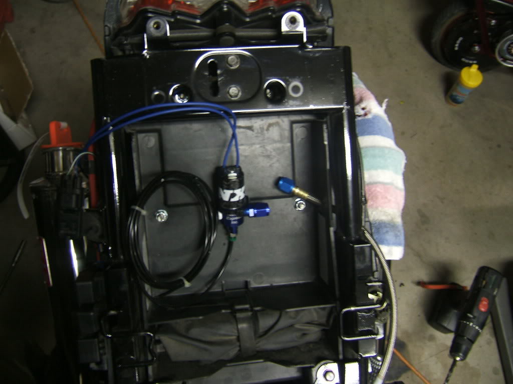

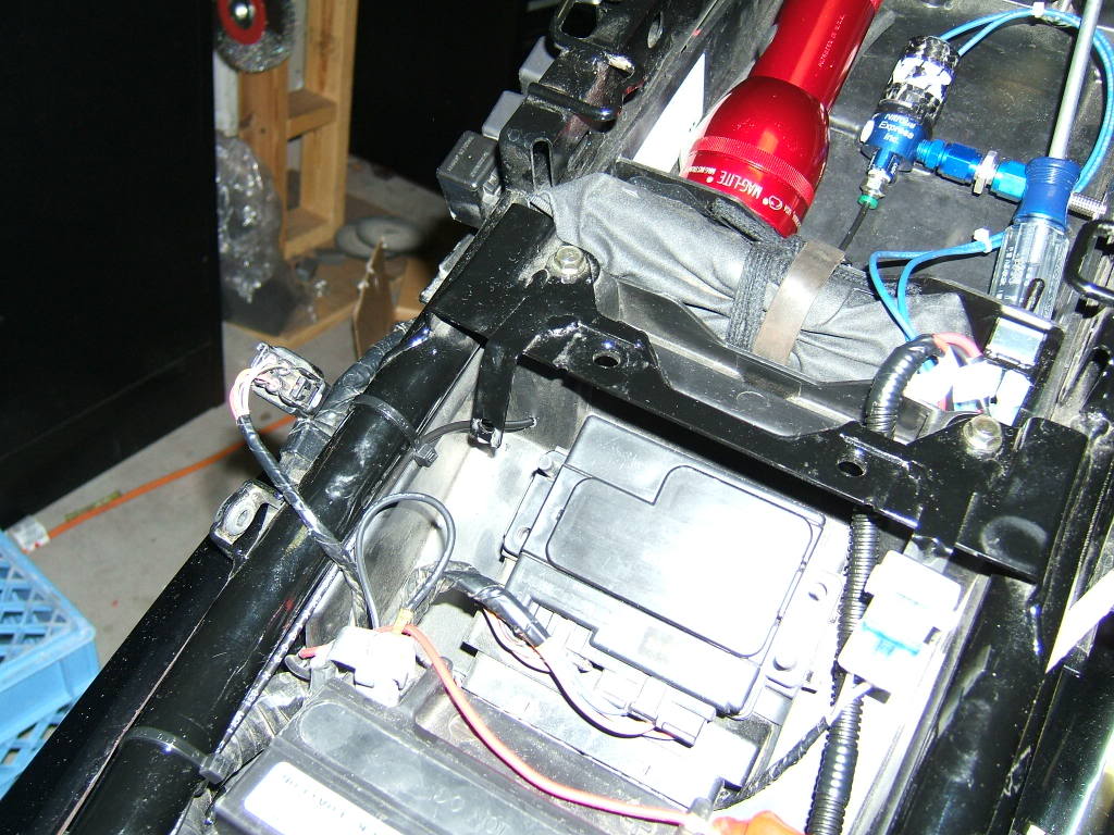

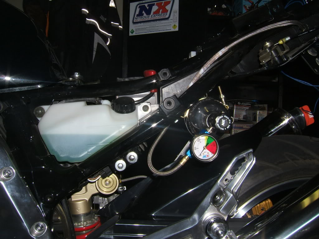

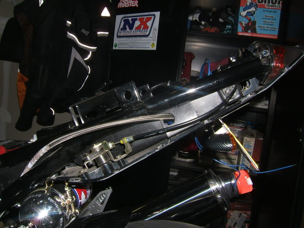

Still experimenting with the wiring route to go, but I did get the gauge installed and also picked up a 2' steel -4 line.
Had to bore a hole big enough for the b-nut on the line to fit into the trunk.

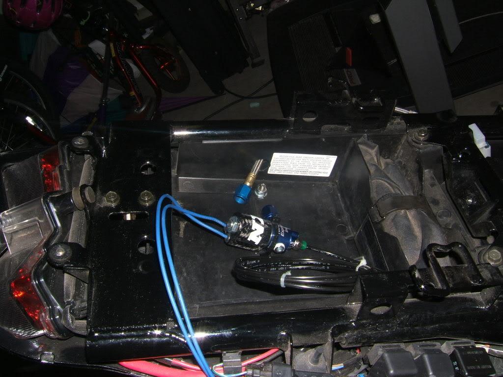

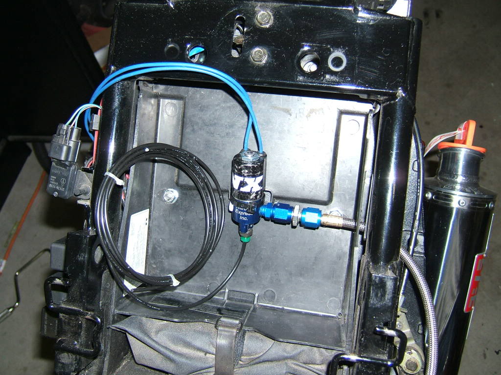

Zip-tied the solenoid down in the trunk. All I need now is a -4 union to connect the steel line to the solenoid now. We'll pick one up tomorrow.
Next step is to route the plastic line to the airbox. I'm going to drill the hole in the top of the airbox just big enough to fit the hose in, then epoxy it in there. Once my electrical engineer buddy gets a wiring schematic drawn up, we'll press on with the wiring.

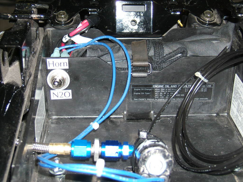

-4 union now connected and the plumbing is fully tied in:

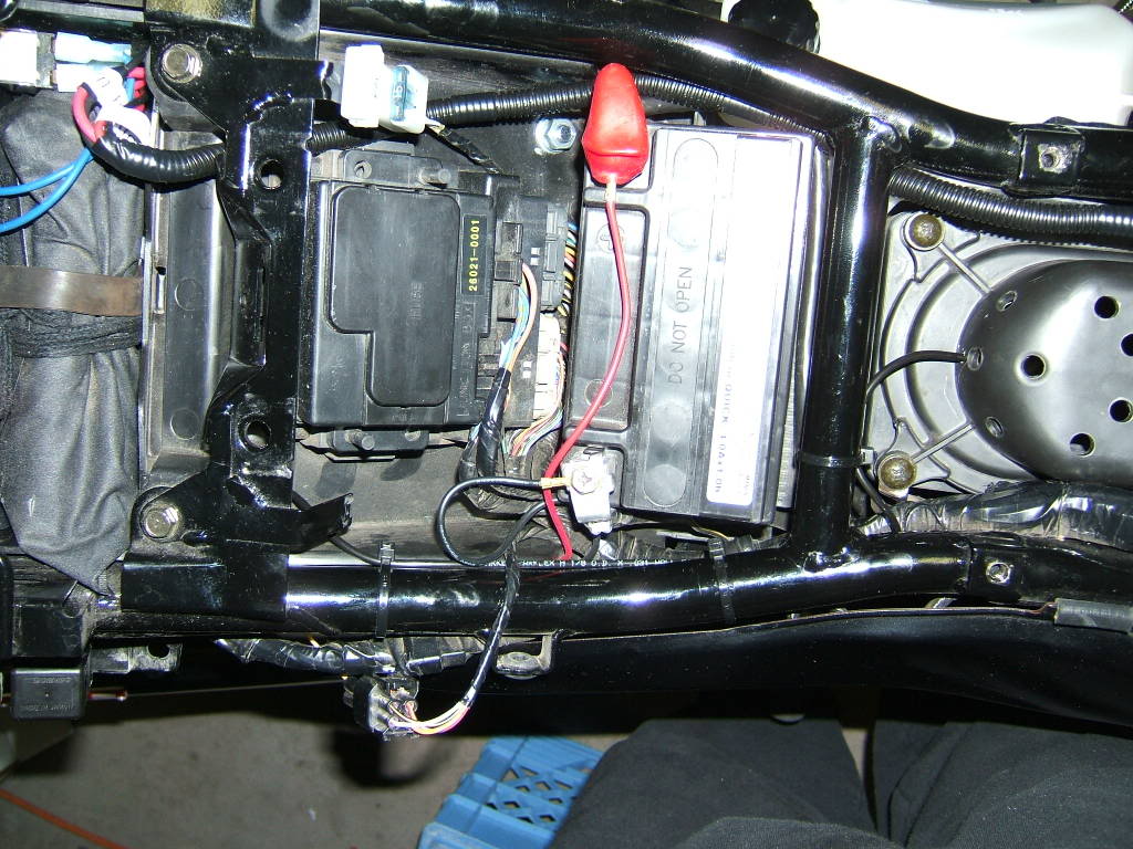

Switch is installed in the trunk, and labeled so I know which side is what:

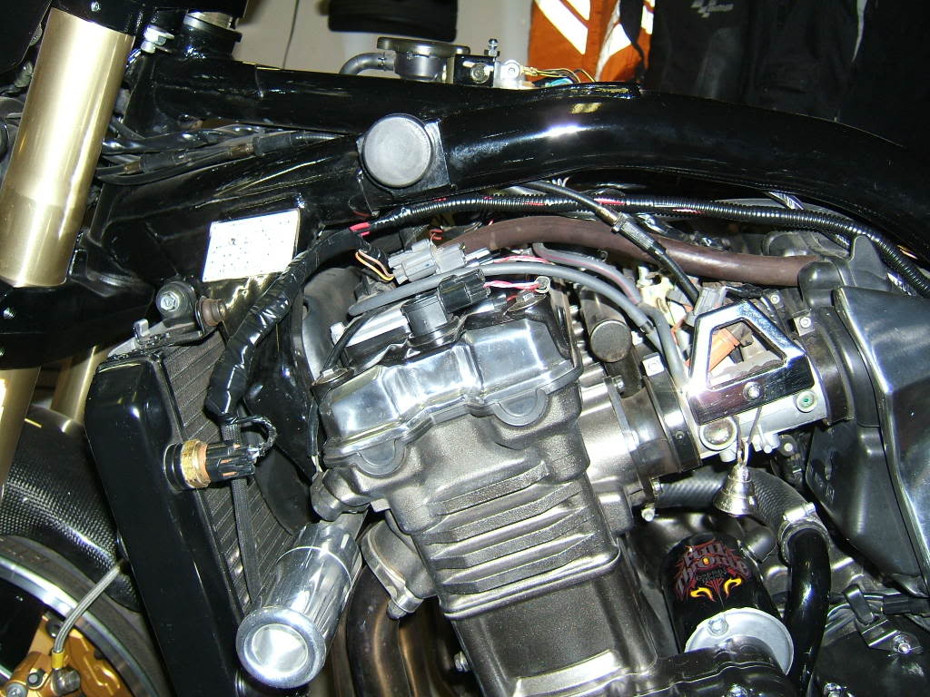

If you start at the back of the switch, you'll see the route I used with the wiring & conduit running towards the front of the bike to the horn wiring:
Black conduit on top of the motor contains the wiring to the horn switch, tied in with connectors and taped up for cleanliness:

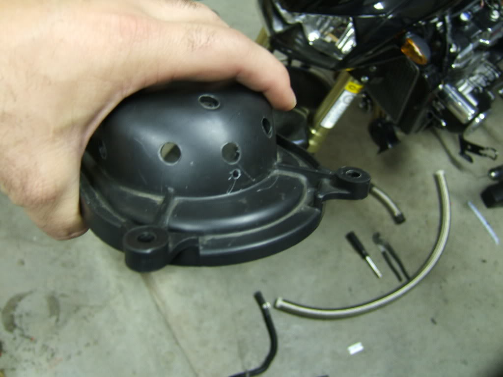

Small hole bored in airbox lid for the N20 line:

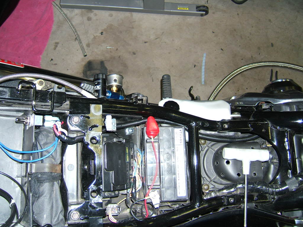

N20 line runs along the frame rail in the bottom of this photo to the airbox lid:

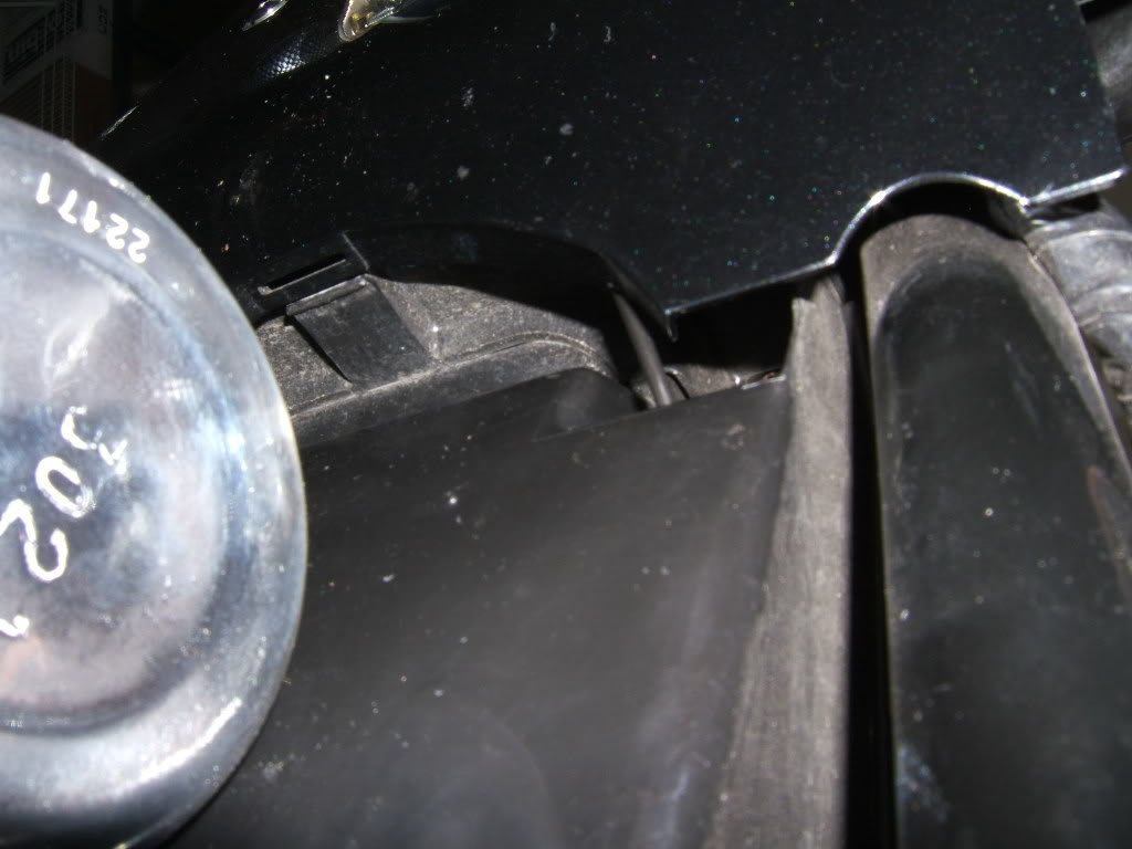

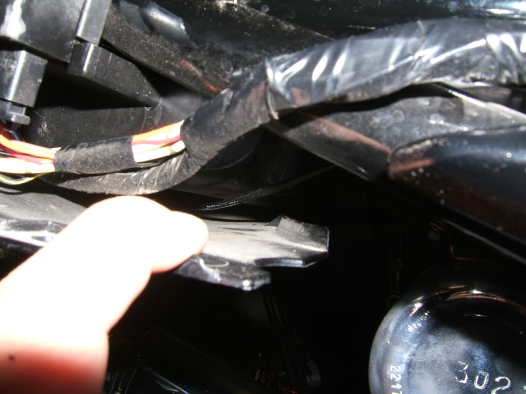

Ran the N20 line out the trunk through an existing hole:
....under the bodywork and drilled another small hole for it to run through:
Here you can see the line under the bodywork:
