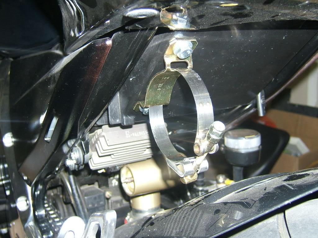

Finally got my kit in the mail this week. I still have to do the wiring n' such, but at least I made some headway today.

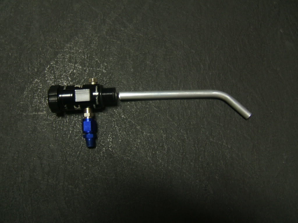

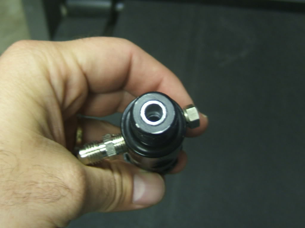

I did as I was told by the Tech Rep at NX and cut the siphon tube off the bottle valve. We'll see how that pans out...

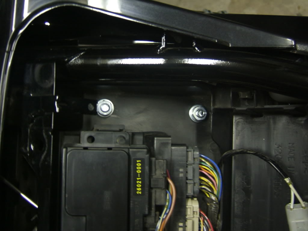

...then I mounted the bracket right under the PCM, above the rear fender:

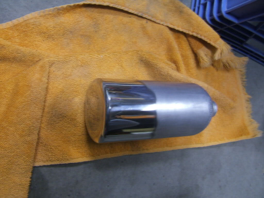

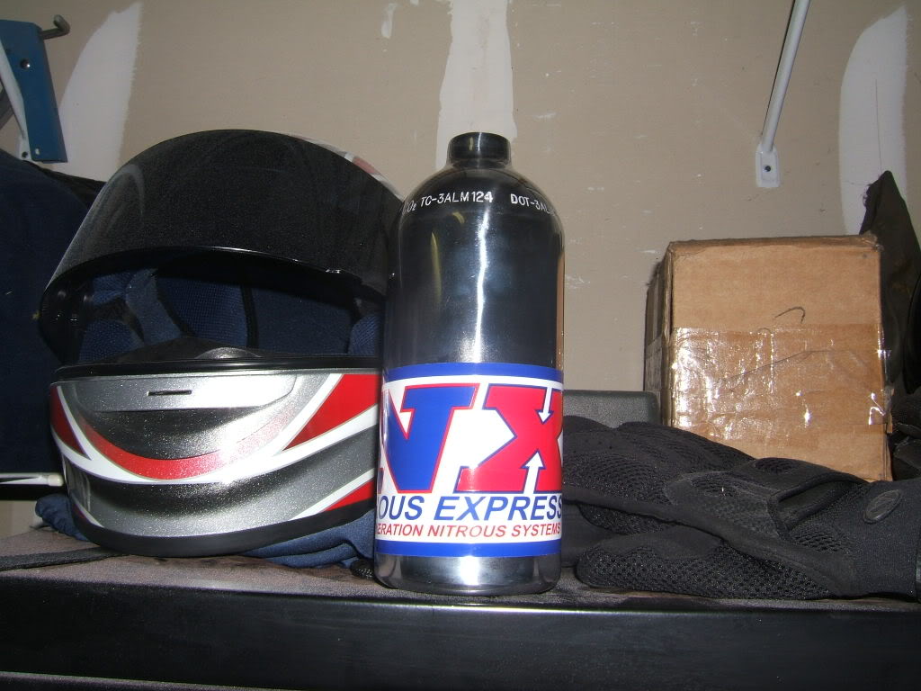

....and here's what I spent 5 hours on today. Getting the white powdercoat off that bottle sucked!

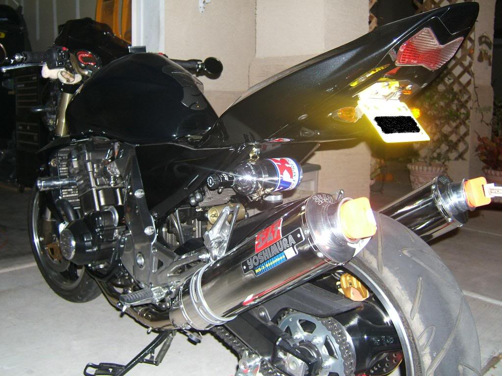

....and here's what it looks like mounted up:

Looks nice! The rear tire will not smack the bottle in that location? Just seems kinda close from the pic.
Old Nov 11, 2007 | 04:53 AM
Compstall's Avatar
Joined: Nov 2007
Posts: 41
Default RE: N20 install
I checked that before putting it there (me on the bike). I've got ~1.5 - 2" of clearance between the bottle and the fender.

Hey not to bust your bubble but cutting the siphon tube off hurt you more then helped. The only way that will hlp is if bottle is mounted upside down. I have a 2000 ZX9r with dual stage NOS and a total of 4 two pound bottles. If you have question hit me up. I have been runing dry and wet NOS system in all my bikes.
