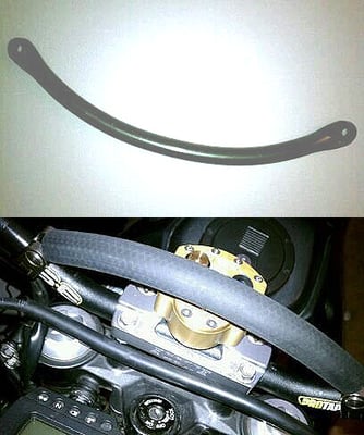

got tired of buying and returning handguards because the mounts would not fit...i just gave up....i have a pro taper seven eighths "se" carmichael bend with a custom "bow" crossbar....i welcome any recommendations for a handguard that can work on my handlebar...

^ whats that a stabilizer?

yes...a stabilizer...scotts performance steering damper...do a lot of long high-speed freeway/highway rides on poorly paved roads (they finally recently started repaving the highways)....after a few tank slappers, decided to have the suspension professional adjusted and put on a stabilizer...haven't had even a slight freeway wiggle ever since....

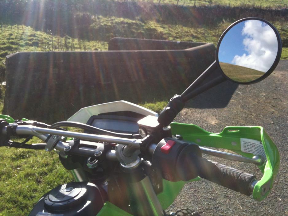

Couple of snaps of Acerbis guards on my bike. I drilled and tapped the bar ends, suprisingly easy to do ~ the bar ends are fairly soft alloy. I spaced the guards off the bars a touch to clear the lever ends, saved having to cut the ***** of the levers. A bit of re-routing with cables and wires job done. The Acerbis colour match is spot on.
The mirror is on the right hand side as being in England we drive on the correct side of the road rather than the right
