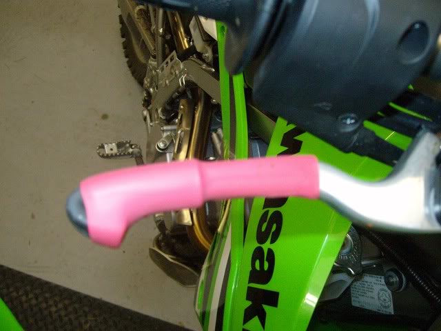

Originally Posted by ns503
What's that on the end of your lever?
Heat shrink to cover the lever ends when I cut them off.

Old Apr 19, 2011 | 11:23 PM
ns503's Avatar
Joined: Jun 2010
Posts: 195
From: Nova Scotia Toolies
So at the very end, is the end of the lever actually bent around - then the heat shrink over that? Is that what I'm seeing?
I think I have about decided to just take my levers to my machinist/welding buddy, and get him to cut the ***** off, cut an inch out, and weld the ***** back on. Maybe I should throw some heat shrink over that. I like shorty levers, and the guards I got but haven't put on yet don't quite have room for stock levers - fancy new levers aren't in my budget...
No I just hacksawed the lever off and put a fairly thick heatshrink on and folded it forward and another layer of the red heatshrink over the fold so that it cradles my first two fingers, a custom fit to my hands. I love em.
