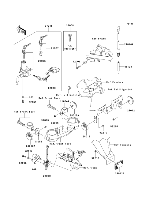

Hey Nick welcome to the forums. Now you're not the guy that stole someone else's bike and now you're trying to get us to help you are you? Just messing. I didn't see what year your bike is, but if its an 06 or 07 this is the way the lock comes off.
06
09
If its an 09 then this is the way, they look the same I think. Either way, I think you're going to have to take off the triple clamp and the gauge cluster and fold it forward.

It is a 2009 model, and I don't want to by-pass the switch, I want to replace the whole thing.
Looking at the images it appears the ignition/lock assembly is normally mounted with 2 torx bolts. Can these be removed easily? or will they have to be drilled out?

i feel your pain, some one had an attempt on my bike, i had to use an easy out with mine because they snapped my bolt heads. very easy if they haven't, you can tell if you wiggle you lock, if it is tight, then probs they haven't been snapped. 2 bolts hold it in place, should come out easily. you can buy a new lock and key from a kawasaki dealer, between $70-100 bucks.
give it ago, if you can fix it, put it back together and get a kawa to do it
