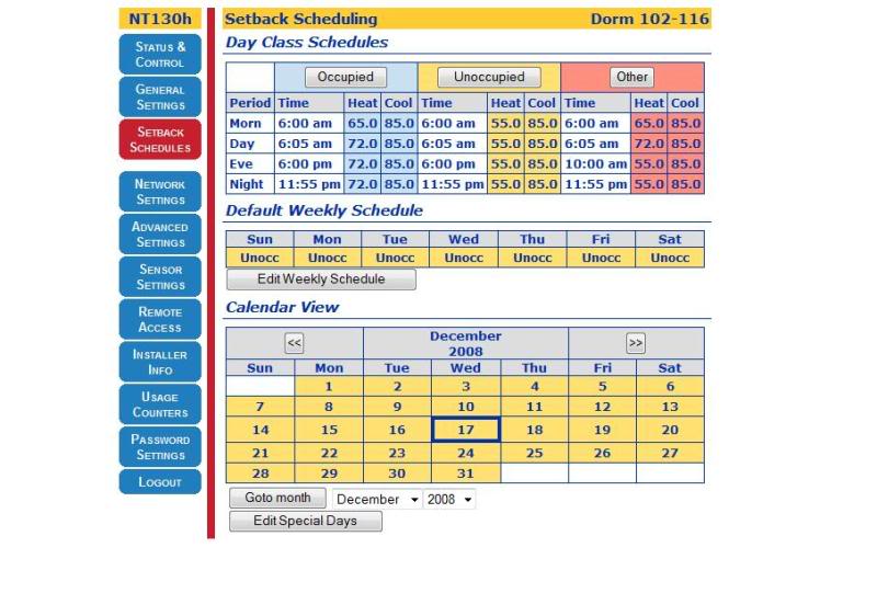

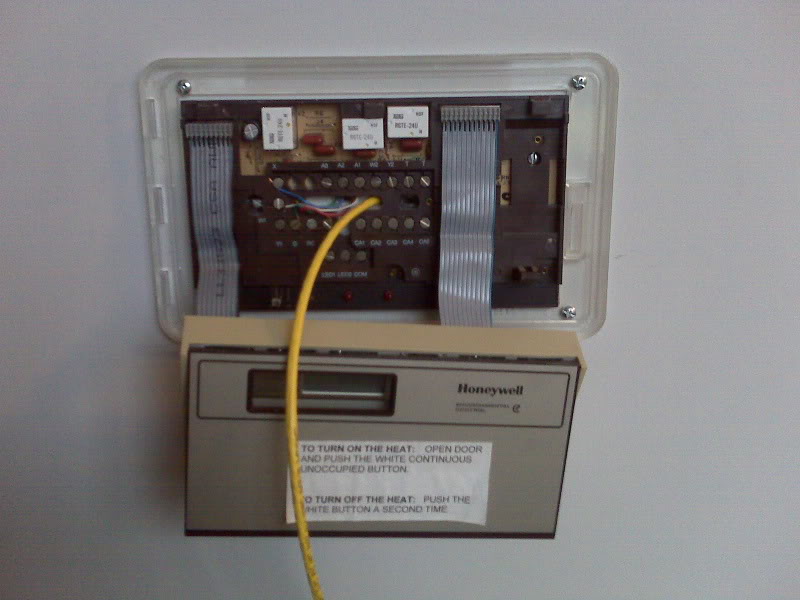

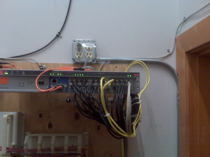

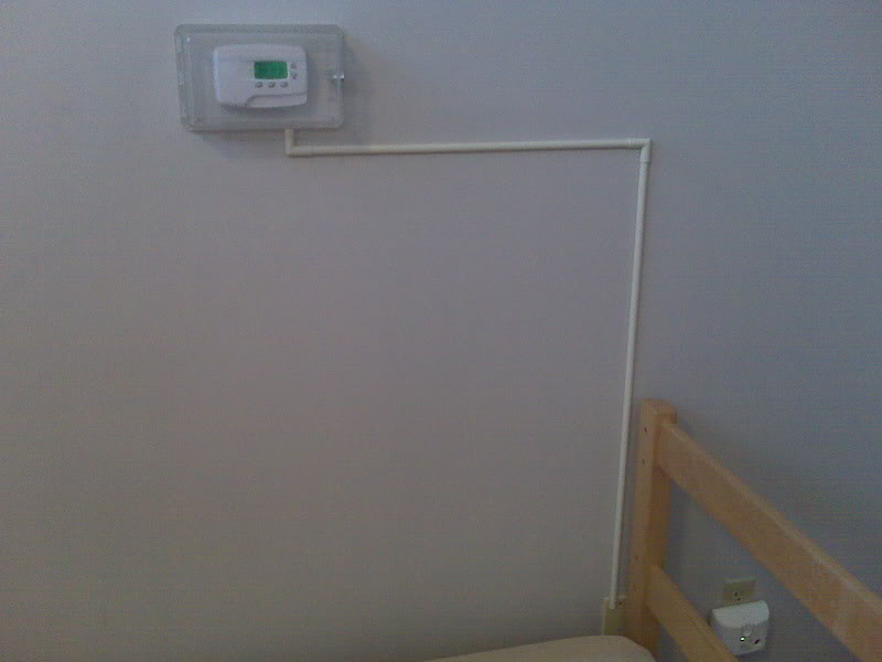

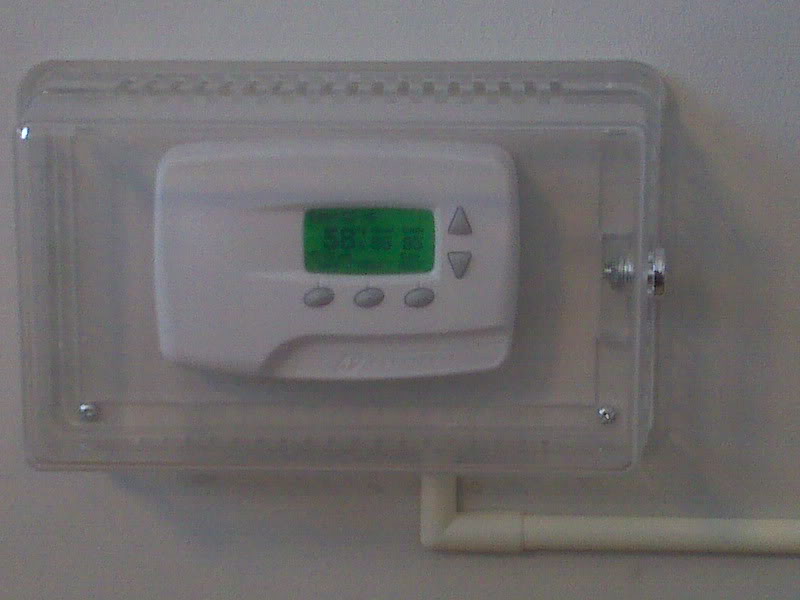

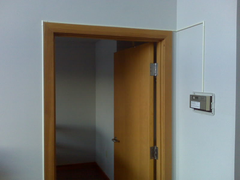

UPDATE!! Here is a screenshot of the first schedule. I got the OK to order two more for the apartments. I already ran the Cat 5 Cable to just behind the current thermostats. Conduit went from the rooms right to the switch in the mechanical room for that building. How easy was that?
Waiting for the new stat
