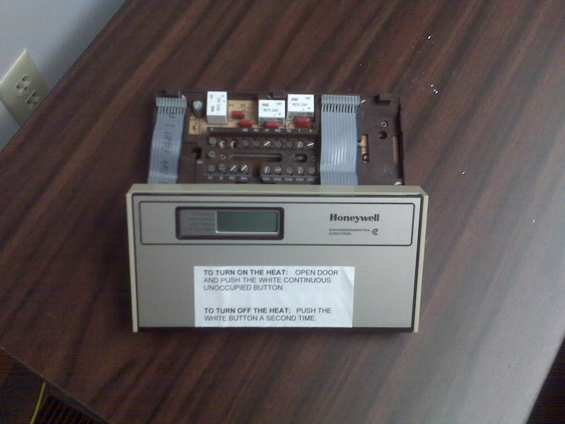

Here is the old thermostat, Honeywell T7300

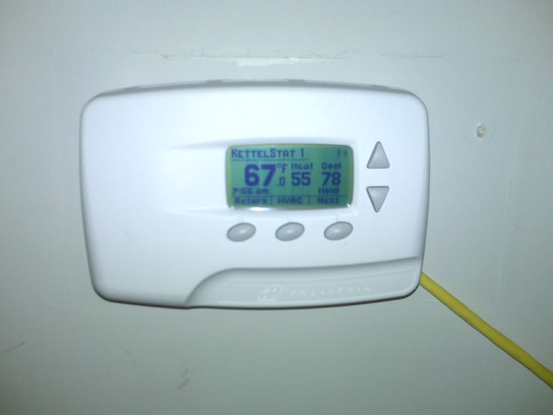

The new Ethernet Proliphix NT 130H

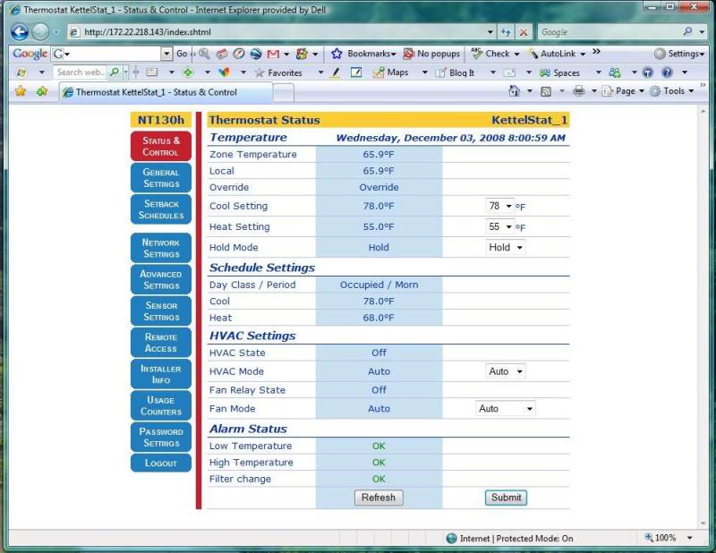

Here's the interface that I can do all kinds of stuff in.

Actually it solves a lot of waste and other problems.
Example #1 Someone is checking in on a Friday, but I'm off all week. I schedule it to come on the day they get here and off the day they leave. That way it doesn't run early and I don't forget to run up and turn it off.
Example # 2 I can now monitor the temps in the apartments and Dorms from my computer (ok that does sound lazy) but it allows me to keep in touch with what the buildings are doing heat wise.
Example # 3 We have people using the facility on weekends and holidays all the tme, right now we have to leave the heat running a day or two before they get here and sometimes up to a week before I can get back there to turn it off. The scheduler will save us enough money in propane not used to pay for the 3 thermostats in just a few months. Currently our 20,000 sqft facility propane is costing between $1500-$2000 a month.
I can't change the mechanical system, although I would love to retrofit cadet heaters in all the rooms, but that's not in the cards right now with the state budgets in serious trouble.
Using my Outlook Calendar along with the scheduler on this thermostat will yes save me time, but more importantly let me take control of something that has been an issue up here from day one.
