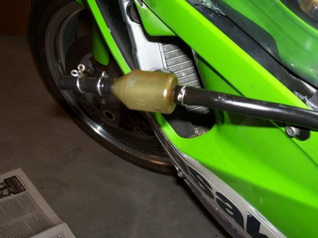

Not sure what this is, but should it be conected to anything? There was a bunch of oil at the end.

Old Jun 23, 2007 | 04:05 AM
Default RE: First Ride
It has a clip on the end of the hose, so would say it connected to something. Looks like an oil vapor emissions thing. I am not sure what that is.
That looks like the moisture/water overflow coming out of my airbox... has a one-way filter/valve on it just like that so crap cant wash up into the airbox... where is the line coming from?
What year is your 7? I might have a shop manual for it and can take a look...

It's a 91.Itlooks to go under behind the frame up to about where the tank ends. Looking in the book it looks lke part of the evap system from a 96-on california model. The neighbor saw it and asked what it was. He knows a little about bikes too.
