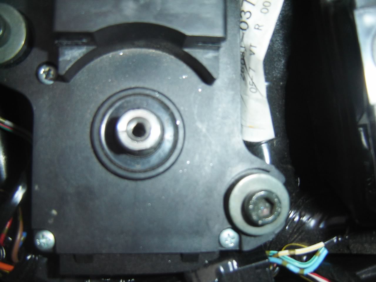

Ok sorry it took so long I was out of town here is the how ther servo is set from the factory with the key off...after already turning it on once for it to reset it's postion

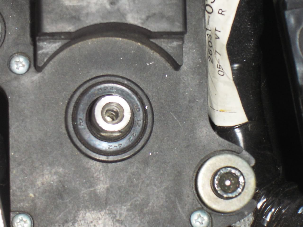

When I turn the key again it rotates 180degrees clockwise and then sets again, here's a pick after it has turned...the bracket won't fuction like this and the FI light stays on does anyone know how I can fix thisName:  exhaustservoset2.jpg

Turn the key on and off quicklyuntil the mark faces away from the cable mount and install the stop. Mine never stopped at the same spot. I had to do it a couple of times.

Yeah I tried that a couple of timestoo speed but it wouldn't work, it would just turn 90degrees and stopI found a new servo on ebay for only 20$shipped like sup_uni did so it should be here in a few days i'll keep u guys posted-thanks guys

Sorry guys been a long time on this one and my computer crashed a couple weeks ago....so here's the update. After getting screwed out of 20 bucks for a new servo on ebay I took the seat off one more time before I was about to order the IVANS, did the same things as before and got it fixed. Here's how I got it, turn the key on and off over and over again untill the the notch on the servo was in the correct position, took the key out, took off the neg. battery cable, intalled the servo stop(tight as hell), reconnected the battery cable after a little cleaning to it, turned the key and whallla no more f'n red light in my face and alot better performance and gas mileage....thanks for all the help guys
