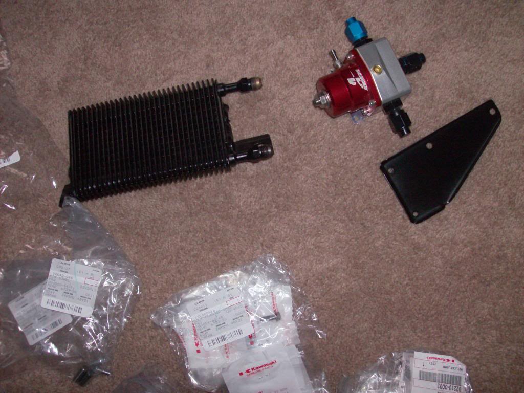

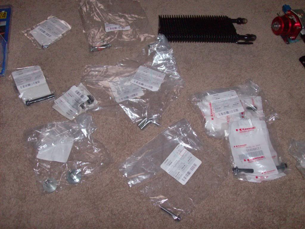

I stopped at Jeg's last night on the way home from work and today I went to my favorite Kawasaki shop. I've got a bunch of stuff to do!
Today's projects:

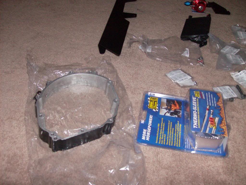

I'll be busy today. Installing the lock up clutch spacer, heat shield for the scavenge pump line, chain guard, FPR & mounting bracket, radiator (it's currently temp installed), oil cooler and quite a few other things! Yaaaaaay!

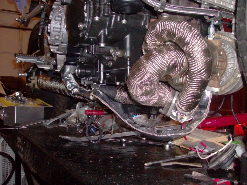

The scavenge line is permanently installed with the thermal shield installed.

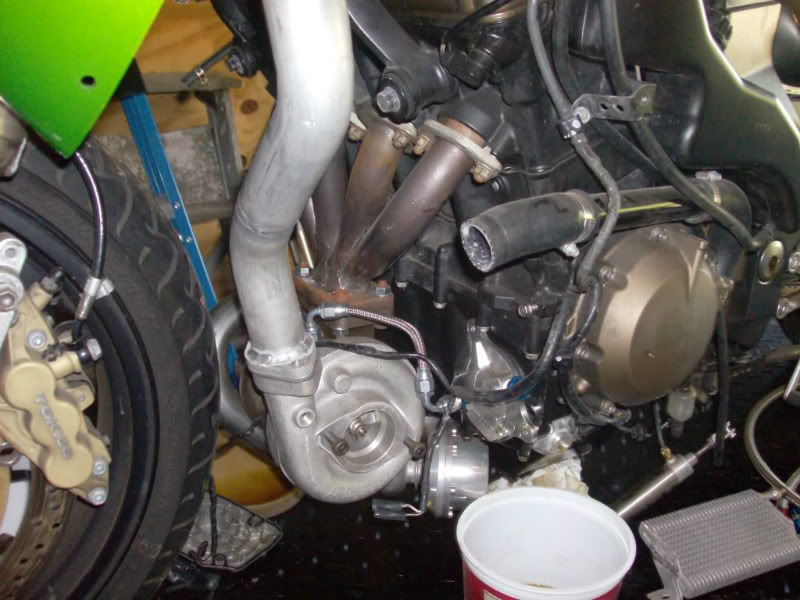

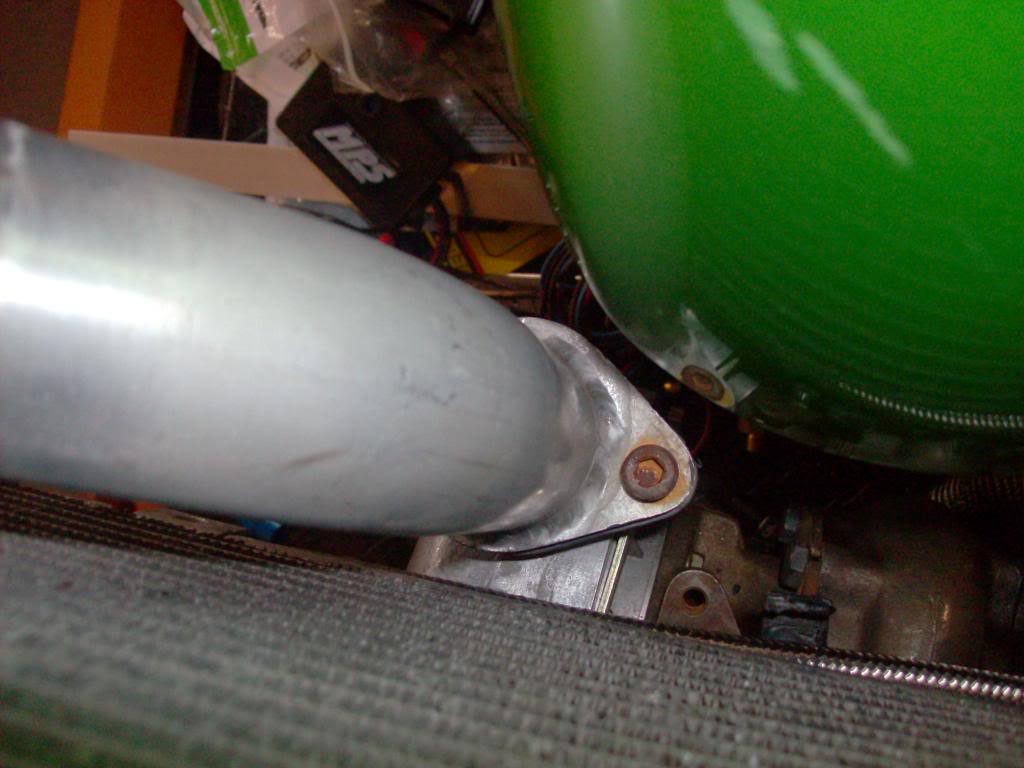

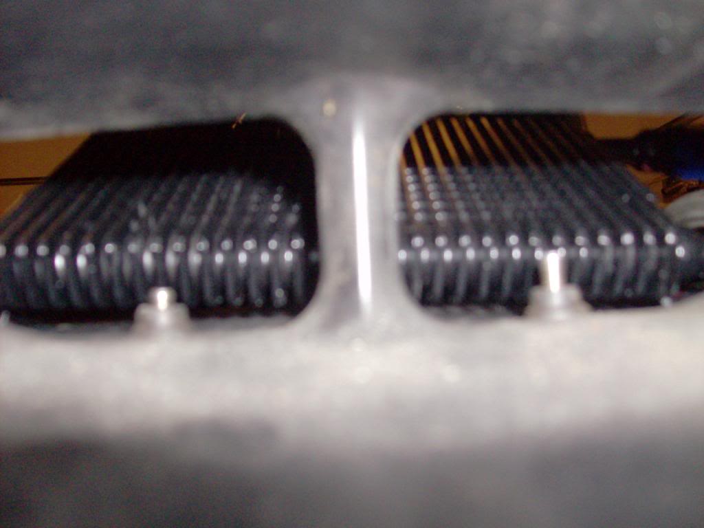

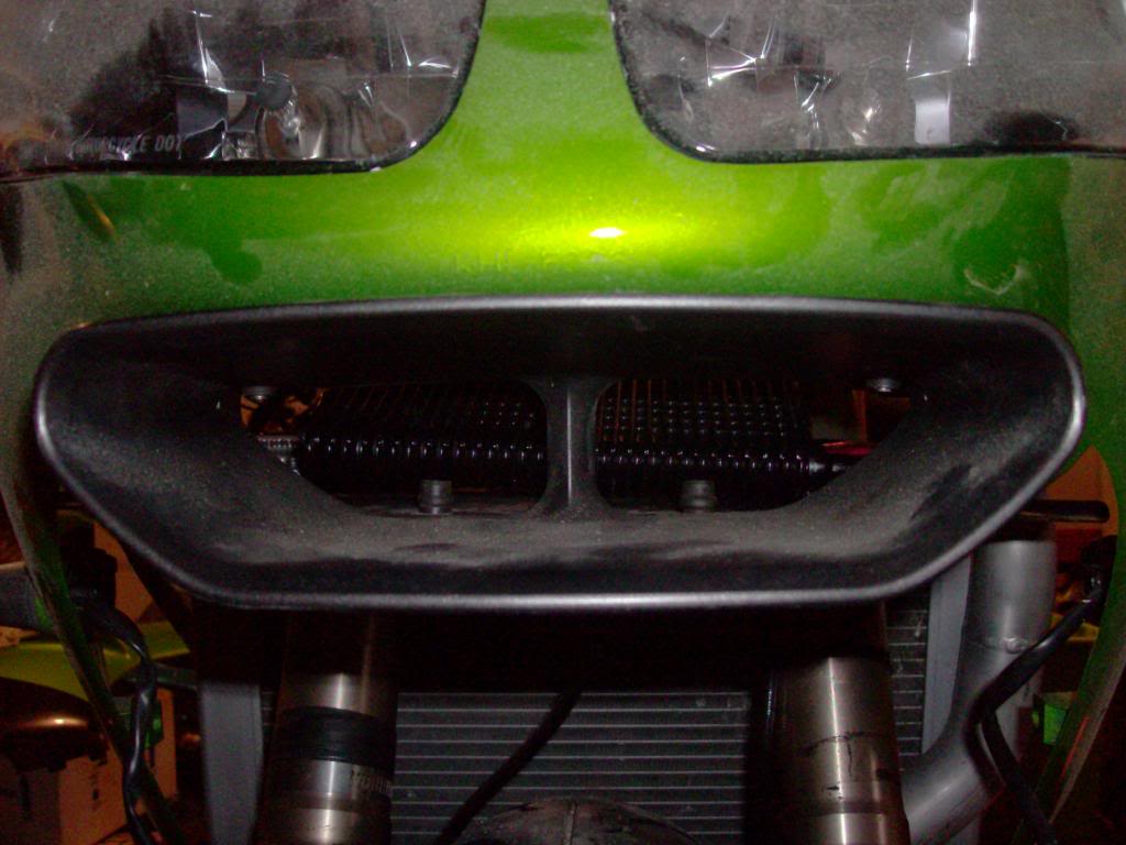

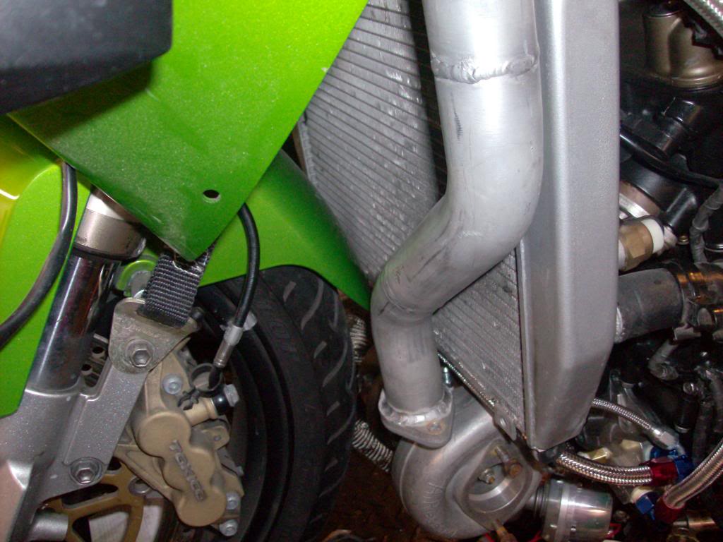

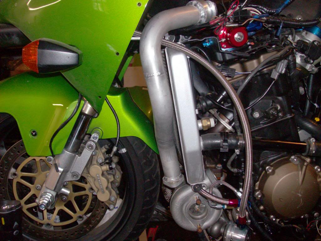

The expected issue is with the turbo piping. I had a different opinion of how to route it but was talked into the way it was routed. Now that I have the front fender on you can clearly see the issue.
I've already selected the parts I need to correct this. Now I wait for the UPS guy.
I'm going to rotate the turbo like it is in the photo and reroute the tubing.

As for the other issue, I'll start tearing into it tomorrow and see where I get with it.
Old Mar 23, 2013 | 01:22 PM
Good plan on the reroute of the tubing. Wouldn't want to see a fall over at speed because of the front wheel getting stuck on the turbo piping.
Get some stainless fasteners to help out on your Rust issues. McMaster-Carr is my friend.

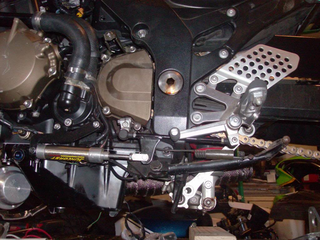

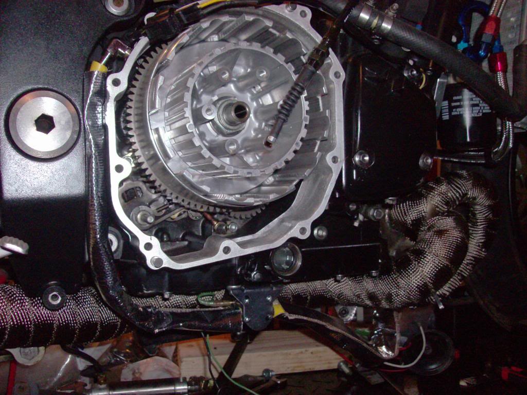

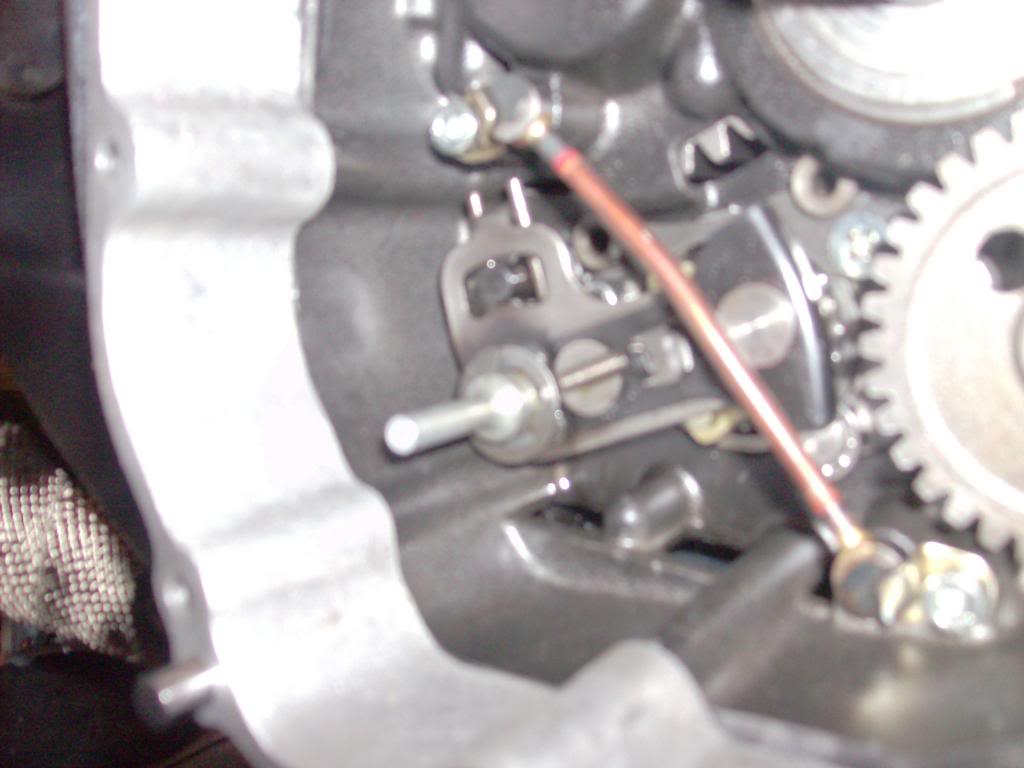

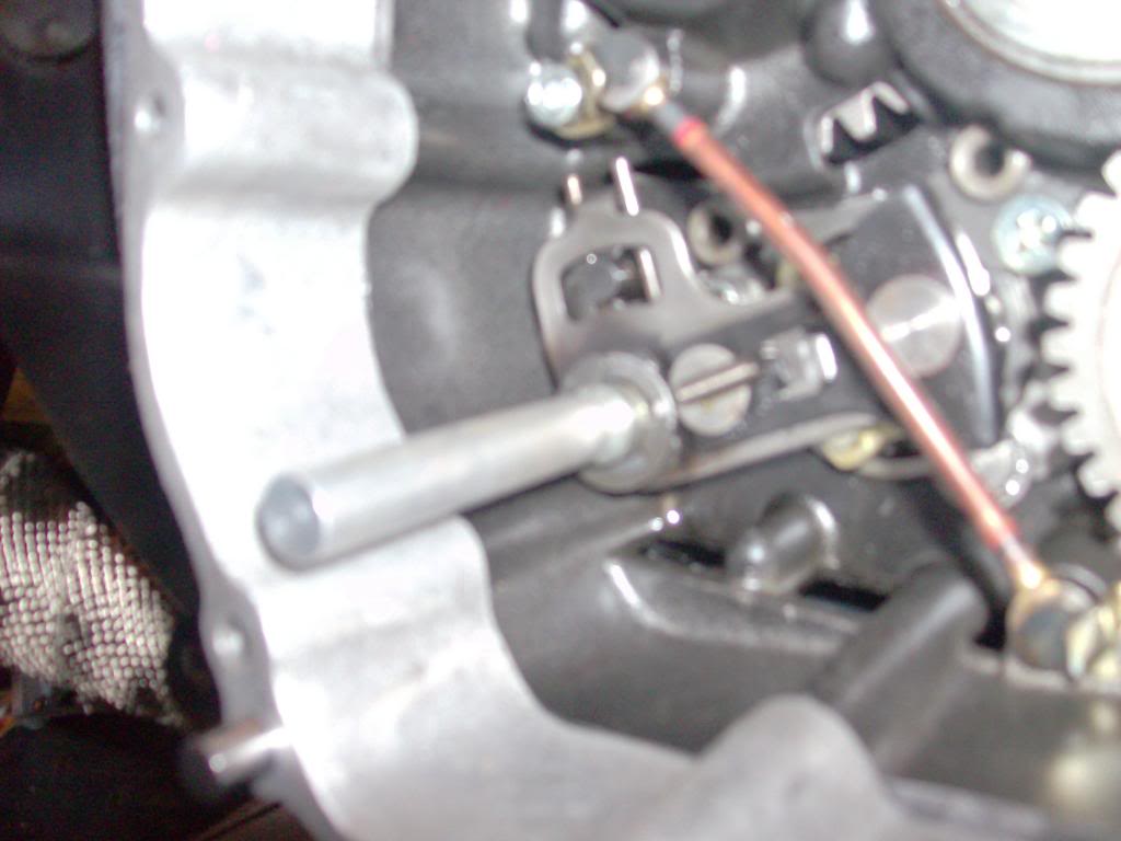

I figured out the shifter issue. It turns out it wasn't anything more than a simple oversight by me. And yes, I feel stupid. The clutch cover is the positive stop for the shifter shaft to keep it from sliding to the right. It has a circlip and washer that prevents it from sliding to the left. When you add the lock up clutch you need the spacer for the clutch cover to enable clearance for everything inside the cover. MTC also makes a spacer for the shifter shaft. It was in my box of parts but I forgot it when digging out the cover spacer. I'm sure I would've found it later but I just wasn't thinking about it last night. That's one of the problems with letting a project sit for long periods of time. I forget stuff.
Here's pictures without and with the spacer:

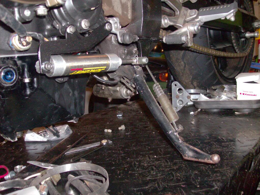

Everything's together and life is good. I was able to go ahead and finish the air shifter installation today as well:
