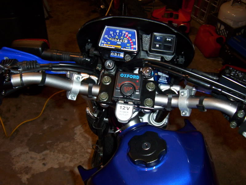

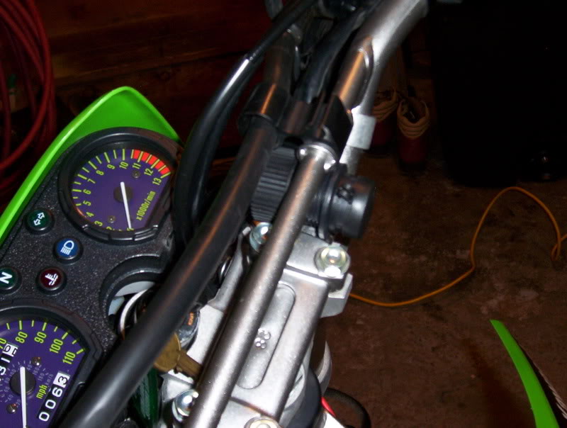

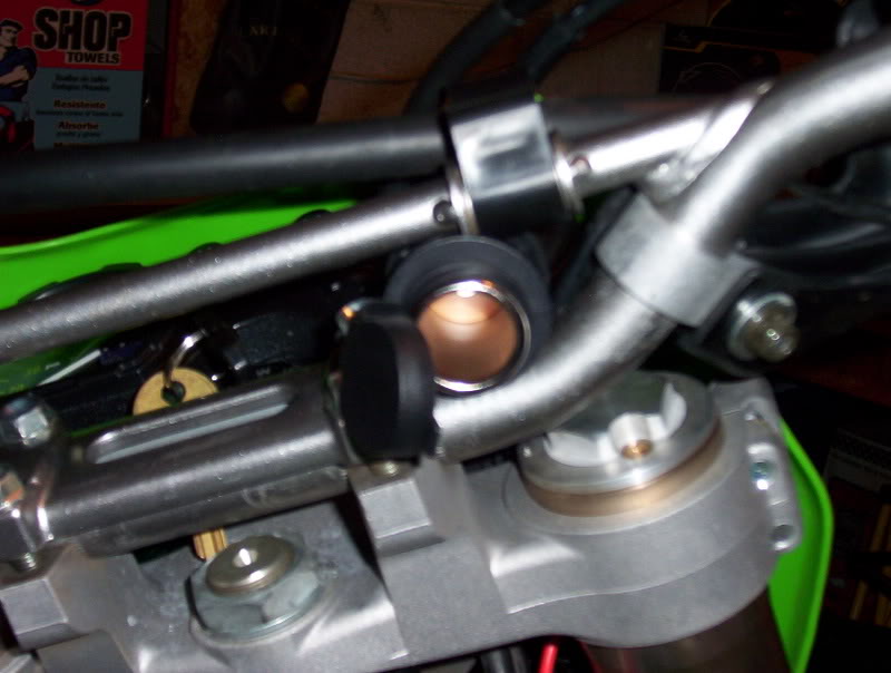

I added a Powerlet plug to my bike to run my GPS. Its sort of like a car cigarette lighter, but a litle more robust for motorcycle applications. (Its also refered to as a BMW typepower outlet, since apparently they've used this style connector for quite a while.) The basic kit connects to the battery and runs up to the steering head.
There are all sorts of adapters for hooking up electronic devices, heated clothing, and battery tenders. Here's a link to their products: http://www.powerletproducts.com/products.php?mid=1
Mike
Mike

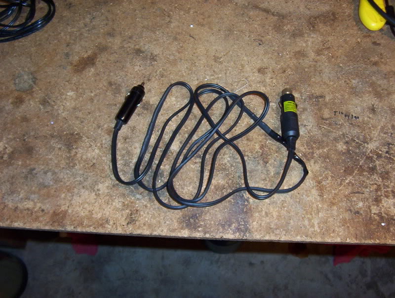

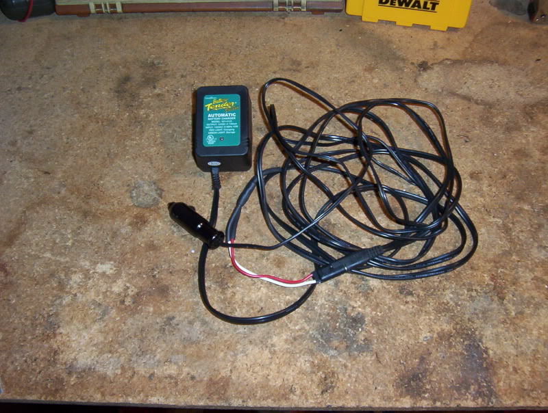

Actually YYY Guy posted a good picture, its all about preference. But one thing is for sure, you will want to connect the plug right to the battery. Here are a couple of pictures of mine.
Here is the battery maintainer, with the 12v plug for easy charging.
And finally the 7ft set of jumper cables, they work great, already tested. And compact too.
