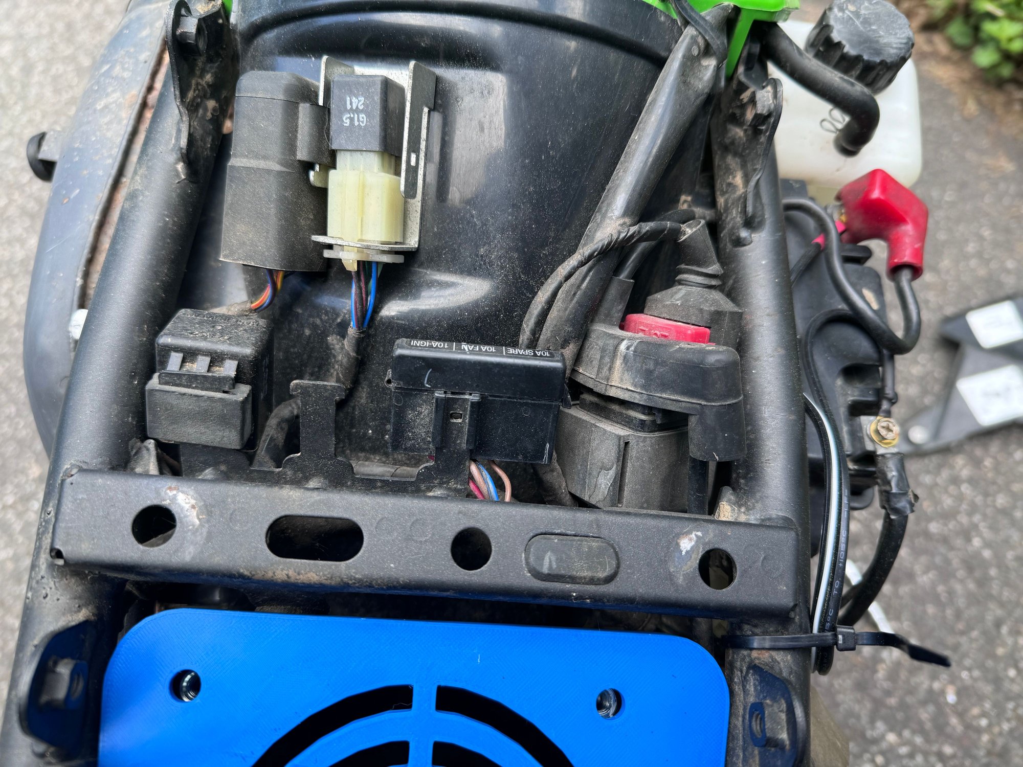

Old Jun 10, 2024 | 10:07 PM
raketemensch's Avatar
Joined: Jun 2024
Posts: 17
Originally Posted by AussieCheech
I did end up wiring it into the rear tail light. The wiring for the light happens to run through just behind the airbox, so I was able to splice in to the red tail light wire there. And ran the negative straight to the battery. works well.
Where in here were you able to tap into a red wire?
