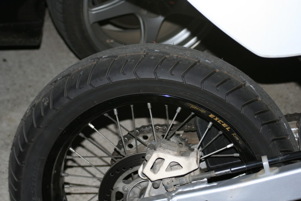

I'm using 110/70 front, 140/70 rear. Just fitted new Battleaxe tyres yesterday as it happens. 140 rear works well
