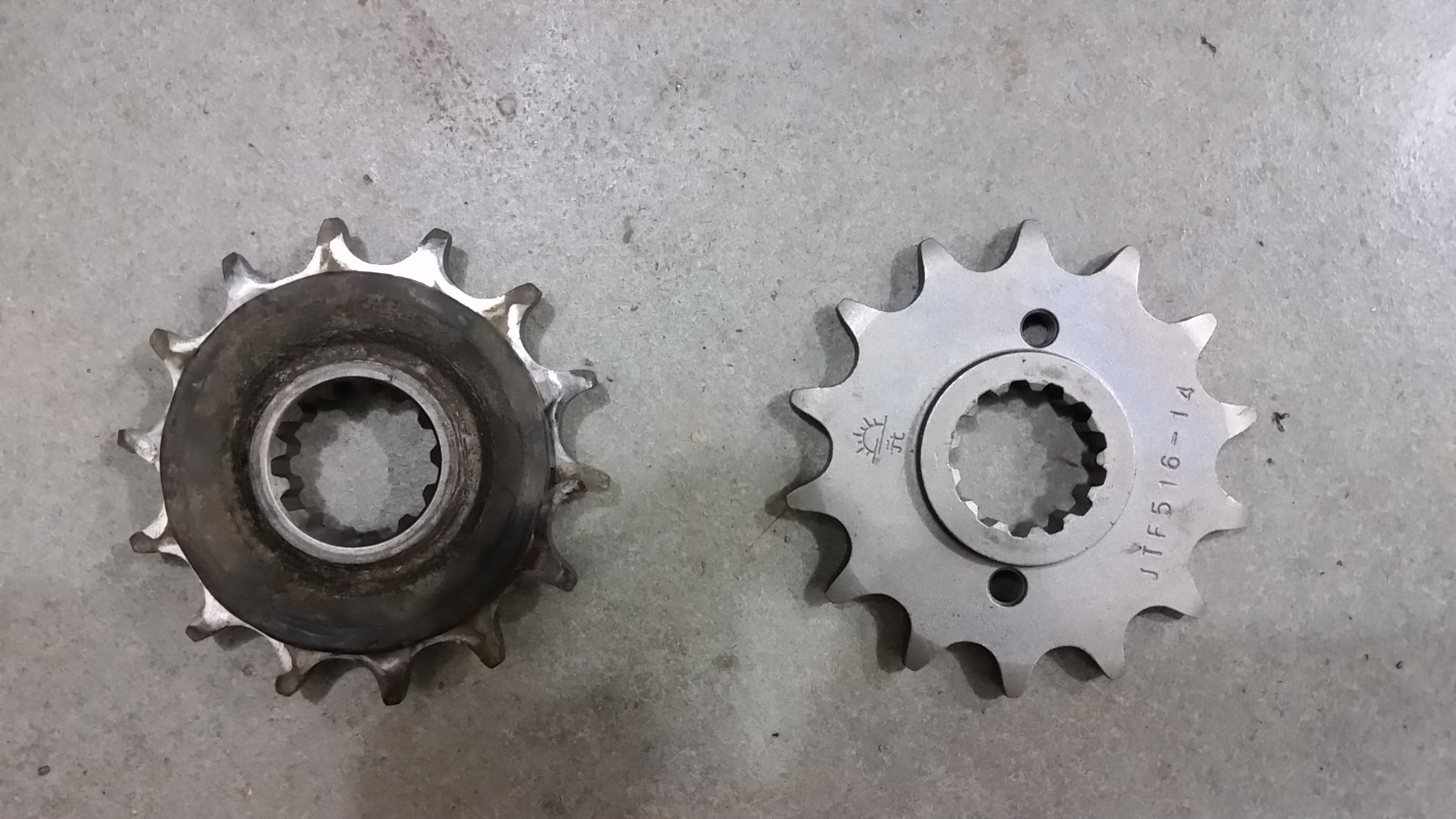

Upgrading sprockets 14-42. OEM and jt side by side. Does the flat side go on the inside or out? My first guess is flat side out. Can anyone confirm?

drm,
On my 2012, the side with the "spacer" goes towards the engine, pushing the sprocket away from the engine... i.e. flat side out.
Hope that helps...

thanks! will give it a whirl tonight.
