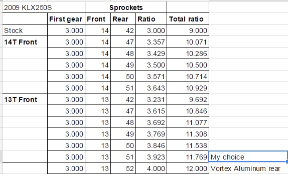

Here is a table showing ratios. PM me if you want this in Excel to play around with.
For nearly stock (snorkel removed), 95% dirt / 5 % highway, trail riding I like 13/51.
It is not too low for my riding. On wide open two-lane in southern AZ I have hit 55 mph according to GPS. It will cruise at 50 mph, level ground, pretty well when I need to get between trails. Otherwise I trailer everywhere.
I am pretty sure the chain is 108 links (12/15: no, it is 110). I bought a 120, tried it on the new sprockets, and cut it down to the right length. Had to move the stock chain guide forward. Had to get a "master link press tool" to close the o-ring master link.
On page 272 of the latest https://www.rockymountainatvmc.com catalog there is a chain sizing guideline of "Add one or two teeth to front or rear sprocket, add two links to the stock chain length" and vice versa.
Last edited by KawaBiker; Dec 15, 2014 at 11:05 PM. Reason: Correct chain length, stock chain guide
I am pretty sure the chain is 108 links.
I'd be interested to hear back on the number of links. There is no way I could get a 108-link to fit and I'm running 13/51 now (with a 110-link).
