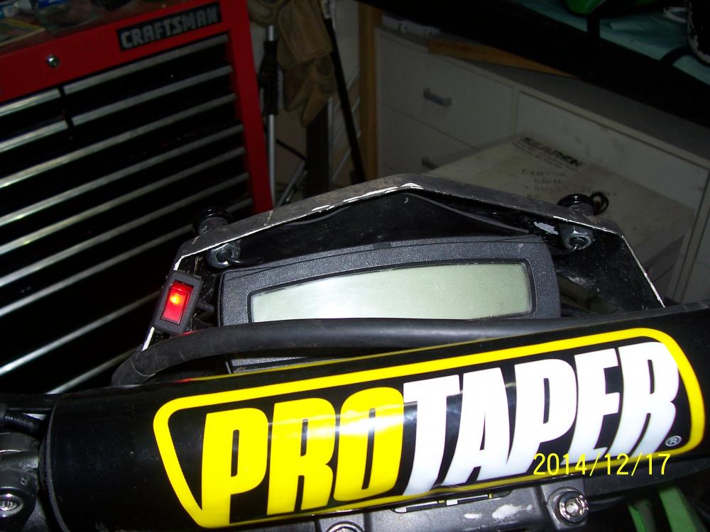

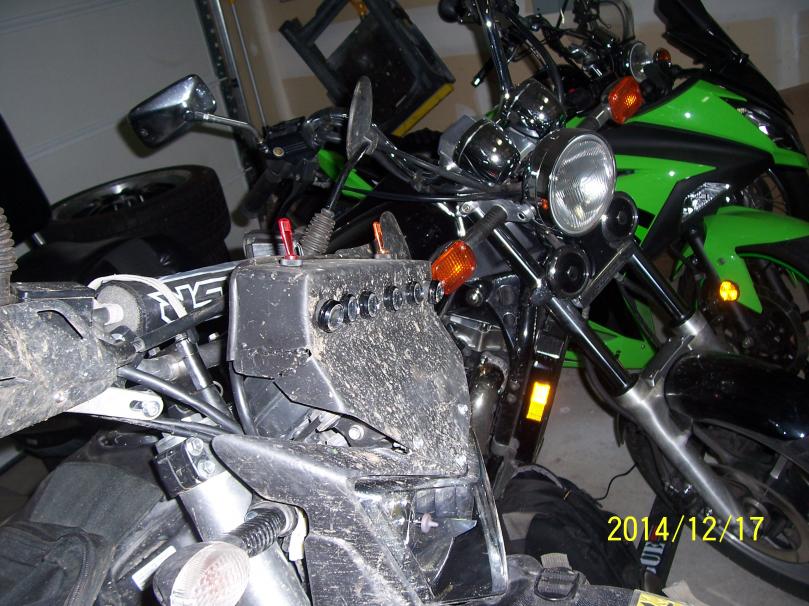

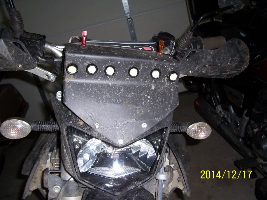

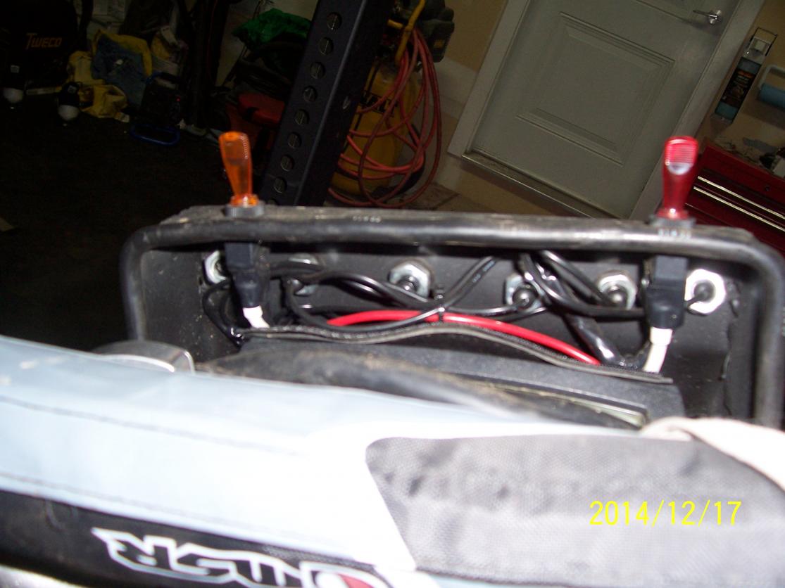

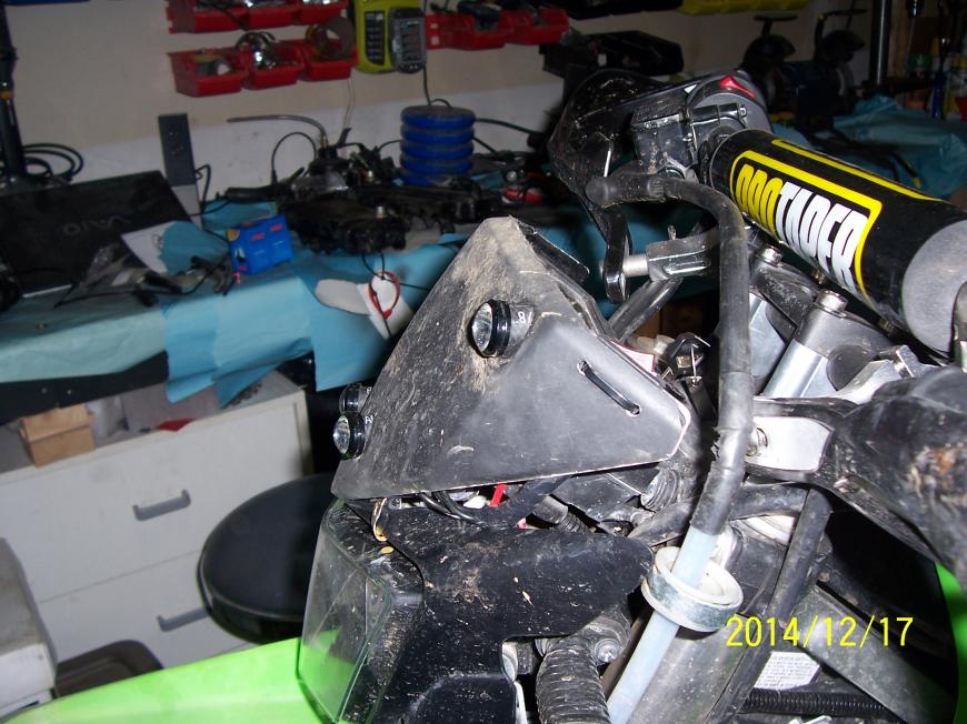

Here's a few pics of the lighting setup on my bike and my son's bike.
On each, I have a fused hot and ground wires directly from the battery up to a switch (or on my bike, 2 switches, one for 2 LED's and one for the remaining 4) to the LED's.
On my son's bike, since I used the existing number plate, I took some rubber hose (fuel hose?) and cut it at a 45 degree angle, putting one half on the front and the other half on the back side, which effectively angles the LED, so they weren't just pointing up in the air (following the angle of the number plate)
On my bike, the 4 LED's in the middle are pointing straight ahead and the 2 on the sides are pointing out to the side more, to light up the sides a little more.
