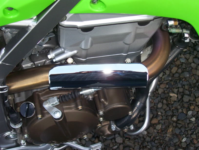

I like mine, I don't have the Mega-bomb but I was getting too much heat off this thing before I installed my heat shield.
