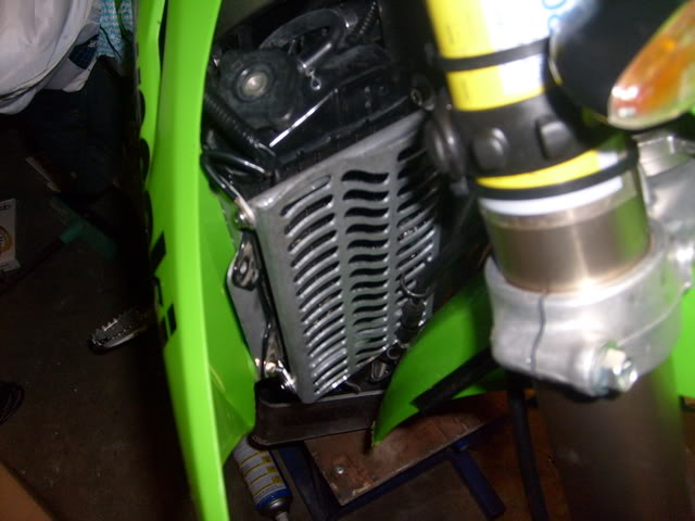

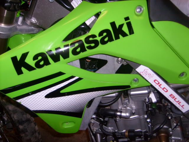

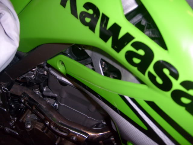

Hi All,
Put some Unabiker radiator guards on the KLX, not an overly hard task, no draining of coolant or removing hoses etc, the only issue I had was some of the bolts that shipped with the guards were too long, some of the ones that were 25mm I had to swap for 20mm bolts, especially the ones that go into the tank, I felt if I tightened them any further I was going to put a hole through the tank.. Anyway a couple of pics below..
Cheers
Chris.
