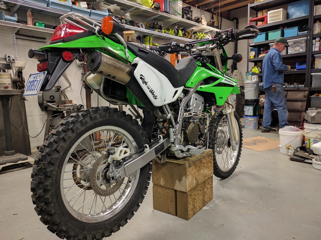

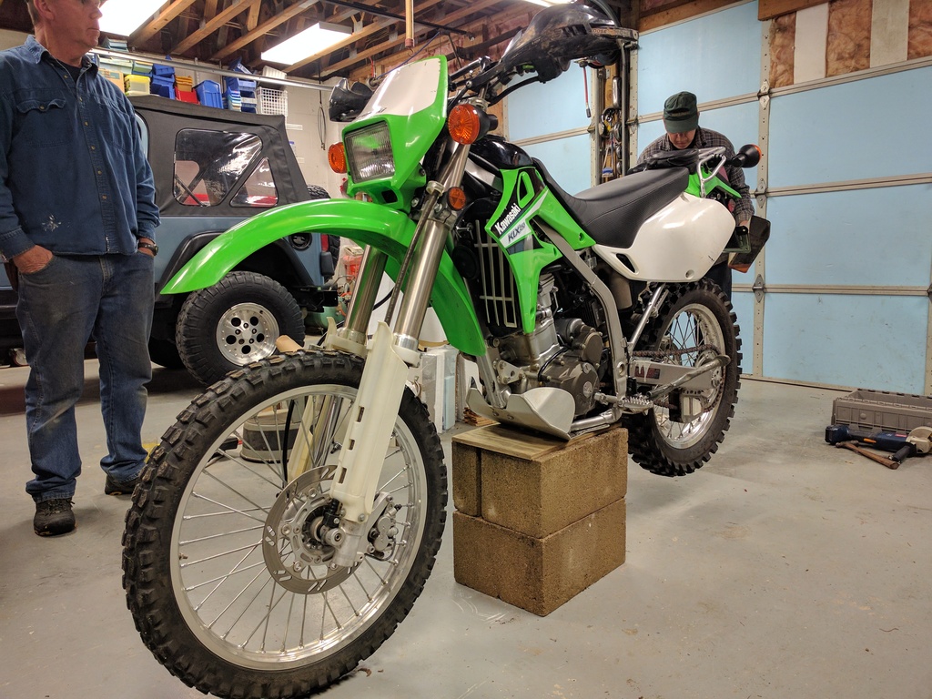

Here it is sitting in the shop ready for teardown, more to follow.

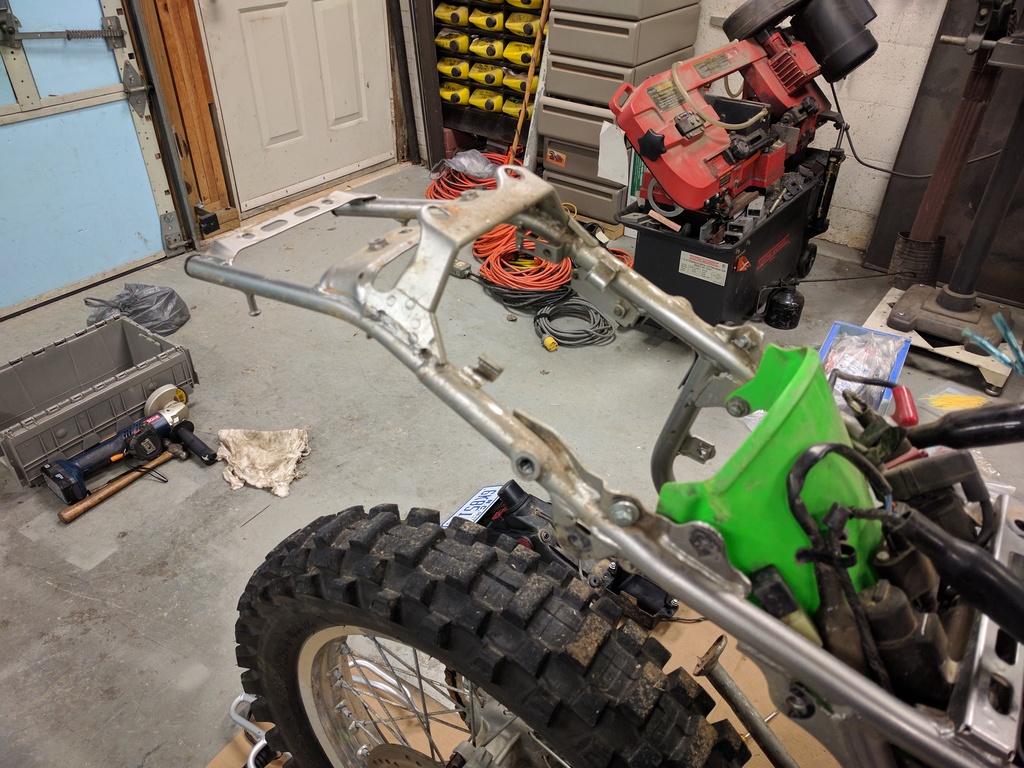

Tear down on the bike began a two days ago. All bolts put into labelled baggies and electrical connections and the like color coded with zipties. It came apart fairly easily.
Pulled off the seat and the fairings:

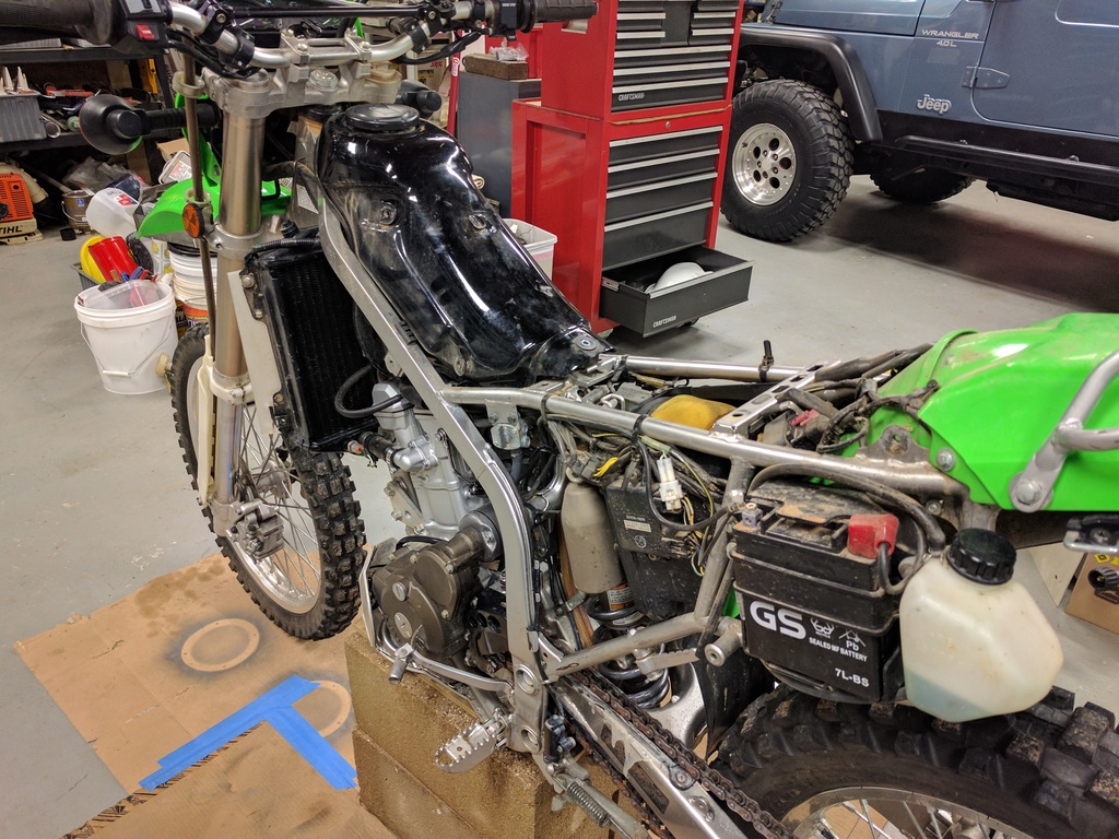

Then got rid of the gas tank and pulled off the battery box and rear fender/taillight.

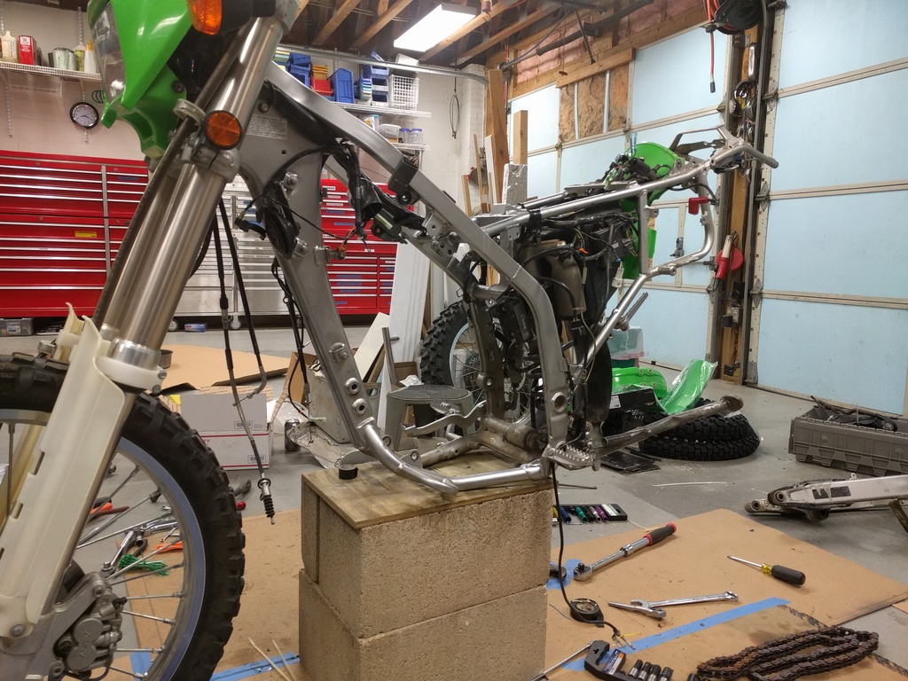

Got a first look at the subframe, and started thinking about what to do on reinforcing it. Luggage weight on the tail will be kept to a minimum, but support will be needed on exhaust side for sure, looking at doing something with the battery side as well.

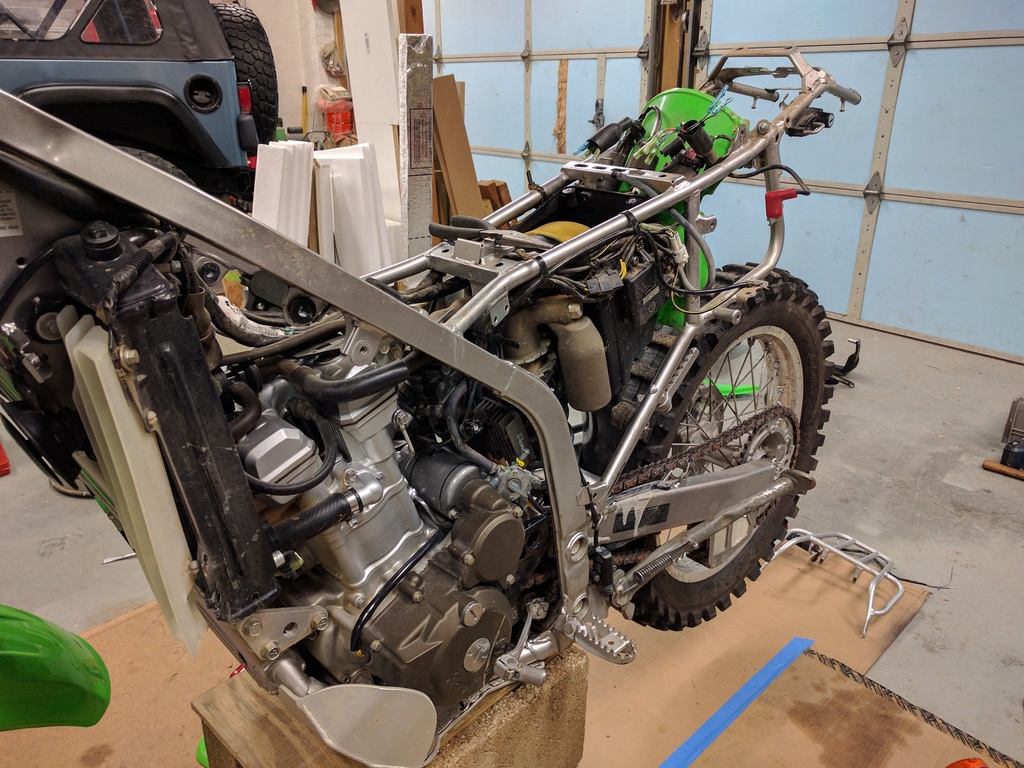

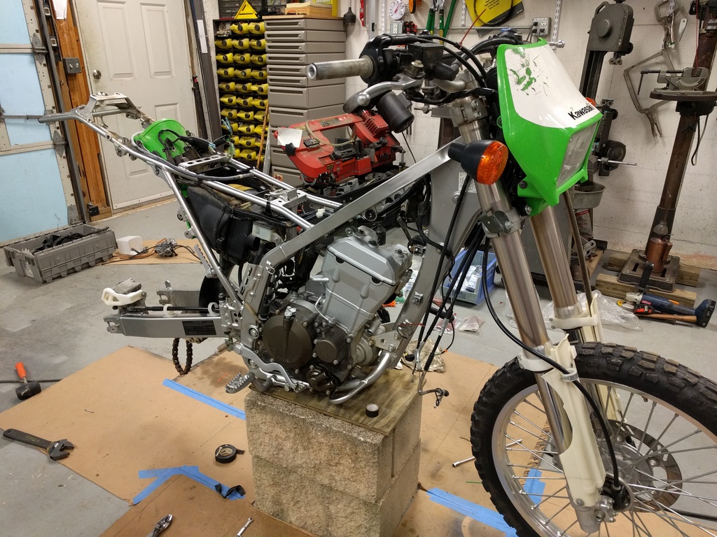

Decided to tackle the 351 kit first.
There are plenty of great resources out there for the 351 kit, so I didn't document too much. Here are some that were especially helpful for me.
- IDRIDR's build thread: https://www.kawasakiforums.com/forum...44/#post459473
- Dan888's thread: https://www.kawasakiforums.com/forum...s-links-32538/
- Armycopter's thread: https://www.kawasakiforums.com/forum...351-mod-31703/
- MrDuhfactor series of Youtube videos on a full build of a KLX250R can be found here: https://www.youtube.com/playlist?lis..._YMlhftAoWEvsu This series is great, as he has videos going through the entire teardown and install of a 351 kit.
Pulled the carb and the radiator to make some space:
Decided we weren't too far off, so just went ahead and pulled the whole damn thing out:

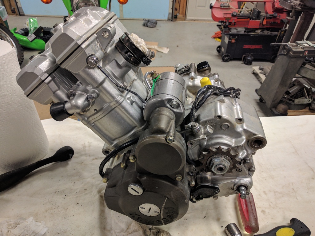

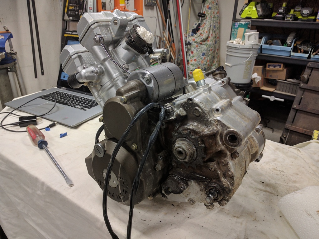

Motor hanging out waiting to be cleaned:
And all cleaned up and ready to go:
