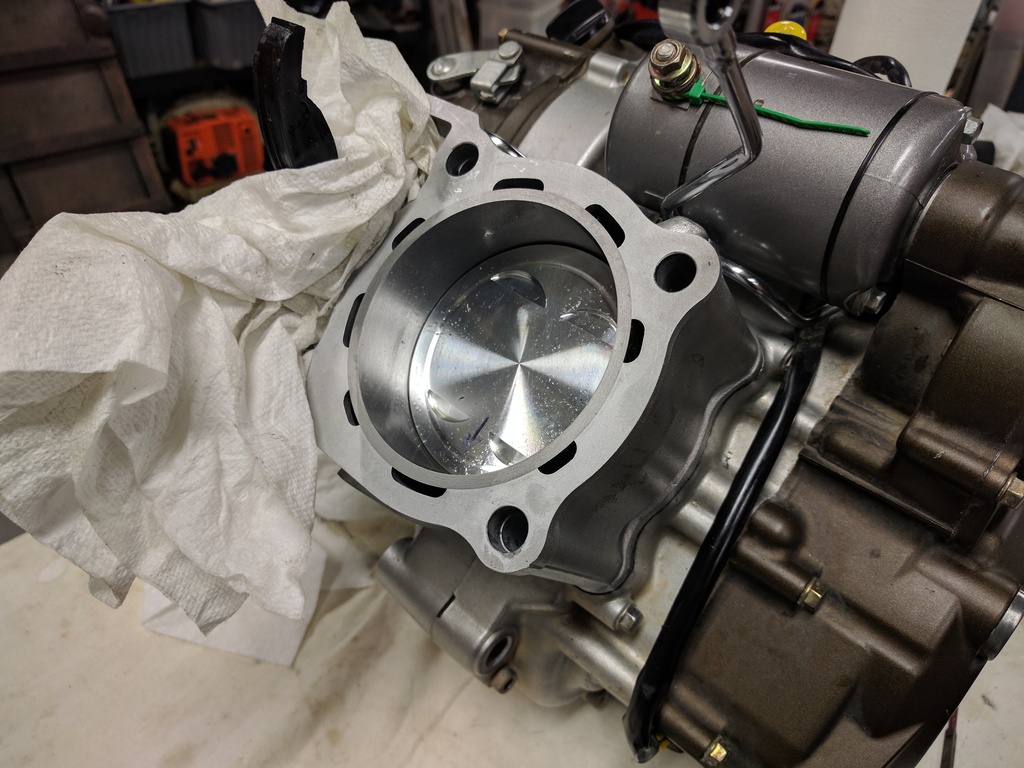

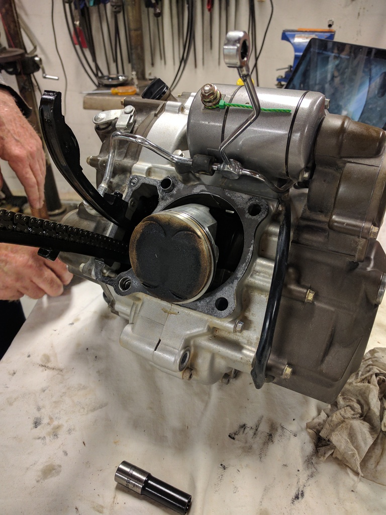

Started on the motor yesterday. It went fairly smoothly, but I did run into one issue that might help people in the future. When separating the head from the cylinder, and the cylinder from the case, there are small metal cylinders which drop in the channel that the head bolts go down through. They are there as pegs to hold the cylinder and head in place.
Here is the disclaimer, check and make sure that these "pegs" fit in the slots on the new cylinder you get from Bill Blue. I guess manufacturing tolerances change slightly or something, because one of the two on the bottom cylinder didn't fit into the cylinder side. Unfortunately we didn't find that out until we dropped the cylinder down onto the piston and were unable to get the cylinder seated onto the case. So we had to take it off and pull the cylinder. Ended up milling it out very slightly so that the peg would slot in properly. After cleaning everything up and getting the piston and cylinder back on, we encountered the same issue with the two pegs between the cylinder and the head. Luckily, it only took a little bit of working to get those to slot in as well.
I'm probably doing a bad job of describing the issue accurately, but unfortunately I didn't take any pictures of that process.

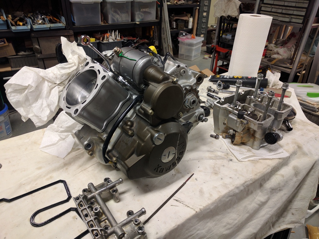

Here are a few pictures of it coming together:

As it sits, the head is back on and torqued back down, going to check the valve clearance and set the timing and close it up.
Do you mean part 92043 (92042 similar), which is called a pin in the microfiche?
I've never heard of that issue with one of Bill's big bores. Interesting.

Yes, 92043 is what I was referring to. Thanks for the assist, I didn't think of using the microfiche to point it out.
It was an odd circumstance for sure. After getting the cylinder over the piston we couldn't get it to drop down on the pins to seat against the case. After a lot of looking, pulling the cylinder back off, and a lot more looking, we tried the pin in the cylinder side just to ensure that it would fit. Which is when we discovered that it didn't. Another odd thing was that only one of the two pins had issues, the other one had no issues seating into the new cylinder. It was just one of them that required actual work to make it large enough to accept the pin. Same sort of issue later on with both of pins between the cylinder and the head. However all that had to be done for them to drop in was a light hand twirling of a drill bit and some lube.
I know it sounds weird, and it was, we spent a long time trying to avoid making any permanent changes such as we did, but that was what needed. I don't think it was a problem on Bill Blue's end. I doubt he even has anything to do with those parts of the cylinder, because why would he? All I can think of is to just chalk it up to slight manufacturing tolerance differences on those particular pins from my cylinder to Bill's.

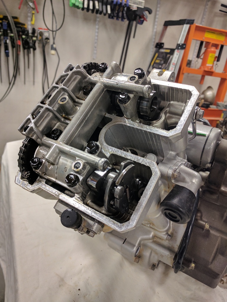

Went to finish putting the motor together today. Decided to check the valve clearances before we closed it up and I am glad that I did. The exhaust side looks great. I think I was reading like .18 or .19 or something. One of the cam lobes on the intake side looks fine, .14 or so, but the other intake lobe seems to be quite tight. Can't even get the likes of a .08 to slide in there. It seems a bit odd to me, and in hindsight I wish I would have taken some quick readings during motor teardown, I would be curious to know what it was like stock, if any different. All the same, I ordered a shim kit and the motor progress is stalled for a few days.
I did a few odds and ends and moved on to work on the front end of the bike as I wait for parts.

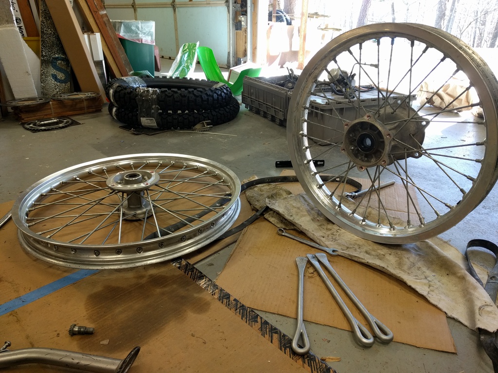

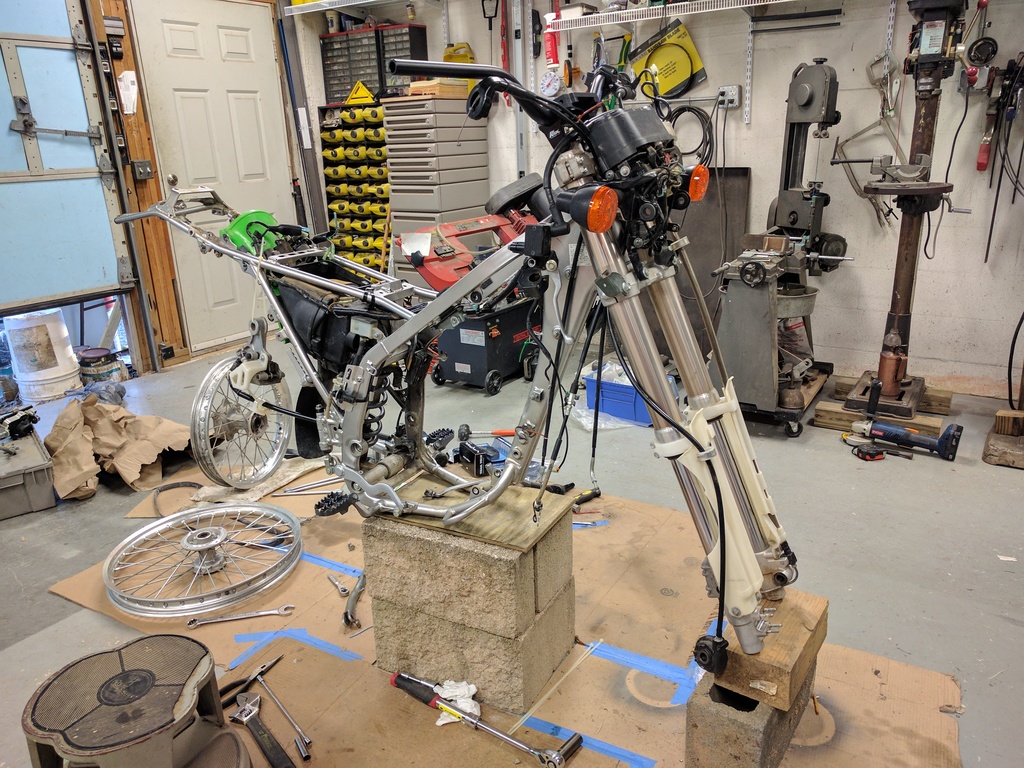

Spooned the tires off the wheels, and removed brake rotors and the sprocket. I'm thinking I am going to have a go at painting them black:

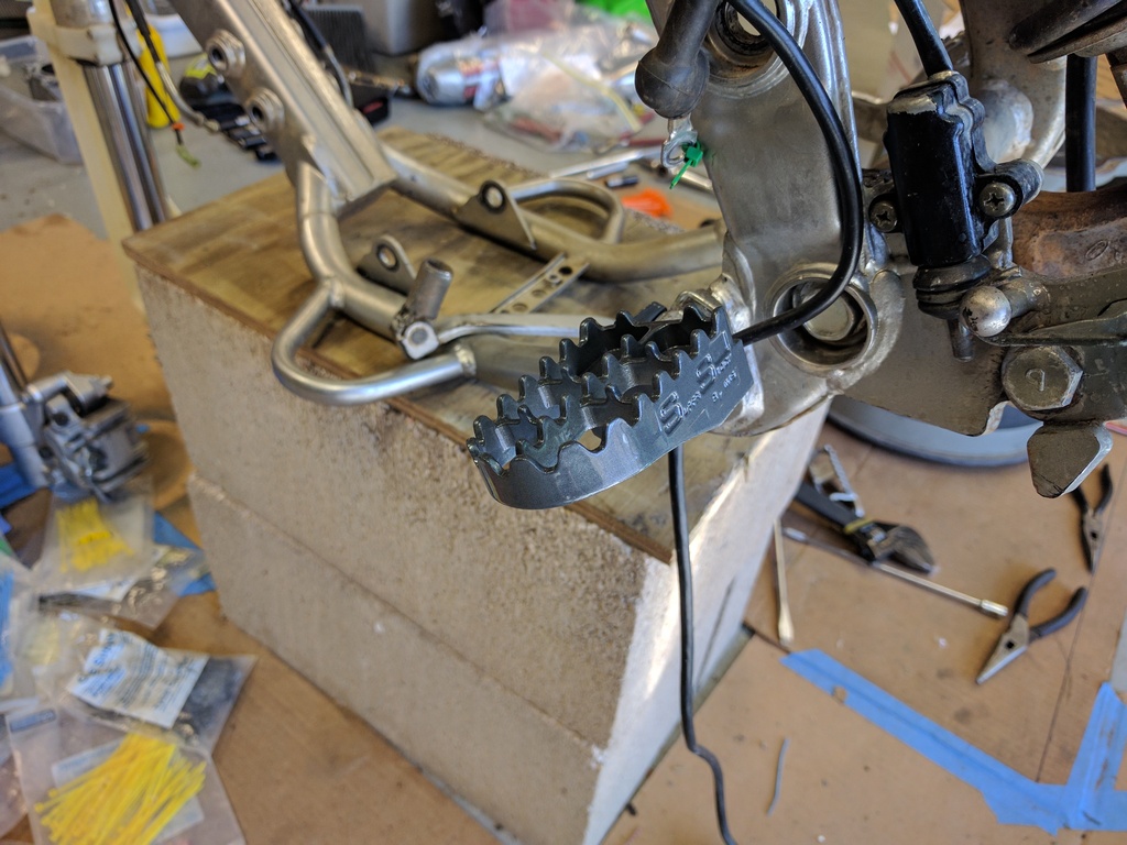

Threw on some IMS pegs:

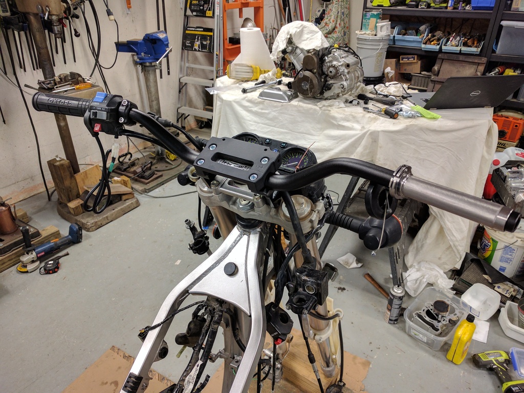

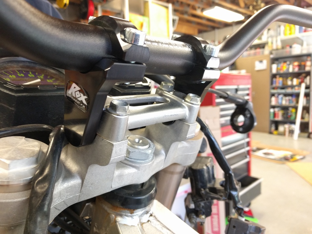

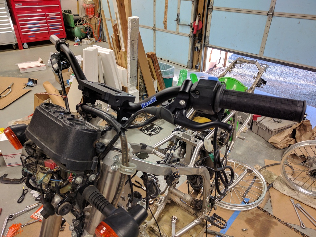

Started work on fitting up the handlebar setup. It consists of Rox 2 inch risers, Renthal Fatbar, and Highway Dirt Bikes top clamp:
The bars are the Reed/Windham bend. The are really similar to the stock bars, maybe just a bit taller, and ever so slightly more sweep. They are very close though, I would almost call it a direct swap:
Starting to fit up some of the goodies. RSC shorty clutch and Oxford heated grips. I'm thinking I may get lucky and have enough clutch cable. Maybe. I'm almost positive I am going to need a longer throttle cable though, especially after mocking things up some today:
