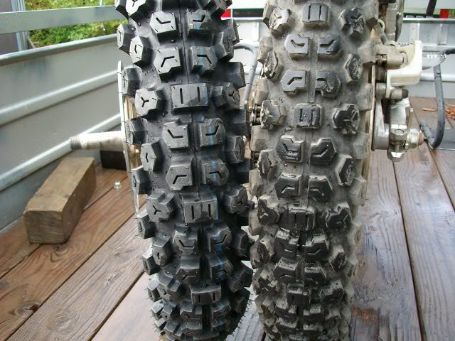

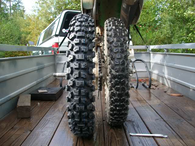

Sorry it took so long, got the 120/80 mounted today, but it's going on my 250x instead.
The 120/80 mounted is 4.61" wide and 3.2" tall (vs. 4.2 x 3.8 for the 4.60) an inch shorter and almost a 1/2" wider. IMHO a better size than the other kendas for my little 250's.
I'm leaving the 4.60 on the klx, have been on a few good DS rides and it works fine, but next time I'll get the 120/80. There are pro's and cons of taller tire, pro is taller footpeg and case height, con is it gears the bike up a little noticable when crawling around in 1st.

side by side, 120/80 on left, 4.60 on right:

Great pics and great info thanks!!
