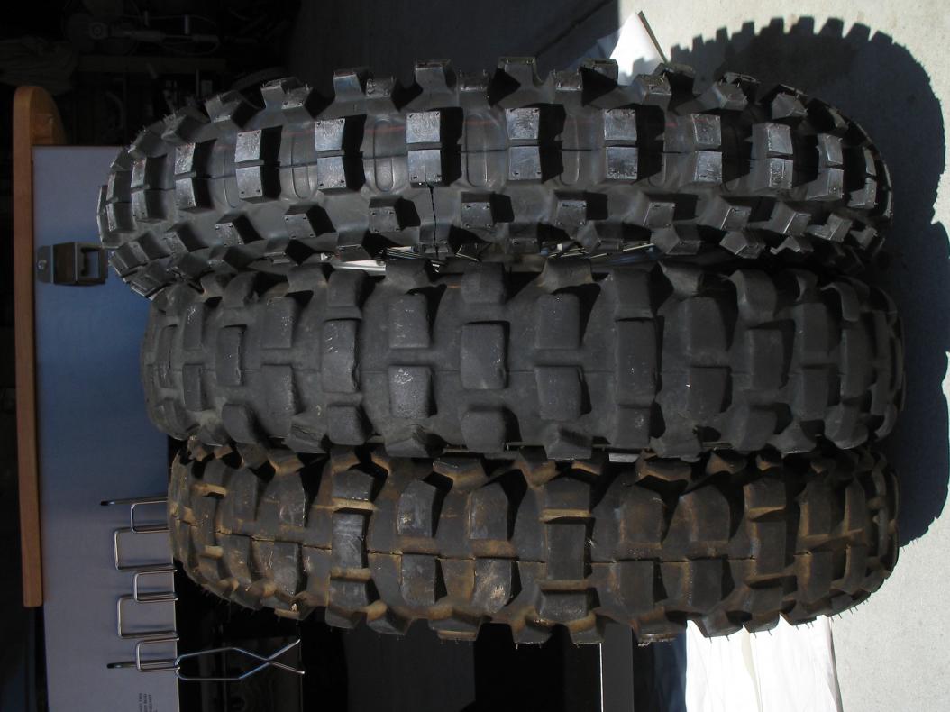

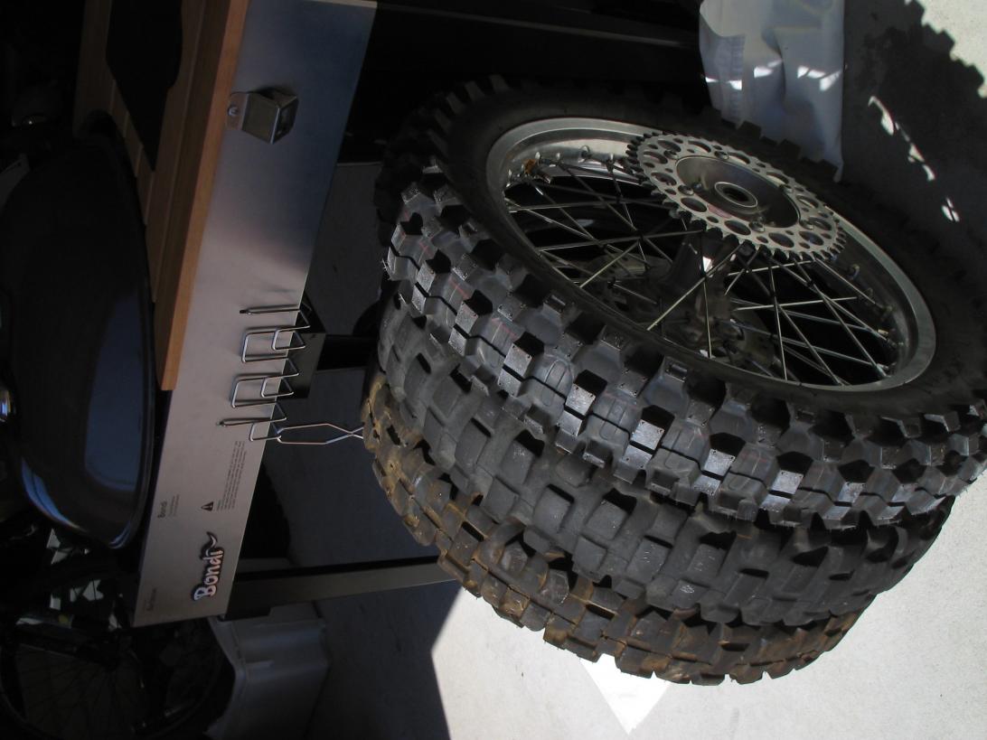

The 606 120 is a 120 size , in it's bigger than the 4.60 Dunlop D603 it replaced (OE) and it was wider than the 110 Pirelli MXExtra I replaced it with. It is wider than the 110 pirelli and I recon' a little taller too, as I remember the stand angle was way different once I fitted up the 606. I wouldn't go back to a 120 section now I've found the 110 MXExtra. It does everything better for em (my style and our roads/trails.) I've just purchased another 2.
Pics show OE Dunlop 4.60 D603, Dunlop 120 D606, and a new Pirelli MXExtra 110. Note how tall the 606 is compared to the 603 even though the 603 has more tread left. The 606 is a tall tyre.
