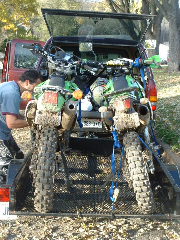

The D606 130 fits, and I didn't really notice any loss in power or performance with it on (I'm not a very sensitive guy though ), but it costs more than the 120 and it really didn't seem to give an advantage anywhere. One slight negative I noticed, was that the bike leaned over farther when on the kickstand. That is because the 130 tire is taller as well as wider. I have a pic of 130 vs 120 somewhere .
Dan
Old Jun 18, 2011 | 02:52 PM
OK heres the pic.
My bike is on the left with the D606 130 on it, and my buddys bike on the right has the D606 120.
Dan
