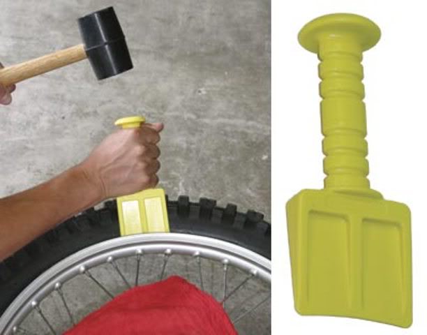

USUALLY the tire is easily loosened from the rim by simply pressing on it, hitting it with a hammer or whatever other means you need to use. In the event that it resists all other mean, I have a neat little tool - a bead breaker that is nothing more than a wide plastic wedge with a curved edge on it. Here's a pic -
I got it from Fred at Arrowhead Motorsports. It's a great tool to have around. If you don't have any tire irons, I also got mine from Fred - I use the long Motion Pro ones. There is a nice curved end for spooning the tires on. I think they're about 14 inches long.
