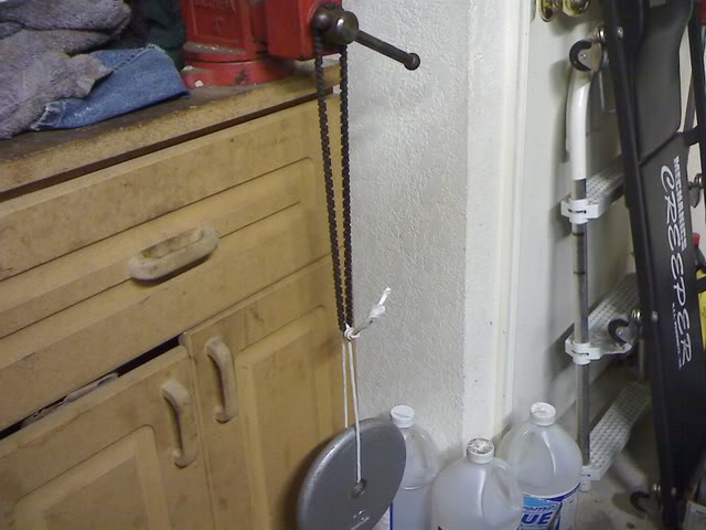

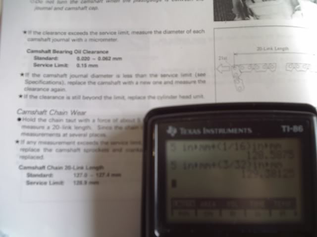

Final results. The cause of the clanking was do to a stretched cam chain. After following the repair manual as guided. I came up with the following measurements. 5 1/16" (128.5875mm) to 5 3/32" (129.38125mm). Service limit is 128.9mm. Standard length should have been 127 ~ 127.4mm (5" ~ 5 1/64"). Tests was done by hanging a 10lb weight from the cam chain and the handle of a vice. Measured by a straight edge ruler.

omg the dreaded ti 86 my stat's class nightmares will be back thanks alot!
Thanks for posting the results though

There is no true measured amount. Just adjust it enough to quiten the chain. 1 click is usually enough. I did 2x clicks before I replaced the cam chain. After I replaced the cam chain, I haven't manually adjusted it since. And it has been about 2,000 miles since then.
