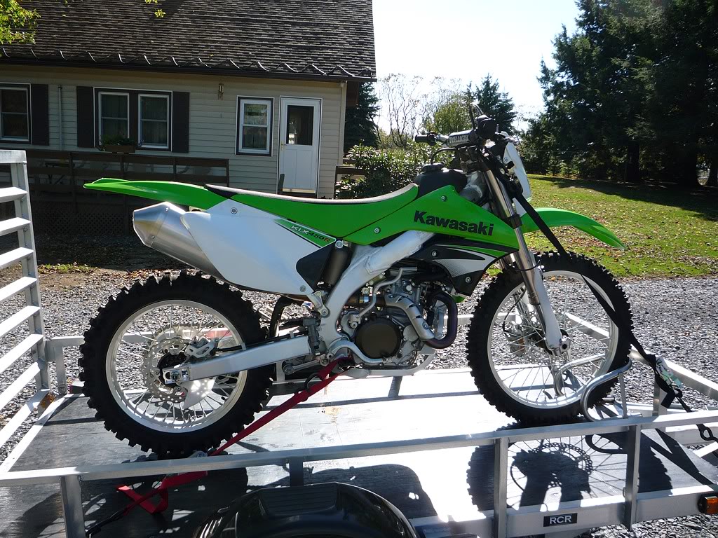

I was right where you are last fall, but for different reasons. I had already turned my KLX into a weekend warrior and wasn't doing any commuting with it. With the 340 kit, mine has plenty of power, and I had Moto-Pro do the suspension, but what I wanted was a lighter bike. In gnarly rocks, my KLX340 would get to be a handful, while my friends on KTMs, Huskys, and Husabergs had less problems.
I was seriously considering either a Husky TE310 or KTM 2-stroke, but they were out of my price range. I then ran across a leftover 2008 KLX450R at a dealership that was less than half the price of a new Husky. There was a shop near me who specialized in licensing off-road bikes, so I couldn't pass it up. Turns out, PA issued me a real motorcycle title anyway. I put a Baja Designs dual-sport kit on it, got a plate, and now I'm just waiting for the snow to melt.
I bought my 450 late last year and only got 1 real ride on it, aside from tearing up my yard. Completely stone stock, it easily has twice the bottom-end power of my 340. The power is very linear with no big hits, but it has gobs of torque. For those gnarly rocks I mention earlier, it might have too much power (we'll see this year). It also feels very light when riding - I can throw it around at will, where my 340 takes some work. Being a 5-speed, it runs out of gears quickly, but it can run 55 MPH without crazy RPMs.
Because the KLX450 is jetted so lean stock, it runs hot, flames out, and is hard to start. These traits aren't as bad as other stock bikes, but they're still bad. I rejetted mine with a JD jet kit and larger pilot jet. Try hard to verify if the bike has been rejetted, because it is a total PITA to get the carb out. PITA = the subframe has to be unbolted and the rear shock has to be removed! No matter what the seller tells you, buy a new battery for it. The stock KLX450 batteries are crap and don't hold a charge long. Also, do some research on the head pipe. I was thinking of replacing mine either with a KX450F headpipe or the FMF, but those who have tell me that they really take away low-end power and add a large hit to the mid-range. One thing neat I found out about the KLX450 is that plastics are dirt cheap compared to a KLX250s. For just over $200 you can get all new OEM plastic (fenders and headlight shroud included), if you wanted to make the KLX look new again.
Here's my 450 the day I brought it home.
