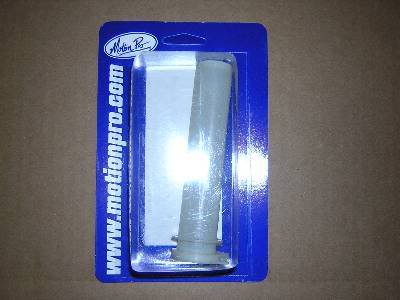

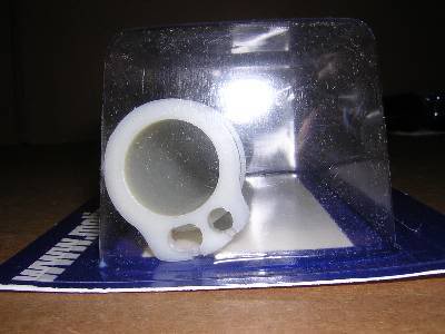

From a little research, I can say that the KLX300 part # for the throttle assembly is different than for the KLX250S. The diagram looks the same, but I have learned the hard way that this is not a guarantee of anything.
I found a couple of pics of a KLX300-compatible throttle tube from Motion Pro. If anyone has looked at their throttle tube lately (Eric!) maybe you can tell if this looksto be the same or very similar. My thought is that the cam might be a touch bit different, but I don't recall for sure.

Old Jan 31, 2007 | 10:58 PM
Default RE: Throttle Tube Replacement
From this view..... it looks damn close to the stock one..... but i havent taken it apart enough to see the other end of it... maybe if you can recall your escapade from FL, when you tried greasing your throttle cables....
