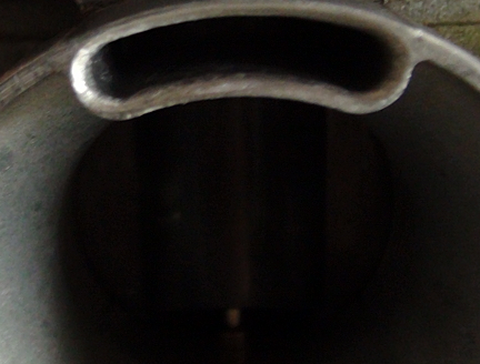

I went as far as rounding off the inlet port entrance so air could flow in faster to raise the slide.
