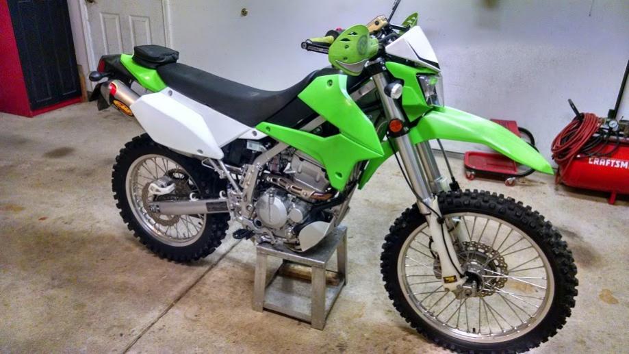

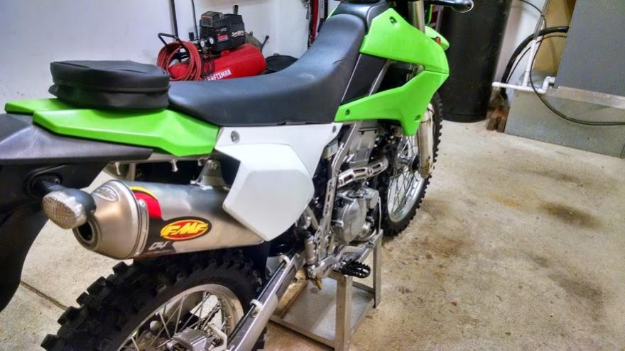

I was running the stock CVK carburetor with the Dynojet Stage-2 kit and I recently purchased a TM 33/34 Mikuni pumper from Bill Blue plus, an FMF Q4. I was really struggling riding tight, technical single track with the lack of low-end grunt and the new pumper is much better! I almost have the jetting sorted out; the bike starts good, idles well, accelerates great to 8,500 RPM then I get a hesitation / surge to 9,500 RPM. Currently, I'm running a 40 Pilot, 145 Main, Needle clip in middle (3rd) position, Fuel screw 1.5 turns out and snorkel removed. I'm also roughly 700' above sea-level. My spark plug reading appears grey to slightly tan so I think I'm still slightly lean on the Main..? Any thoughts? I do have a 147 Main that I could try but I have not read of anyone else running this rich of a main jet.. Thanks guys for any thoughts you man offer..
