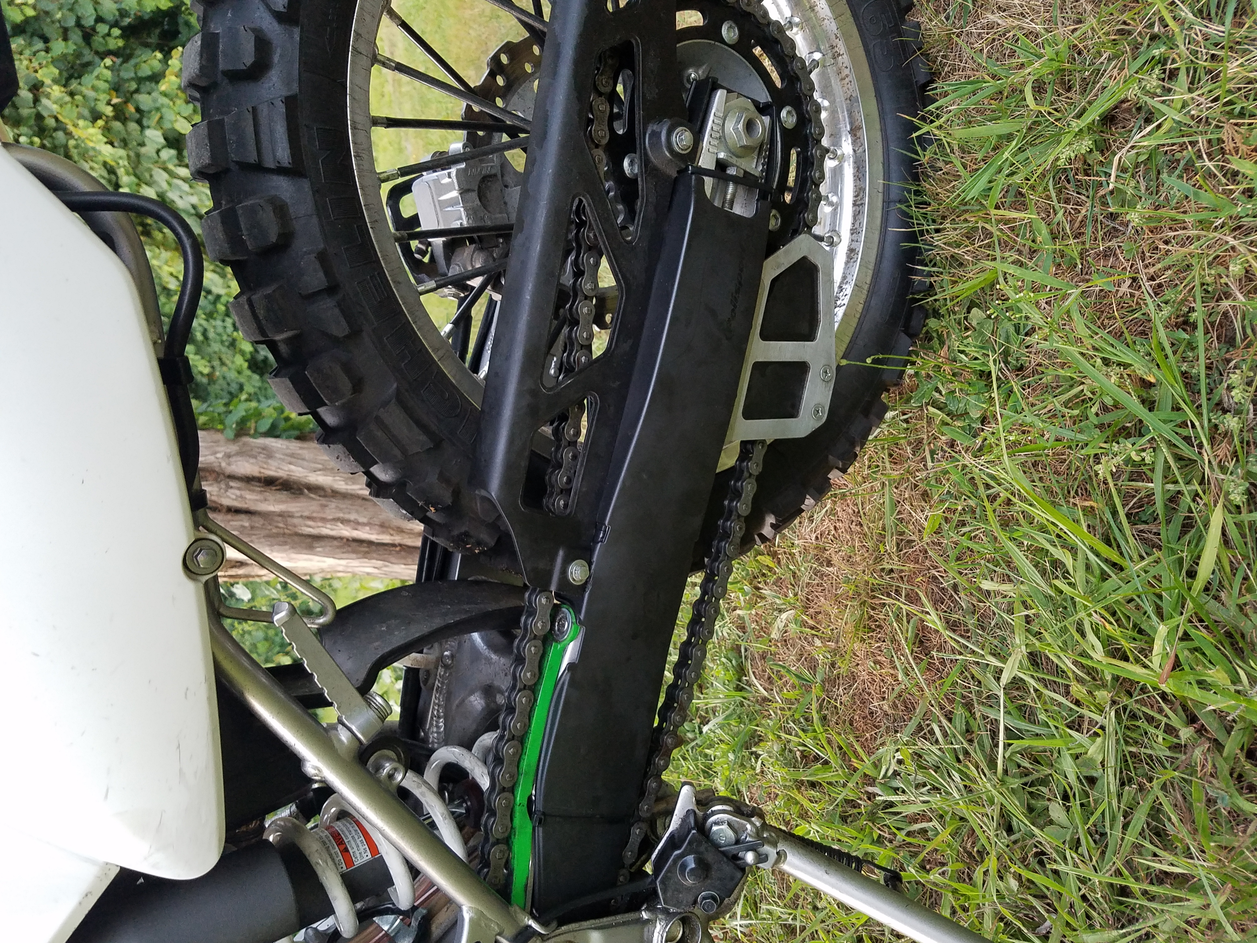

Has anyone found plastic swingarm protectors to fit the 09+ klx? Was thinking maybe from a Kx250F as the KDX ones have a cutout for the kickstand. Thanks

Well I took the $35 chance and they fit. 2012-16 Kx250f/450.
Left needs minor trimming. Right side no issues.

I like it. What kind of trimming?

On left side protector you need to make two slots for the chain guard mounts to come through. Then at the chain guide trim it a little longer. (Kx must be a 2 and not a 3 bolt). On the very front of the protector by the front sprocket trim it 3/4 inch shorter.
Tin snips work great for this.
Right side just slide it on.
