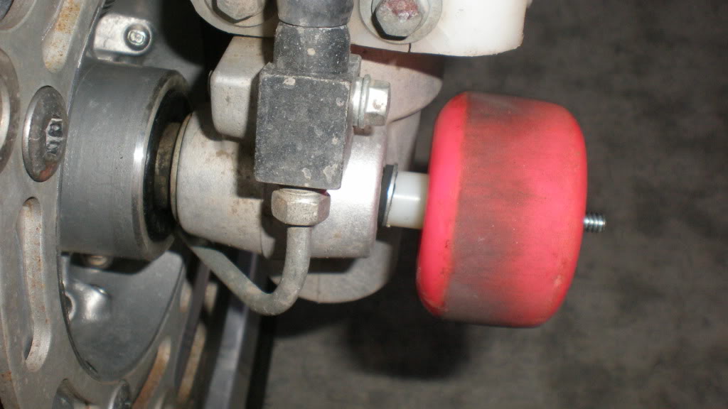

I'm an 09'er and I was planning to use some all-thread rod, replacement sliders from SME, and some washers and lock-nuts to make axle sliders. Some folks do this with skateboard wheels.
I ended up using the skateboard wheel method. $6 in hardware from Lowes and my old skateboard wheels; can't argue with the price and it looks good IMO.
Rear:
Front:
I used a 1/2" nylon spacer to clear the left fork bottom:
Rear:
Front:
