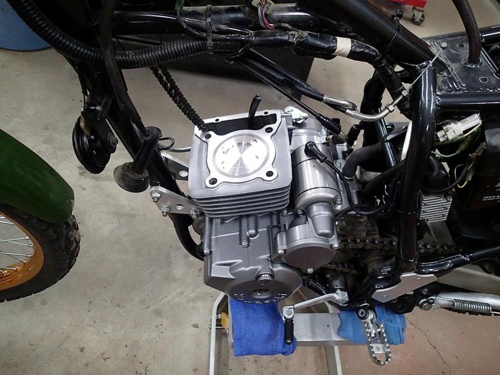

This is an old thread I know, but it happens to be timely for me. A little while back, I picked up a 2000 Super Sherpa for my girlfriend Joyce.
Joyce is an experienced rider, and put thousands of miles on a Yamaha XT225. The XT was getting long-in-the-tooth though, so the Super Sherpa replaced it. Joyce could handle more power, but she's small and short, so she can't handle a heavy or tall bike well. I decided to turn the Sherpa into a mini adventure bike for her.
The first step is to give it some more power. It does OK for her stock, but more couldn't hurt. I got in touch with Bill Blue, and sent him my cylinder. He whipped up a 300cc big-bore kit for it utilizing a KLX300 piston.

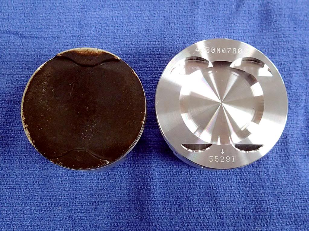

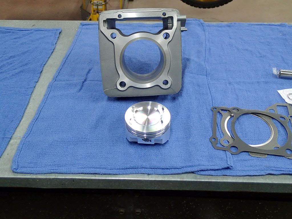

The cylinder was sleeved and bored, and Bill included a forged Wiseco piston.
Here's the stock piston compared to the 300cc piston. The difference is 6mm.

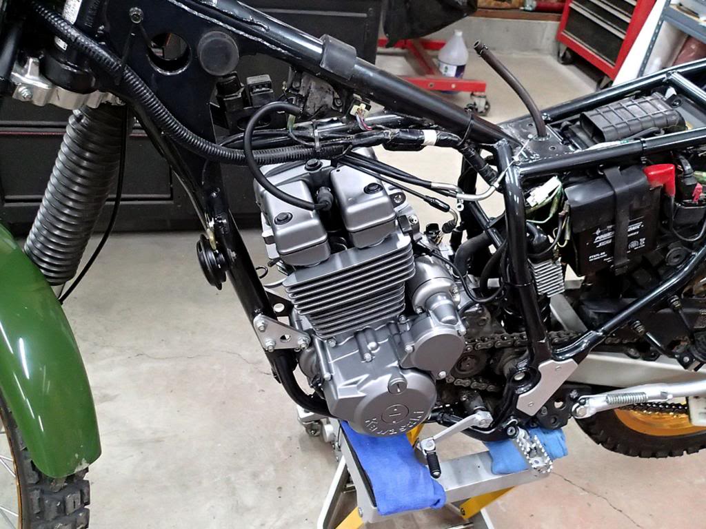

This is where I'm at right now. Next, I'm going to work on either rejetting the stock carb are getting a pumper, and then make a rear rack and side bag mounts for it.
It will be a little bit before I can ride it to see the difference with the 300cc kit, but I wanted to show another example of Bill's work. I'm very happy with the kit.
