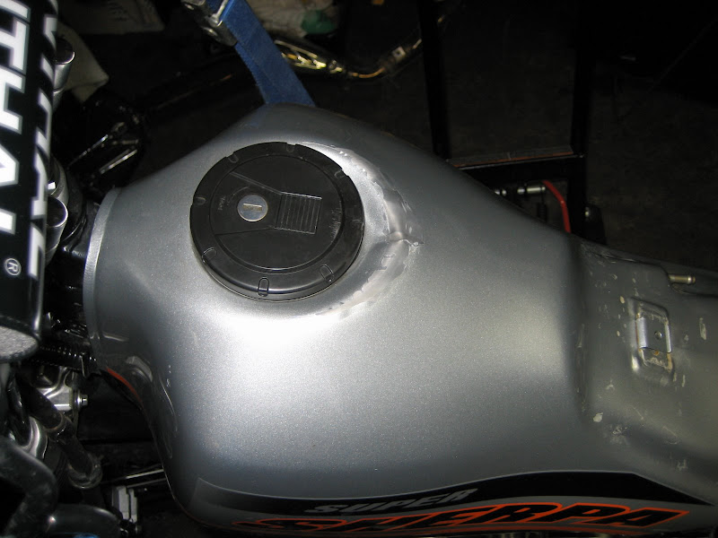

Oh yeah, and I learned an important lesson in all this.
DON'T ALLOW YOUR WIFE'S GAS TANK TO FALL OFF THE WORKBENCH AND LAND HEAD FIRST ON THE CONCRETE!
(actually I wouldn't recommend it for any gas tank)
Guess I got some body work to do, and some painting. [&:]

thats gonna want to pool water down to the fuel fill now - have to pull the fill cap back up out of the tank. no real easy way to fix it.

Nice job and sorry to hear about the gas tank, I would have sat there crying, but that's just me, and then on to e-bay looking for a replacement, but that's just my sickness talking.
