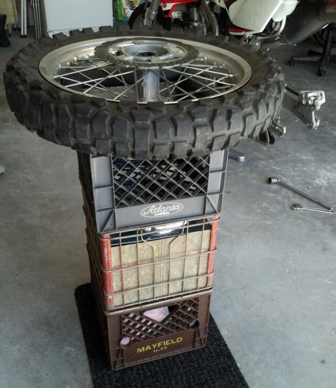

i saw a post where someone was using a drum as a stand
while looking for a drum of the proper size,
i realized these would be perfect for the task at hand
rotors and reg sprockets fit just inside the open top

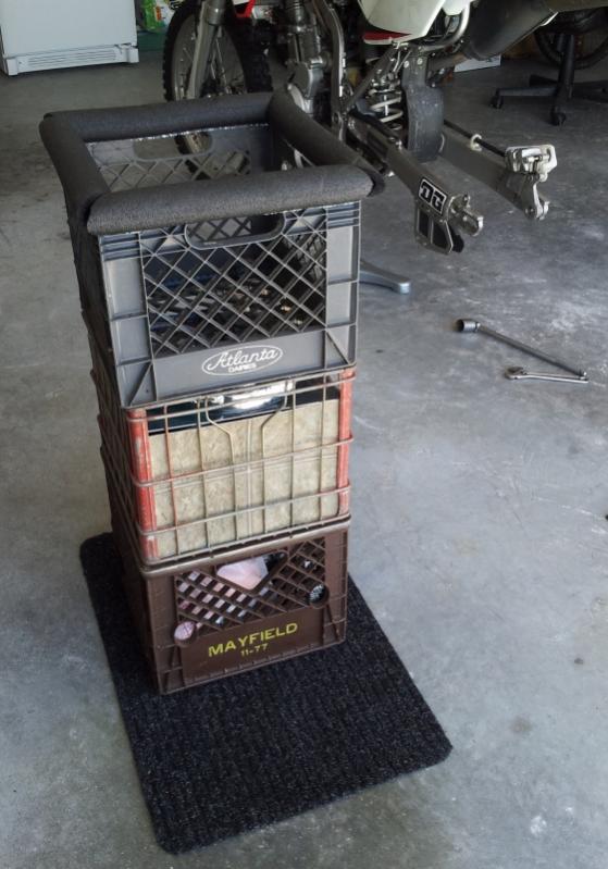

i had cut 4 pieces of garden hose to line the top, but...
had some pipe insul left over from making a cross-bar pad
just the perfect amount of cushion and grip for the wheel
its the perfect height for working, and getting some leverage
im too wise (read that as old) to be working on the floor
throw in some heavy junk for a little weighting

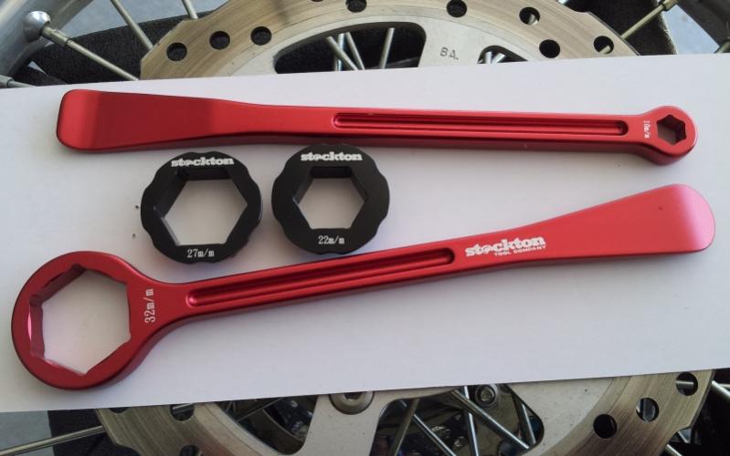

i didnt have any tire levers for carrying on the bike, so
this set was $30 at GC. alum levers with 32,27,22 and 10/12mm
i dont really like GC, but this is alot of bang for the buck
the same thing orange branded is about $90
shinko 244s went on very easy after warming in the sun
Attachment 6641
NICE set of spoons! I wouldn't mind adding those to my kit. Who is GC?

sorry- CG = cycle gear. not my favorite business model
