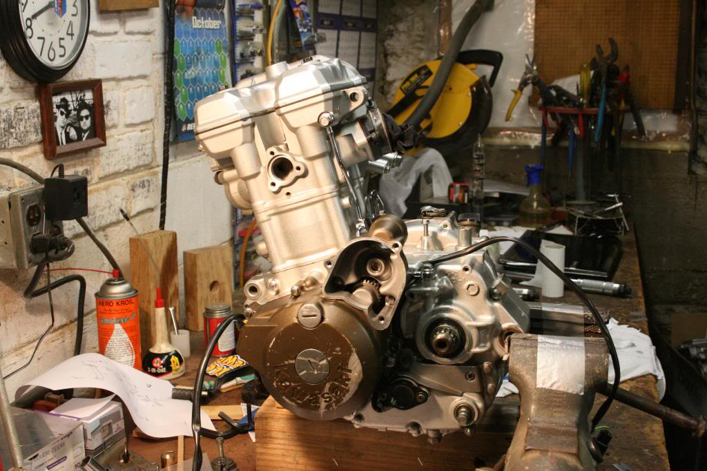

Last night, I pulled the left side case cover for inspection and didn't find any issues. Here are some poor quality photos.
Besides the exterior bolts, remove these two on the bottom found under the starter gear cover.
Remove the left case cover. It should slip off with some resistance from the starter o-ring.
This is the gear to inspect. Looks good as do the case and cover bushings.

Glad everything looks good in there Scott. Good to see that you can pull the Idler gear out without pulling the flywheel, I didn't think that would work. Rock on,,,in that heated shop.
Dan
Old Jan 30, 2014 | 02:26 PM
  #89
IDRIDR's Avatar
Posts: 4,507
From: SW Idaho
Dan,
Thank you for your guidance on this project. After you said you were surprised I could pull the idler gear without removing the flywheel, I got a little worried and looked at it all again but couldn't find any observed wear. Buttoned the left side back together last night.
For anyone else doing this, be sure to not lose the thin washers / shims on the idler and starter gears.
