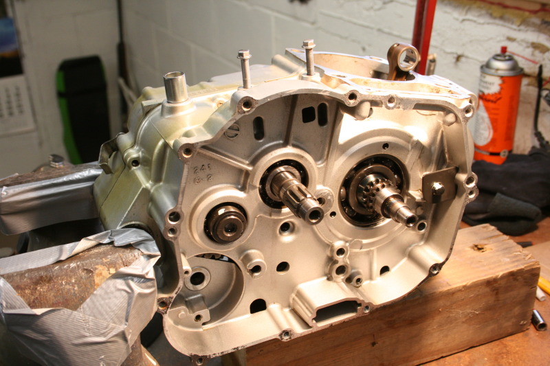

You have a good point about the the starter gear train being able to run backwards. It will spin backwards but I think the initial hit must have been enough to damage mine. Honestly the hiccup may have nothing to do with the damage in mine. Maybe the damage was from simply starting the bike. The idler gear shaft did look like it had some galling on it, maybe it came from the factory like that and slowly ate its way through the bushings. I don't know why the hiccuping would blow both bushings out the same way. If you did want to look at the other side of your idler gear, the flywheel is not too bad to pull. I used some locking chain pliers and the rear axle ( pics a page or two back)
I'm cleaning up some of the parts and my work area and then plan on splitting the case later today. just stopped to eat some lunch and check on the Bears game

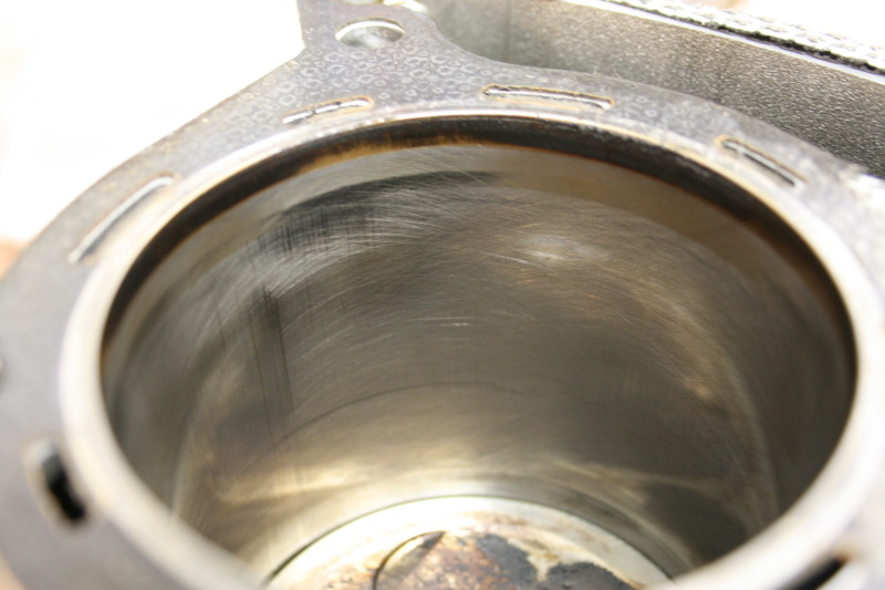

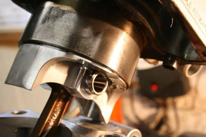

Left the piston in the cylinder, pulled the circlip and slid out the wrist pin.
cylinder from underside

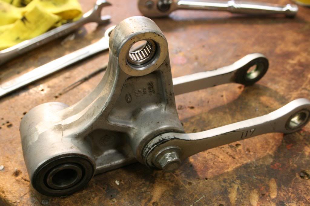

Everything cleaned up well.

Alfred E , admit it, leaving the piston in the cylinder is a really smart move. Way better to be "playing" with the wrist pin vs having to deal with the rings.
Dan's not lazy, he's schmart! IMHO

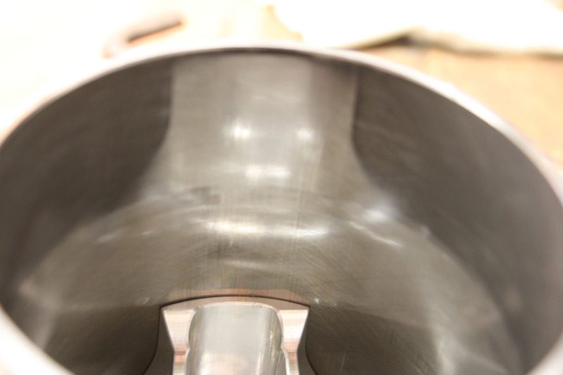

Geez TNC, nothing to do today but Kick a guy when he's down??? Leaving the piston in is my brilliant? solution to a piston ring question I had.
I wasn't sure how to treat the piston rings. Searching online some say re-use them, others say if you have it apart put new ones in, still others say if you put new ones in you need to re hone the cylinder to get a fresh crosshatch in order to seat the new rings. I'm sure everyone on here will have varied opinions too. To sidestep ALL of that, I simply pulled the circlip and removed the wristpin, and left the piston in the cylinder. I do plan on springing for a new circlip for the wristpin.

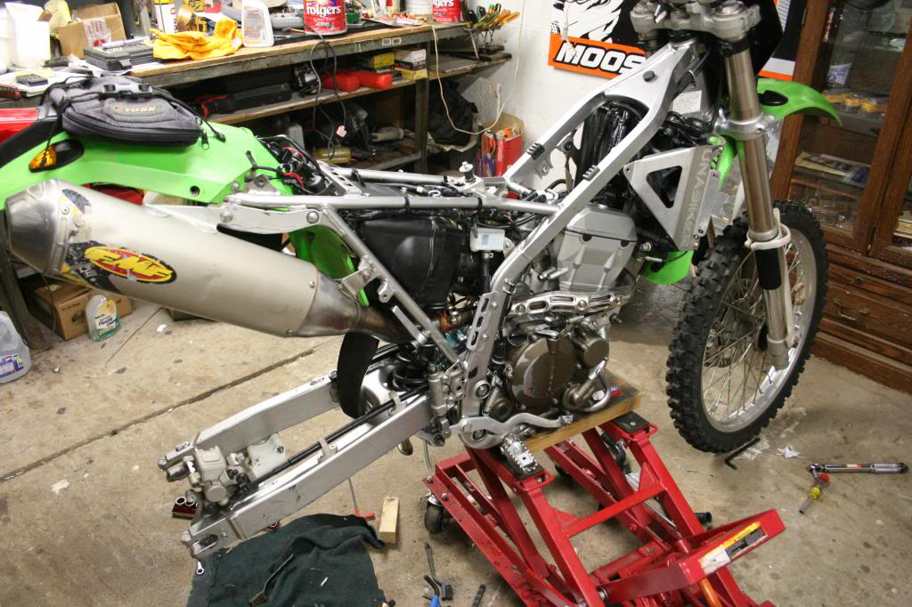

She's a runner......so far I still have some other maintenance type things I want to do to the bike before it warms up, but I couldn't wait to see if it would start. Got the engine buttoned up last weekend and it was sitting in the bike with everything hooked up. Just needed fluids in and the battery hooked up. I cranked it over without gas to try and distribute some oil before actually starting it. Put some gas in and it started right up. What a relief! Running is one thing but moving is another. I had the transmission out and had swapped out some of the trans parts with a used trans I got off eBay. I put the rear wheel and chain on and went for a ride. Everything seems to be working fine. I hope it stays that way. . I may add another thread that will be easily searchable at some point and put some more pics up on it. Thanks, for all the help.

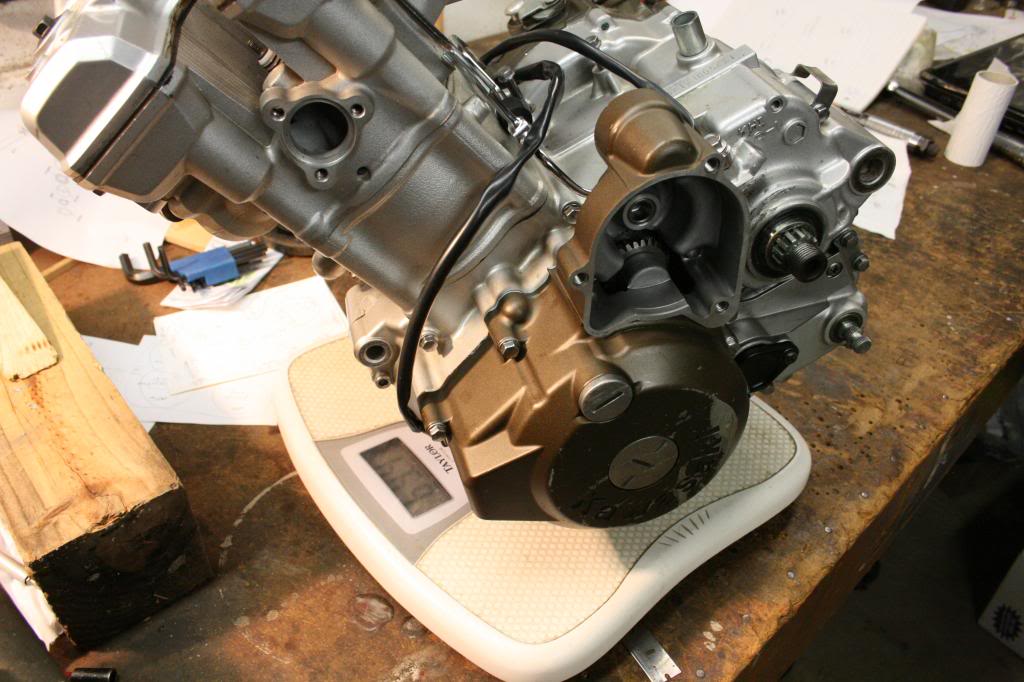

Weighed the engine out of the bike ( no fluids and no starter motor(which is pretty heavy)) 69.4 pounds.

threw the tank and seat on for a quick ride around the neighborhood.
