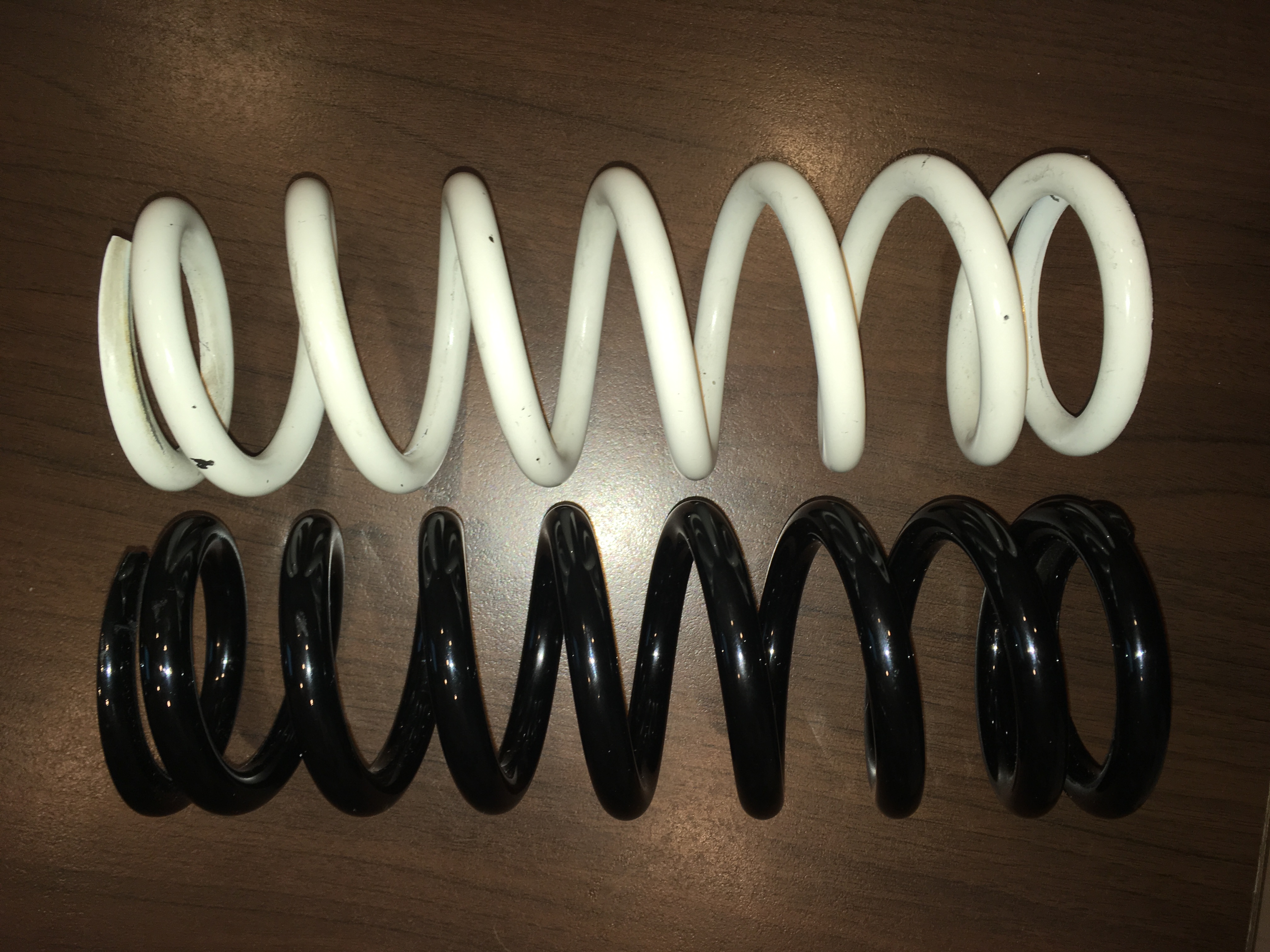

if you can't find anything off the shelf, I bought my springs from Bruce's Suspension. For my weight (about 250) plus all the gear I ride with, I ended up with a 7.2 rear spring. He mentioned it should actually be a larger spring but there would have been clearance issues. Though managed to set my sag perfect with just me and the riding gear on my person.
He's really easy to talk with and full of knowledge if you wanna talk suspension with him. I think it might cost more than an off the shelf Racetech spring, but to have something made perfectly for your weight (and with choice of color!) I'll happily pay that.

I'm about your weight & this spring was perfect for me!

John at Moto-pro posted them to Thailand for me. Good service about $100 + postage for the 7.4kg/mm rear spring.
motoprosuspension
Don't forget heavy duty fork springs, they are super soft on the stock bike & make an incredible difference for hard motard street riding!
.52kg/mm Moto-pro fork springs. About $120 for the pair
