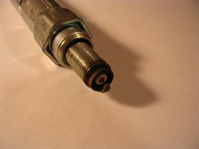

After my ride report many of you suggested checking my plug to see if the bike was still lean. Here's a shot of the plug, what do you guys think?

Can you take another shot? Kinda shaded for me at that angle.
Was this after a wot run?

Scratch the reading of the plug. In my ride report yesterday I said it felt like I was running out of gas when I was nearly home. Tonight I filled up and only used .98 gallons yielding 62mpg with a 130 main jet. On the way home I repeatedly did slow roll ons and in first through fourth just shy of 3/4 throttle it would start to hesitate and pick up again. If I slowly rolled into it even more it would actually cut out.
For those of you that suggested that it was still lean even with a 130 main, you get the golden carburetor award for the day. I put the airbox lid back on when I got home and took another ride and it was much better, no hesitation, and no surging anywhere in the throttle range. If I was to keep the lid off I think I'd have to mess with the needle position as it seems its just before 3/4 throttle that it leans out too much. For now I have some scrap plastic that I'll make a new airbox lid out of and tune the opening size with that before I touch the stock lid and butcher it.
