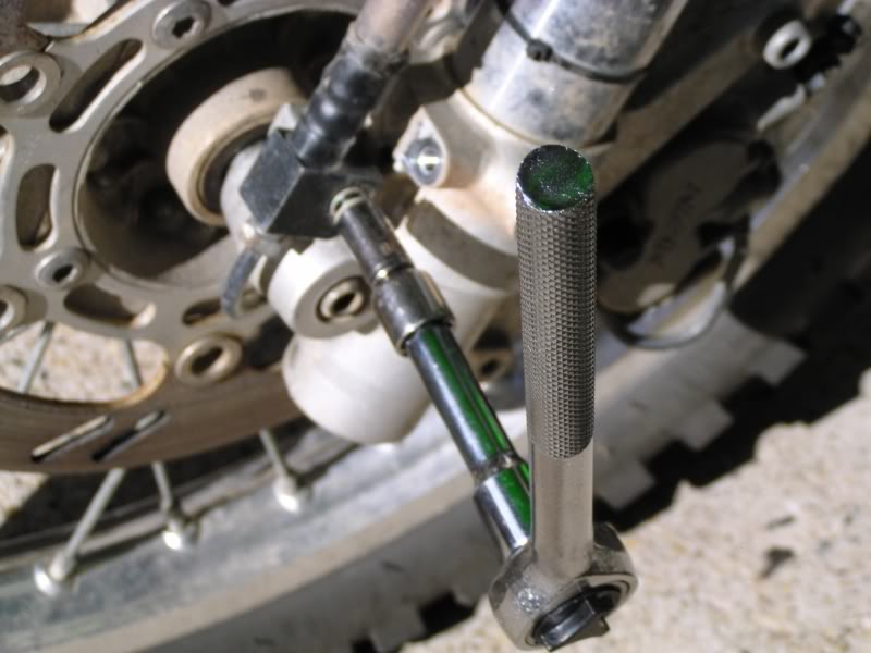

Dunno, mine is hanging on the wire fence. Is this the one you mean?
I'm sure mine wasn't loose before I removed it

Yep that's the part. But if you look you can see your bolt has a small gap before the block. Mine does too, which is where I am not sure if a washer ran away somewhere or if it is supposed to have some lateral play in it.

The bolt is supposed to have that free play, which lets the caliper "float" as well as it can with that hard pipe design they chose for the brake line.

Mine has a gap cause I was undoing it, that's why the spanner is on it. That pic was part of my replace the brake lines with Stainless Steel lines post, it certainly was not loose before I undid it
