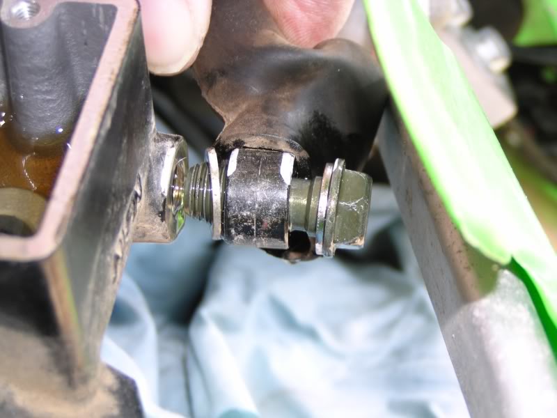

Removed the white fork guard and the bolt holding the junction of the brake line
