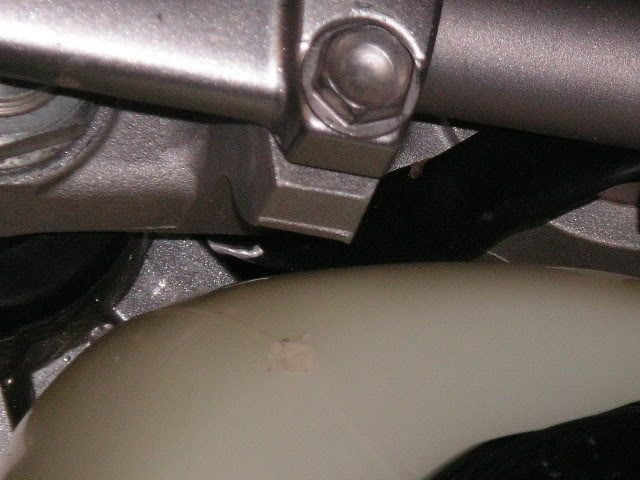

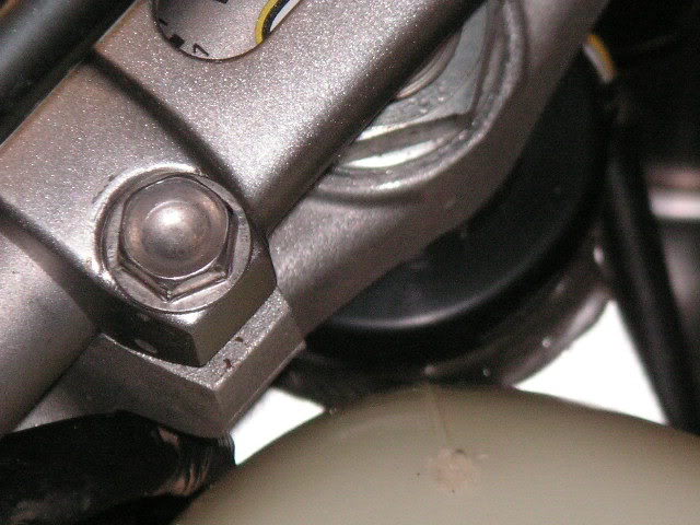

Old Jun 29, 2008 | 10:31 AM
neilaction's Avatar
Posts: 1,985
Default RE: Question for the Clarke owners
Nope, all clear both sides.
RHS full lock
LHS full lock
Old Jun 29, 2008 | 08:55 PM
marc11's Avatar
Joined: Nov 2006
Posts: 326
Mine hits on both side. Just a tiny bit, but I have two little dents on each side of the tank. I am going to try and pull it back some.
Old Jun 30, 2008 | 12:20 AM
neilaction's Avatar
Posts: 1,985
ORIGINAL: marc11
I would be concerned if I had any contact at all.
If it's touching when the bike is stationary, it could have consequences in a crash.
It is very odd that every ones install seems so different.
