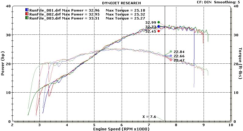

Do you have any dyno sheets?
I would be interested to see what rpm your motor makes max HP and torque at?
Here are a few of my sheets from my dyno run. I have a BB351cc, web 101 cam, ported & polished, FMF powerbomb, 2Bro silencer, BB34mm carb, and kdx snorkle.

Nice Will, a solid 33 hp, that head work was worth it. especially considering it started at 18 hp or so.
Hey, d0gg .... post up your dyno if you can.
