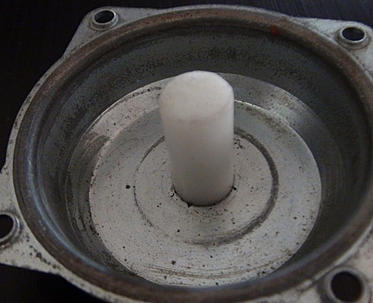

Some additional thoughts on obtaining quicker throttle response:
If you were to add something like round Delrin rod to the top center of the carb cap; pointing down through the center of the spring, it would reduce the volume above the slide. Reduced volume should let the slide react faster as its upper cavity "empties out" quicker therefore letting atmospheric pressure push the underside up faster.
That pronged spring locater inside the carb cap is just held in by a rivet in the center. I'd already added Delrin rod to mine, but then opted for the 36mm and haven't really done any more work on the 34.
Something like this would reduce the volume in the upper chamber; meaning less air for vacuum to suck out - helping to achieve quicker throttle response.
Maybe trimmed along it's sides slightly to allow free return spring movement
I did it to the 4 CV carbs on my GS1150 15 years ago and it did help low end power/throttle response enough that I had to go one step leaner with the pilot jets.

We're talking about throttle response, so taking an extreme example - if the volume were reduced to say 10% of what's inside the slide now, the slide would have to be drawn (pushed) up quicker because the required amount of air pressure differential required to initiate slide movement is achieved faster as air that had been above the slide diaphragm has been drawn out quicker via your fixed rate, while atmospheric pressure coming in the carb's bell port is pushing up on the underside of the slide's rubber diaphragm.
If the rate of evacuation is fixed, then a reduction in volume would still increase throttle response. Looking at the idea from the other direction: if you connected a 1/2" ID diameter hose to the carb lid, and that was connected to a sealed 5 gallon container, I'd bet you would see throttle response is now much slower as the volume is now so much larger.
The slide wouldn't be stuck at the top at WOT because vacuum strength would diminish to almost nothing once the butterfly was closed, and the spring would force it back down. If the only thing changed was the volume then normal carb function wouldn't be impaired.
Spring rate, fixed rate, air bleed, engine vacuum etc all remaining the same-reducing volume would have to lead to a quicker throttle response. Atmospheric pressure is always waiting to fill the space evacuated of air.
Upper slide volume in cc div by fixed rate of evacuation (ccpm) = rate of slide rise. Ipso facto
No sense going back and forth over it and hijacking this thread. Keep in mind that I did this mod to the 4 carbs on my GS1150 and it would light the tire from a slow roll punch easier than before I did it. - Results once again overriding theory.

I think it'd be near impossible to dyno the difference, because the gain to be had maybe from low throttle openings. Though a controlled bench test with vacuum applied and slide rise timed, might show the slight difference.
The benefits are probably more pronounced on a 1150cc 4 cylinder than on a single cylinder.
The Delrin should be shaped/ground so as to create as little drag in the spring as possible while it's compressing yet still hoping to add as much Delrin to reduce volume.
