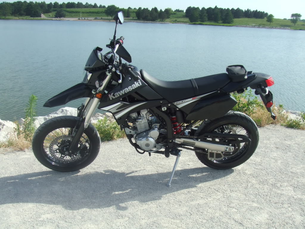

KLX250SF New and still Clean

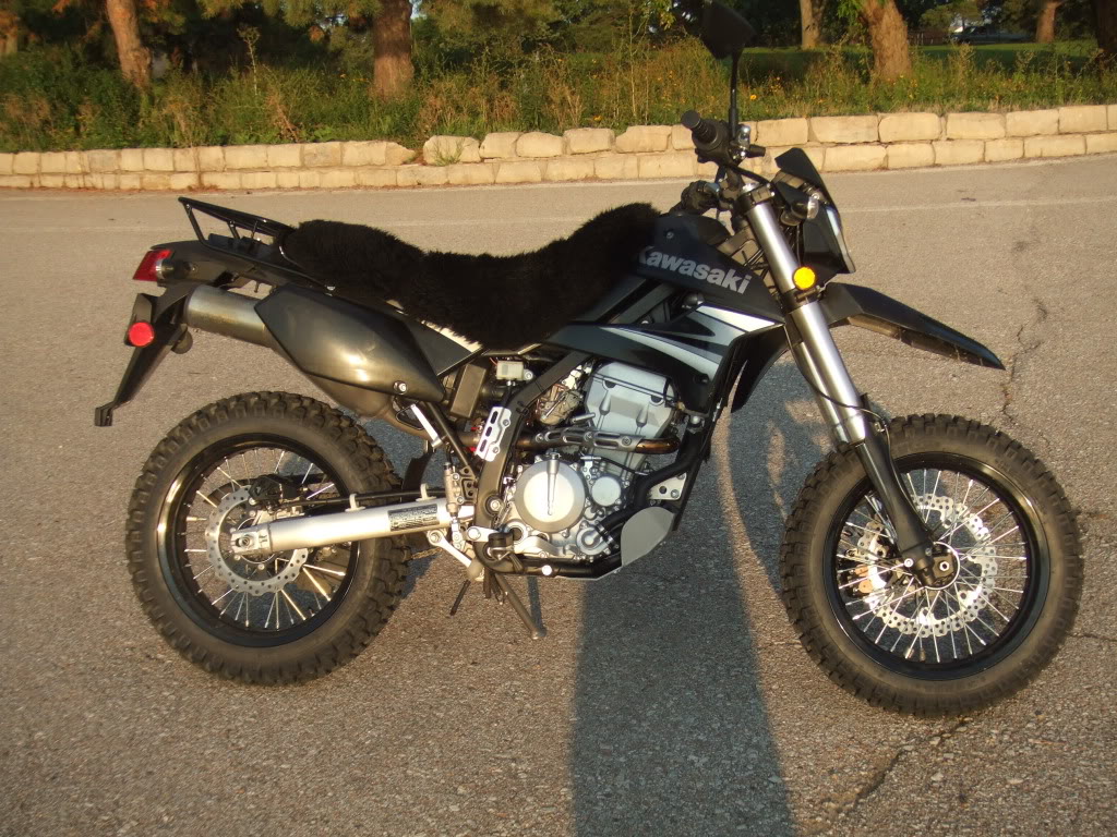

KLX250SF with Sheepskin cover, Borrego Rack, Skid Plate and Kenda K270 Tires on
Supermoto rims (Rear 150/70-17, Front 120/70-17). I am new to riding on knobby tires, but I don’t really like riding on pavement with these tires in comparison to my original tires. I definitely don’t lean as much into a turn with the knobby tires. Also with the larger front tire the bike steers like a tug boat on pavement, may not be so bad off road on the looser material. However perhaps I should loosen the rear shock a few clicks like the 250S version to decrease the rake on the front fork. I’d be interested in anyone’s thoughts on these issues.

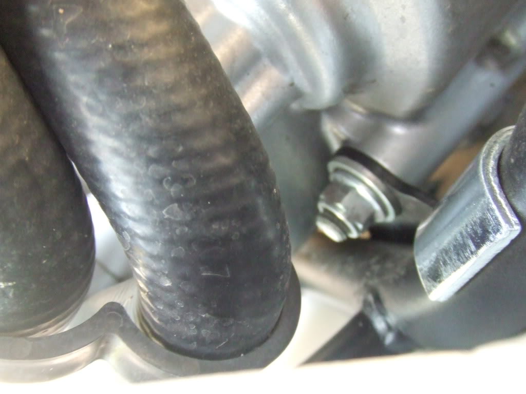

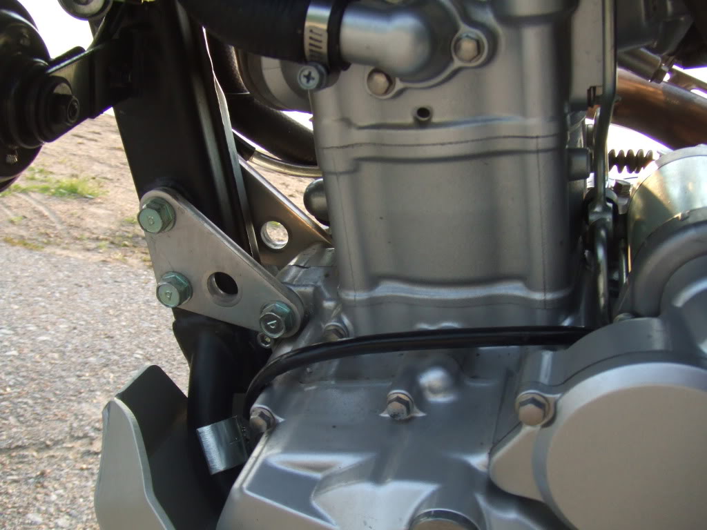

Although not shown there is a hole at the bottom of the engine in between the bolt and the radiator hose on the photo below. I don’t have a photo of the hole because my skid plate is an obstruction (I noticed the hole when putting on the plate. Does anyone know what that hole is?
What is that hole under where Radiator Hose goes into the engine?
I hope you plan to take that sheepskin cover off before you take it off road.
The knobbies will be less confidence inspiring on pavement due to the "squishiness" of the tread blocks.
It steers like a truck now because of that and because of the larger tires. The rear is also contributing to the slower steering. If you want it to steer faster you need to raise the forks in the triple clamps. Start with 10mm and see what happens. If the bike feels nervous or doesn't track well then try 5mm, etc.
That hole is a drain hole. It's purpose is to allow coolant to drain in case of a water pump seal failure so that coolant doesn't end up in the crankcase. I think it may also allow oil to drain out if the oil seal on the other side fails.
Dan
That's another drain hole. It's there to allow drainage from the spark plug well in the top of the head. If water gets in there that hole allows it to drain out so that you don't end up with an ignition misfire. That hole also allows oil to drain out if the valve cover gasket leaks and oil gets down in there.
