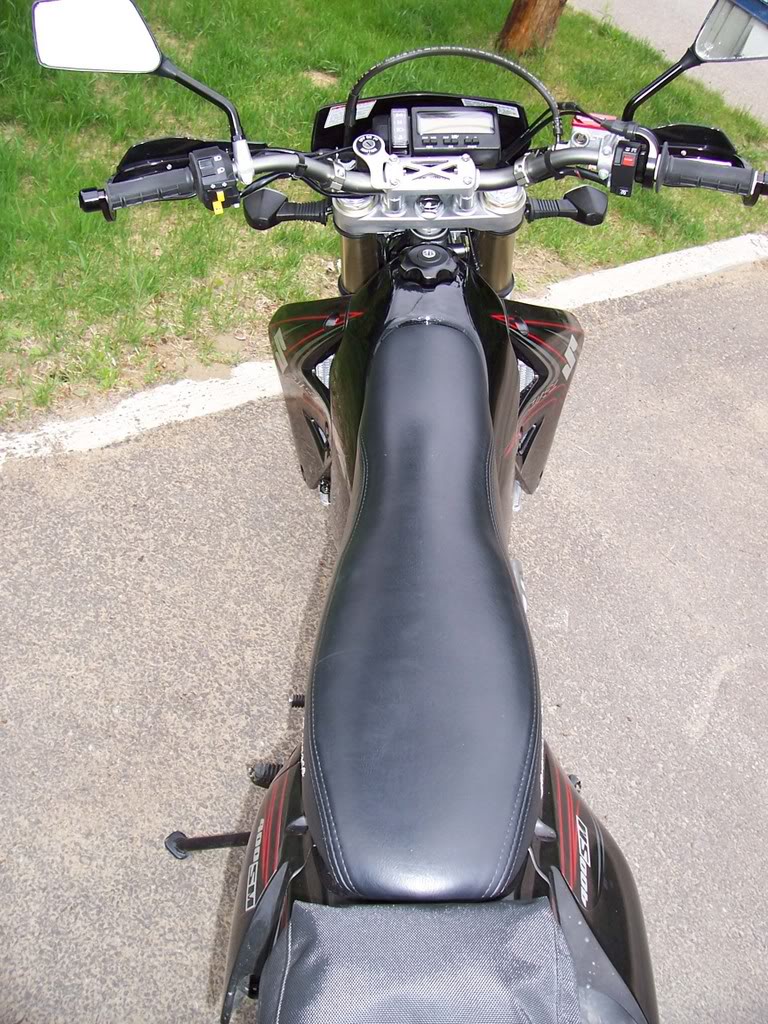

I also have the KLX250SF and I want to occasionally take it off road, or at a minimum have
better traction on gravel roads. Since I don't want to spend $900 to $1000 on a new set of
dual sport rims and tires (not this year anyway), I looked around to see what possible tires
might fit and work with my existing motard rims. I found the following html links discussing
using offroad tires on a DRZ400SM. Here are the links I came up with. Note this option requires
using rear 17" for both the front and rear on the KLX. This is definitely not the ideal setup for
proper off-roading, but it's better than street tires on loose material.
Link 1: DRZ400SM with Maxxis 6006 Tires (130/80-17) for front and back with the photos shown below.
http://www.thumpertalk.com/forum/arc.../t-514582.html

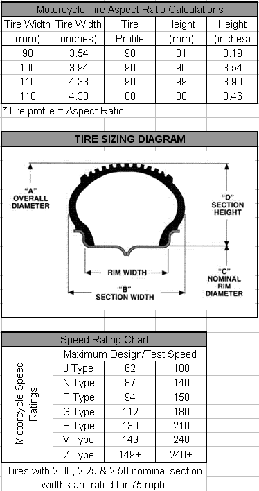

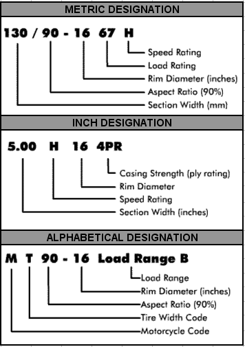

Here are some usefull charts and figures regarding motorcycle tires.

I ordered the Kenda 270's and I will let you know how it works. Note the 270's are supposedly a 50/50 tire which is what I was looking for. I wanted something with more bite than the Avon Distanzia's could provide.
