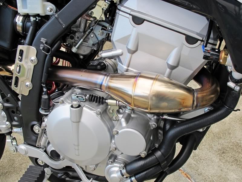

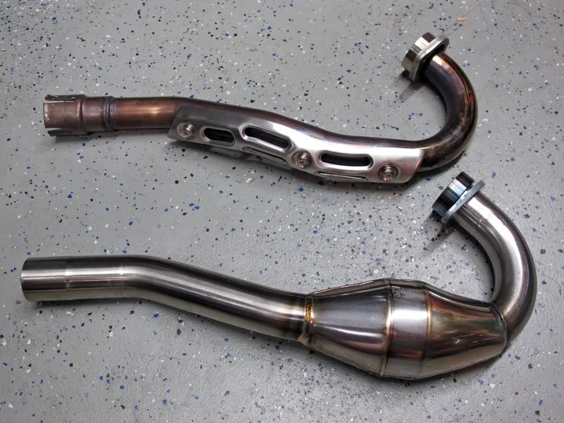

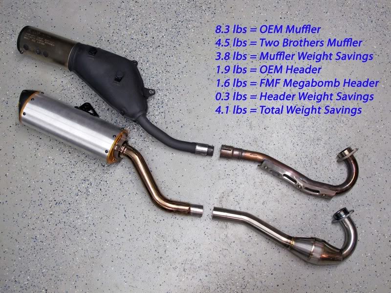

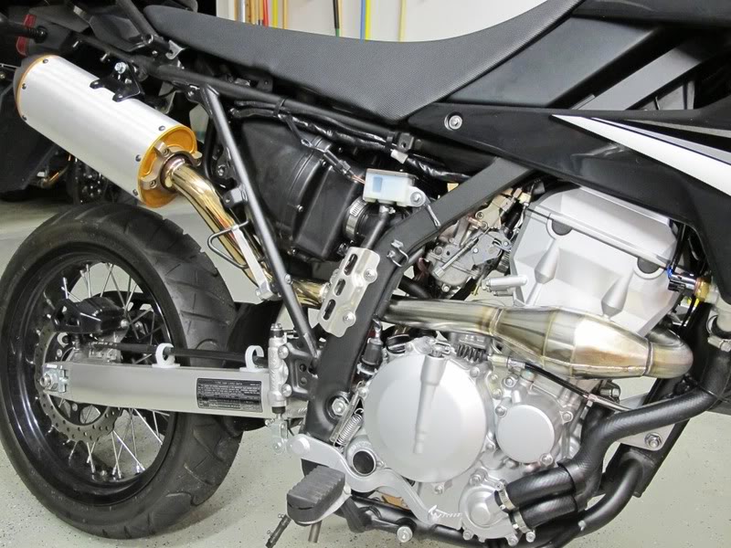

Found some good discussion of Megabomb installation (FMF brand) on supermotojunkie today:
Un-corking the KLX250SF
Pics below in case of link rot:

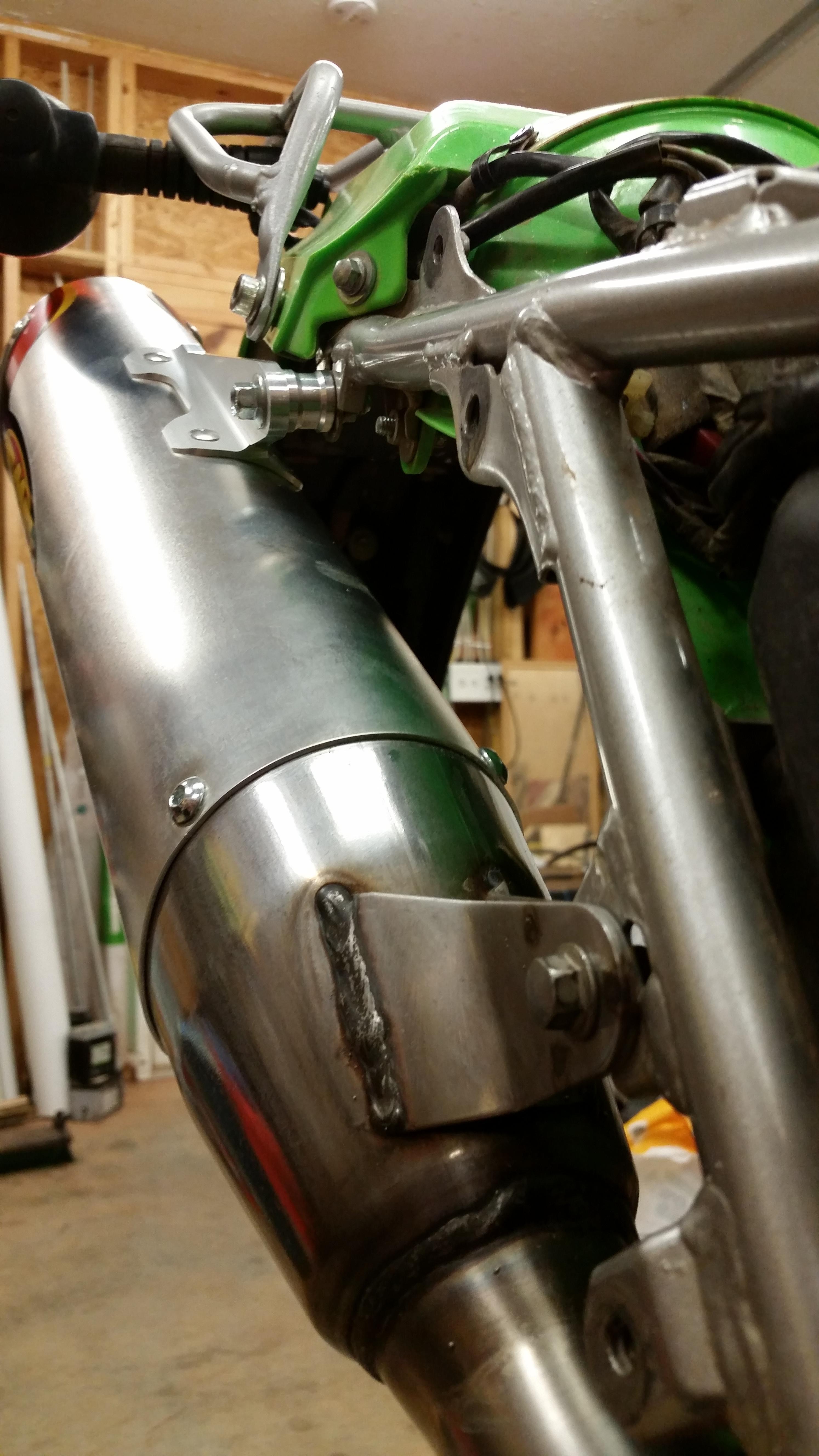

What most people fail to consider is that the OE muffler is a structural member of the tail section. Looking at the top pic you can see the OE muffler has three mounting points. This triangulates the right side. If you plan on carrying loads on the tail section stay OE.

Or bolt a gusset on

There was a thread on making a gusset but I couldn't find it. Not sure if one could be bought.

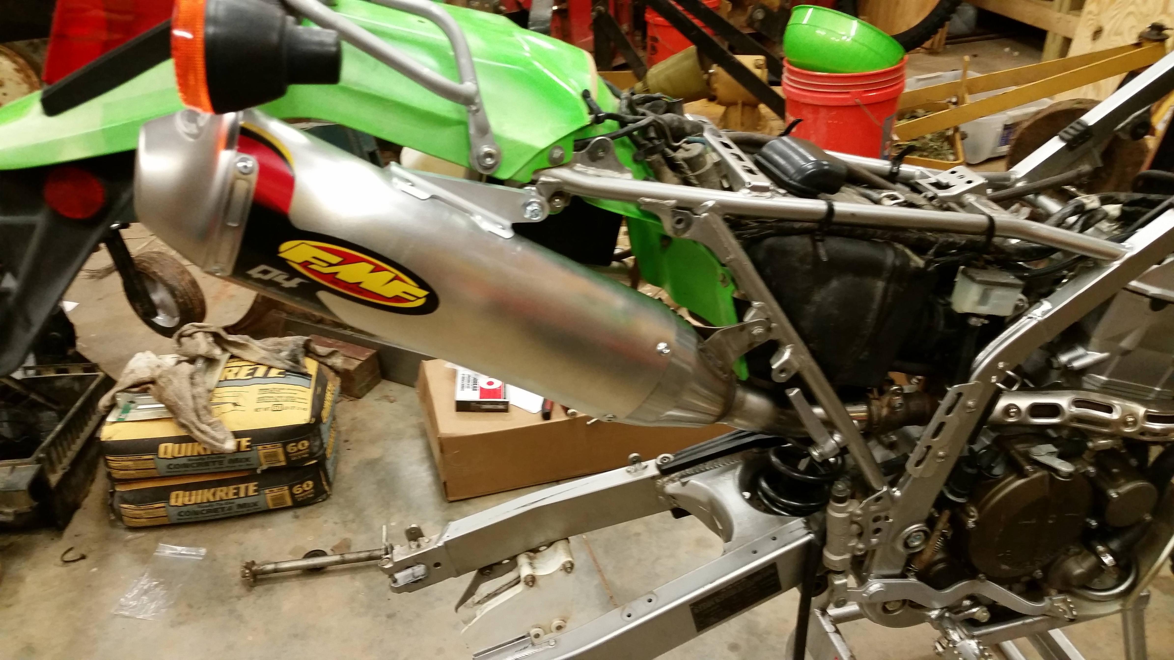

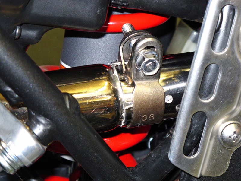

Found a little time to install the 2006 edition FMF Q4 (p/n
042156 042156
) on my 2007 KLX250s tonight. The short story is it fits perfectly.
Here is the full album: Imgur: The most awesome images on the Internet
Some select pics below:

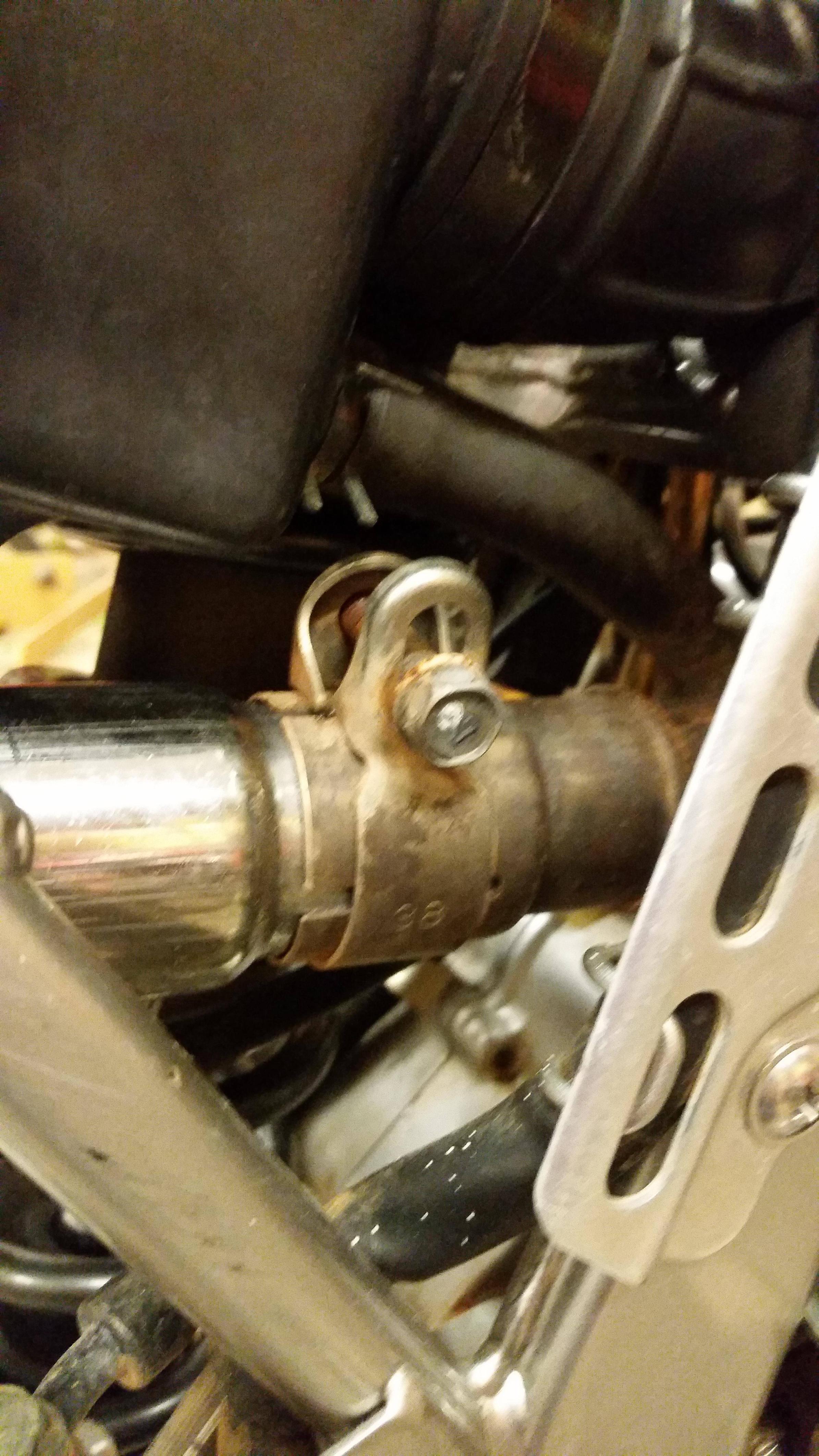

Q4 042156 fit snugly in the stock header (no reducer needed)

Here's the Q4 mounted up:

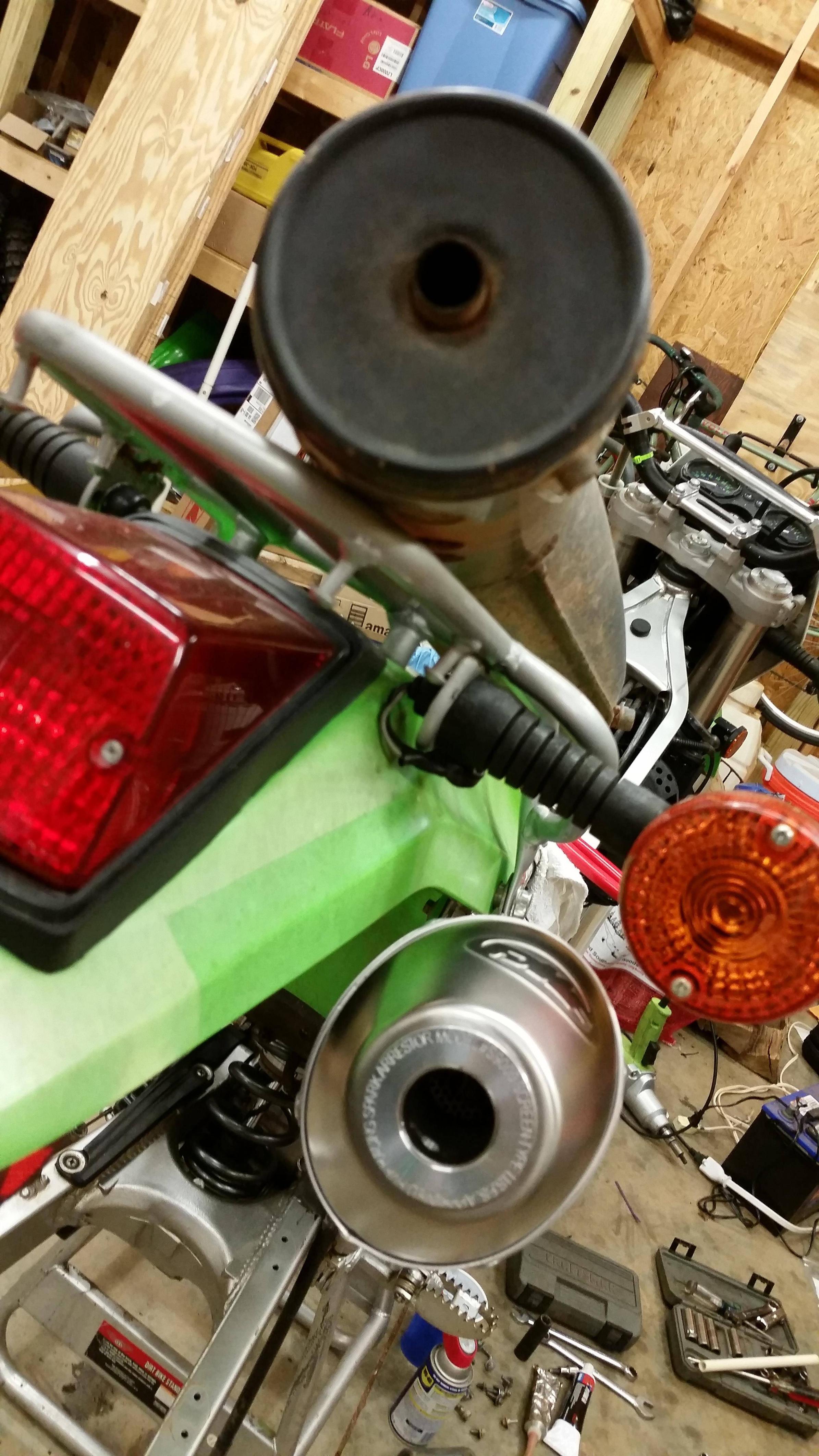

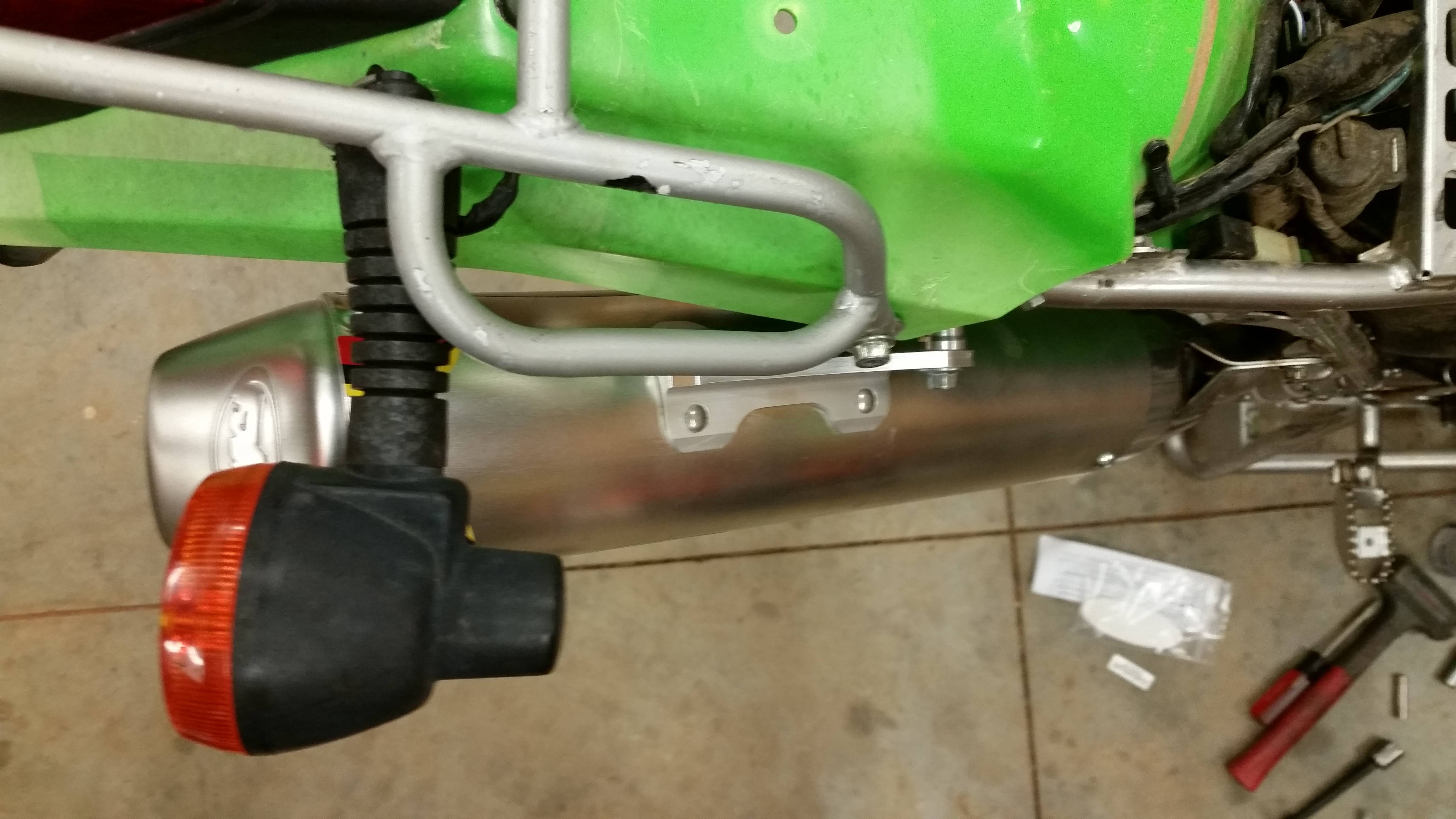

Top view (no turn signal melting problem here)

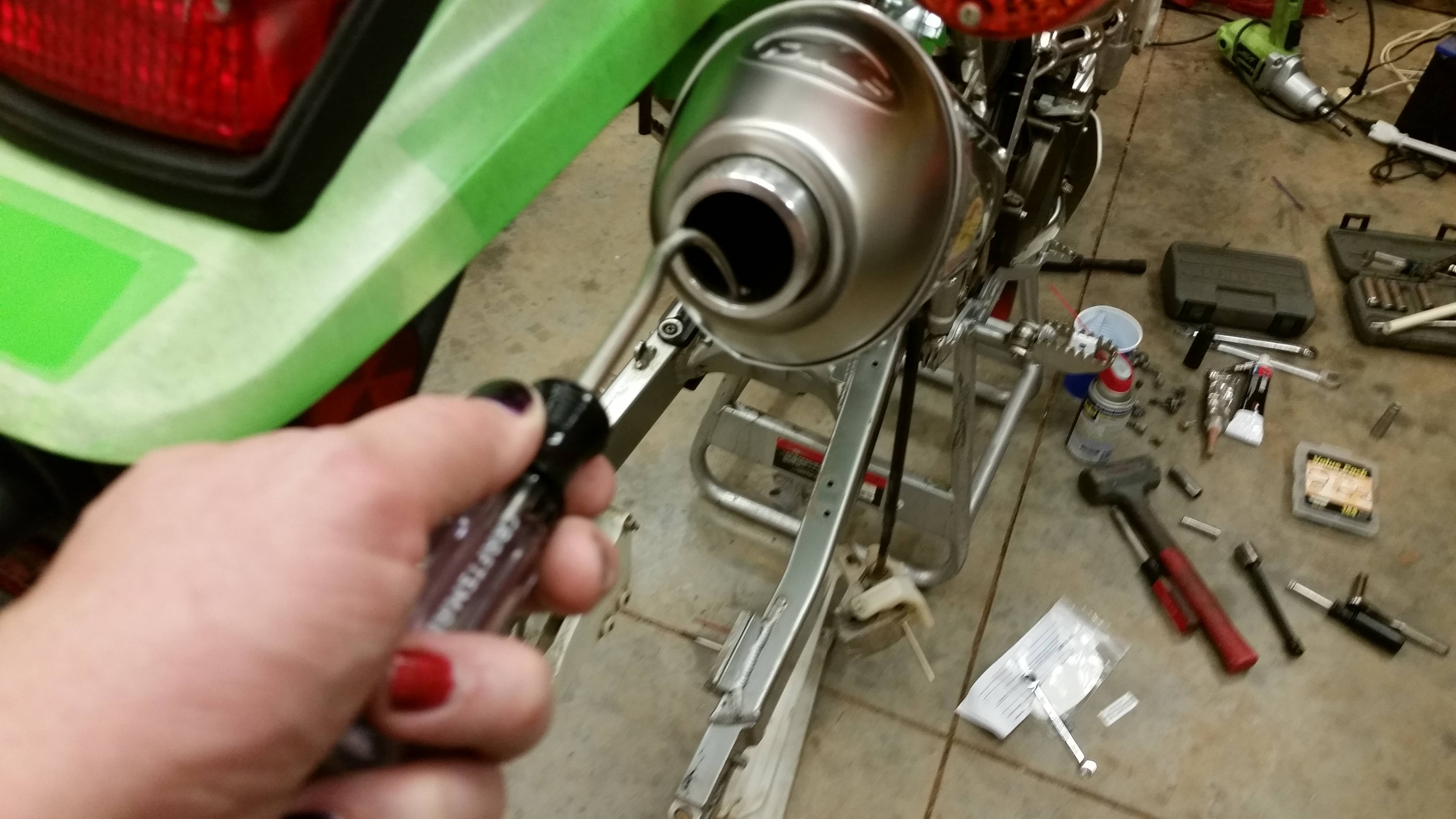

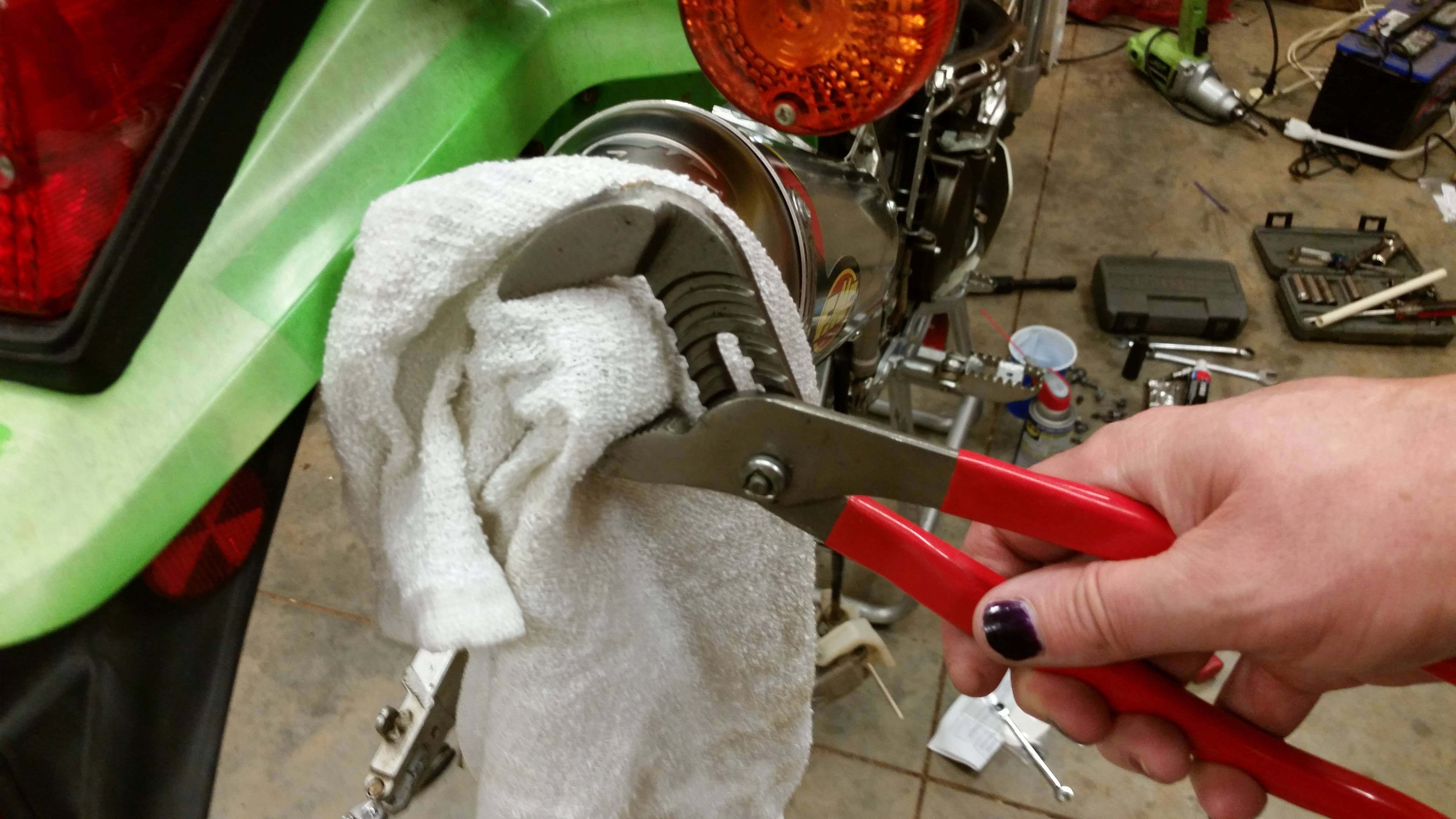

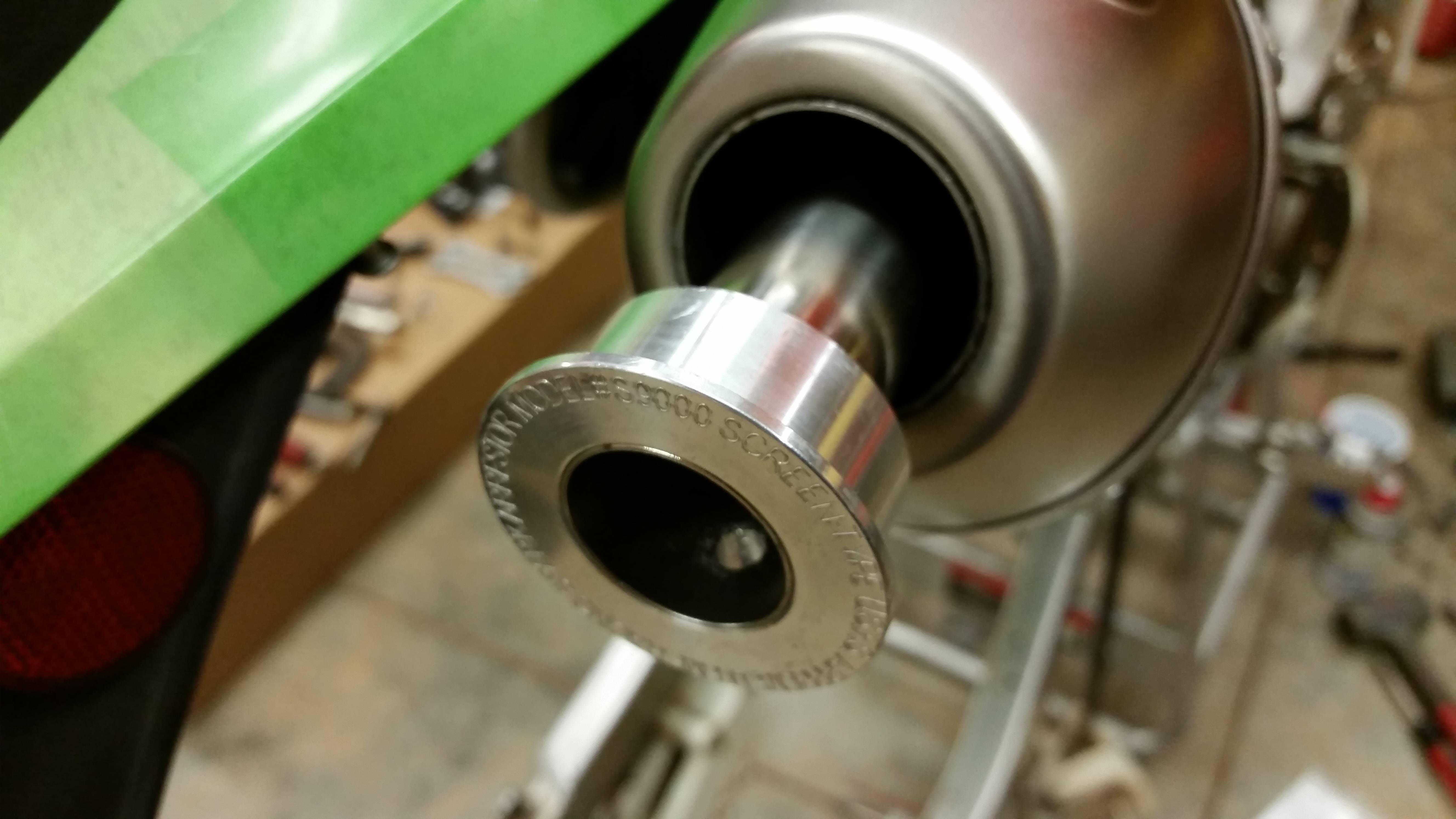

Also picked up the 1 1/8" quiet core. I live in a suburban area and don't want to **** off the neighbors (and want to keep my urban riding areas accessible).
I used a hose pick to help slide the provided core out of the muffler body (it was a snug fit).
Had to use channel locks and a towel to finish removing the larger core:

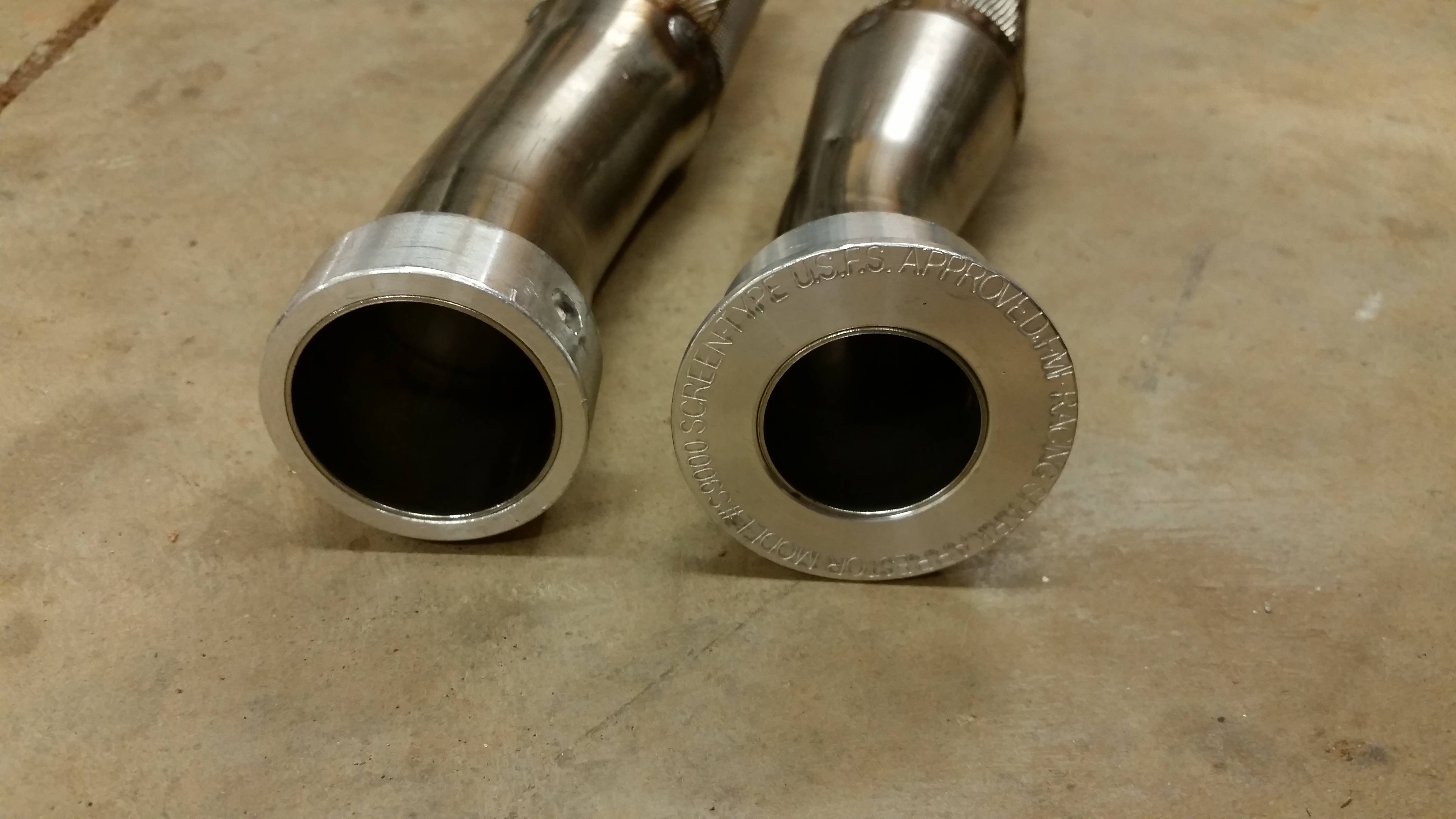

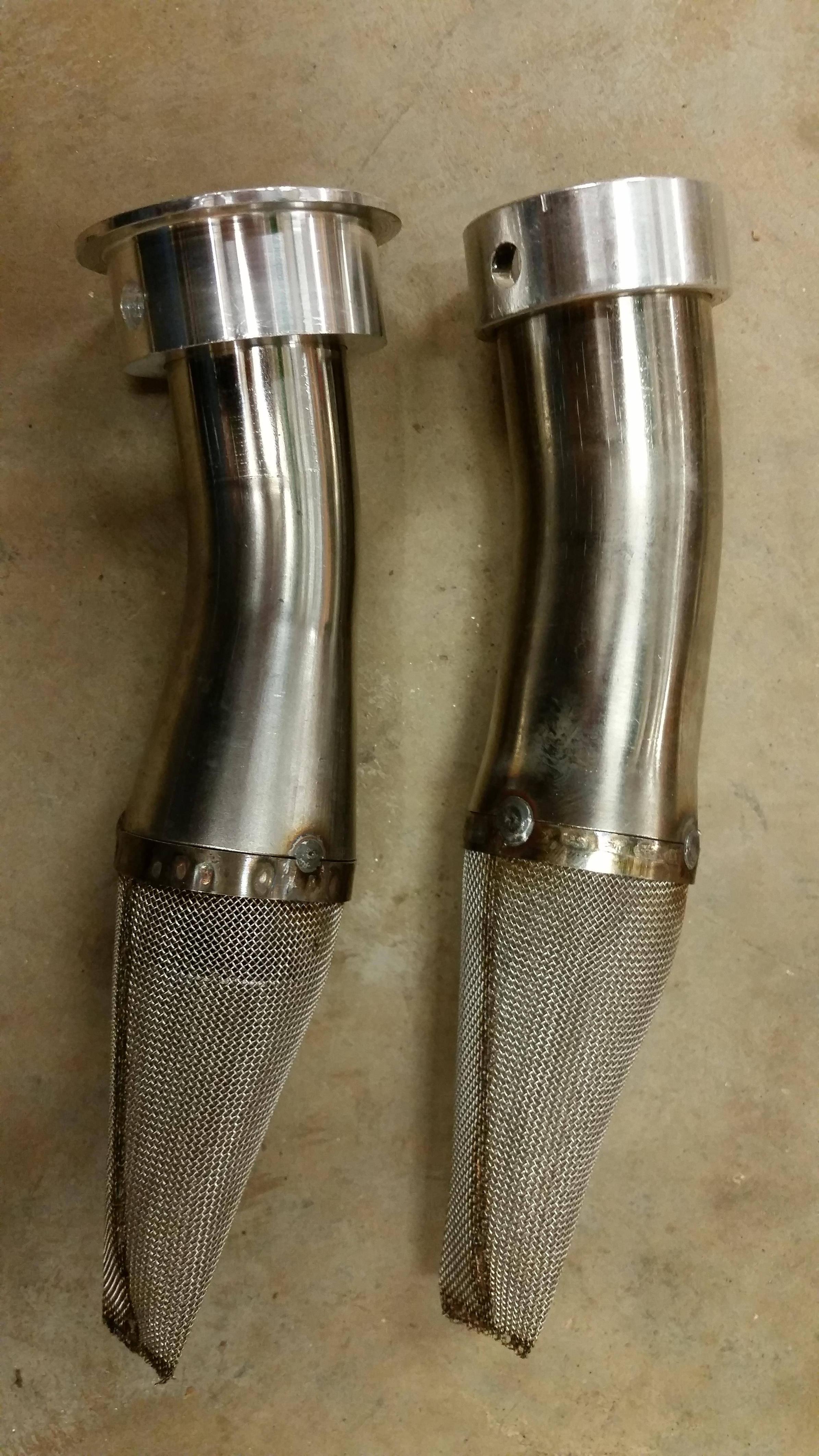

Regular and quiet (1 1/8") cores, side by side:
Significant difference in output size:

Even though the 1 1/8" quiet core is noticeable smaller than the standard core, it is still much larger than the OEM muffler:
