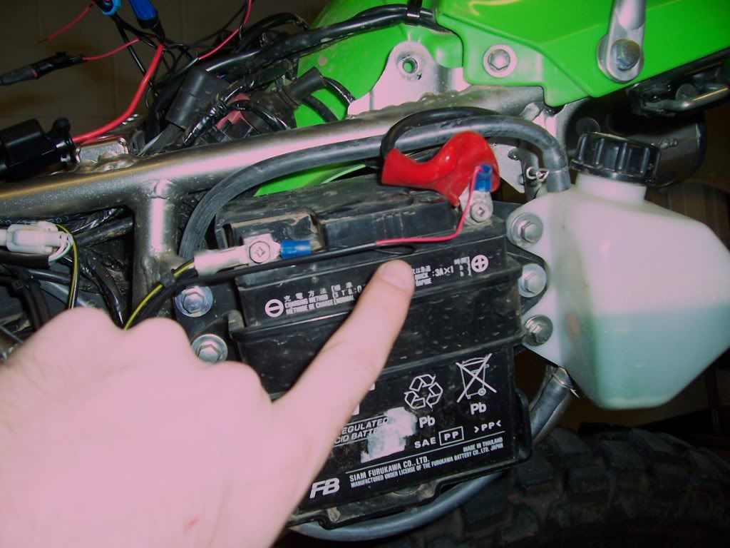

Battery connection: A fuse is hooked up directly to the wire coming from the battery.

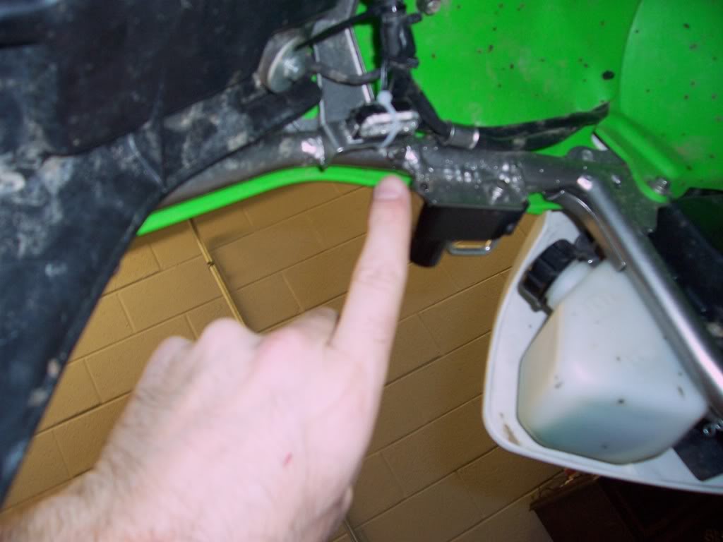

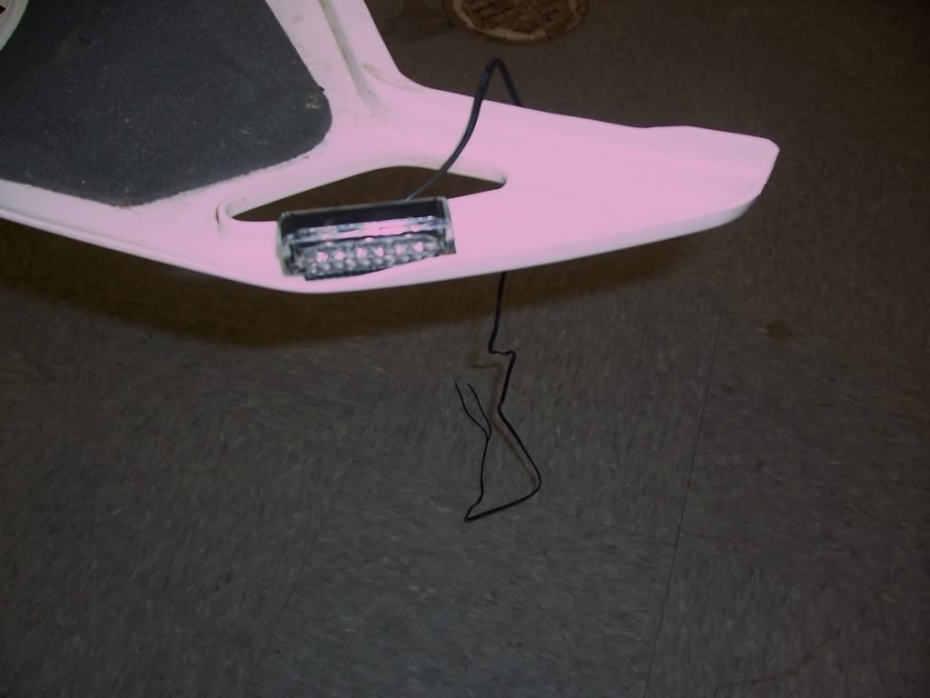

Here are the Mega TNT Sticks connected to the shroud, side panel and two smaller TNT Sticks connected to the frane under the rear fender. The custom shop uses double sided tape to mount the LED's but I used 'super hold' velcro to remove the LED's easily. On the frame I also added a small clear ziptie to further secure the TNT Sticks. All the sticks are very secure.
I took care and used shrink tubing on some of the connections. I used the natural wire routing that Kawasaki used to wire the bike originally. The LED's are water proof and will work even if they are fully submerged in water so bring on the stream crossings.
